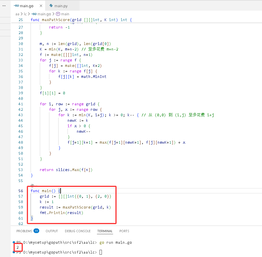

Go完整代码如下:
package main
import (
	"fmt"
	"math"
	"slices"
// 64. 最小路径和
func minPathSum(grid [][]int) int {
	n := len(grid[0])
	f := make([]int, n+1)
	for j := range f {
		f[j] = math.MaxInt
	f[1] = 0
	for _, row := range grid {
		for j, x := range row {
			f[j+1] = min(f[j], f[j+1]) + min(x, 1) // 值大于 0 的单元格花费 1
	return f[n]
func maxPathScore(grid [][]int, K int) int {
	if minPathSum(grid) > K {
		return -1
	m, n := len(grid), len(grid[0])
	K = min(K, m+n-2) // 至多花费 m+n-2
	f := make([][]int, n+1)
	for j := range f {
		f[j] = make([]int, K+2)
		for k := range f[j] {
			f[j][k] = math.MinInt
	f[1][1] = 0
	for i, row := range grid {
			for k := min(K, i+j); k >= 0; k-- { // 从 (0,0) 到 (i,j) 至多花费 i+j
				newK := k
				if x > 0 {
					newK--
				f[j+1][k+1] = max(f[j+1][newK+1], f[j][newK+1]) + x
	return slices.Max(f[n])
func main() {
	grid := [][]int{{0, 1}, {2, 0}}
	k := 1
	result := maxPathScore(grid, k)
	fmt.Println(result)

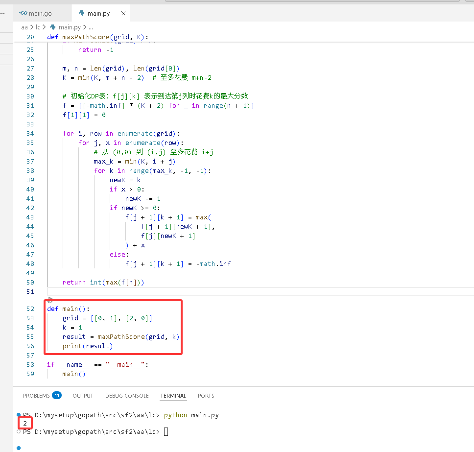

Python完整代码如下:
# -*-coding:utf-8-*-
import math
def minPathSum(grid):
    64. 最小路径和
    计算从左上角到右下角的最小路径和(值大于0的单元格花费1)
    n = len(grid[0])
    f = [math.inf] * (n + 1)
    f[1] = 0
    for row in grid:
        for j, x in enumerate(row):
            f[j + 1] = min(f[j], f[j + 1]) + min(x, 1)
    return int(f[n])
def maxPathScore(grid, K):
    计算最大路径分数
    if minPathSum(grid) > K:
        return -1
    m, n = len(grid), len(grid[0])
    K = min(K, m + n - 2)  # 至多花费 m+n-2
    # 初始化DP表:f[j][k] 表示到达第j列时花费k的最大分数
    f = [[-math.inf] * (K + 2) for _ in range(n + 1)]
    f[1][1] = 0
    for i, row in enumerate(grid):
            # 从 (0,0) 到 (i,j) 至多花费 i+j
            max_k = min(K, i + j)
            for k in range(max_k, -1, -1):
                newK = k
                if x > 0:
                    newK -= 1
                if newK >= 0:
                    f[j + 1][k + 1] = max(
                        f[j + 1][newK + 1],
                        f[j][newK + 1]
                    ) + x
                else:
                    f[j + 1][k + 1] = -math.inf
    return int(max(f[n]))
def main():
    grid = [[0, 1], [2, 0]]
    k = 1
    result = maxPathScore(grid, k)
    print(result)
if __name__ == "__main__":
    main()

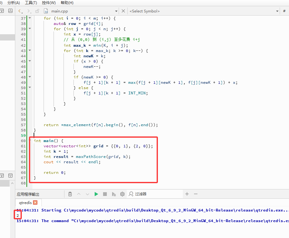

C++完整代码如下:
#include <iostream>
#include <vector>
#include <algorithm>
#include <climits>
using namespace std;
// 64. 最小路径和
int minPathSum(vector<vector<int>>& grid) {
    int n = grid[0].size();
    vector<int> f(n + 1, INT_MAX);
    f[1] = 0;
    for (auto& row : grid) {
        for (int j = 0; j < n; j++) {
            int x = row[j];
            f[j + 1] = min(f[j], f[j + 1]) + min(x, 1); // 值大于 0 的单元格花费 1
    return f[n];
int maxPathScore(vector<vector<int>>& grid, int K) {
    if (minPathSum(grid) > K) {
        return -1;
    int m = grid.size();
    K = min(K, m + n - 2); // 至多花费 m+n-2
    // 初始化DP表:f[j][k] 表示到达第j列时花费k的最大分数
    vector<vector<int>> f(n + 1, vector<int>(K + 2, INT_MIN));
    f[1][1] = 0;
    for (int i = 0; i < m; i++) {
        auto& row = grid[i];
            int x = row[j];
            int max_k = min(K, i + j);
            for (int k = max_k; k >= 0; k--) {
                int newK = k;
                if (x > 0) {
                    newK--;
                if (newK >= 0) {
                    f[j + 1][k + 1] = max(f[j + 1][newK + 1], f[j][newK + 1]) + x;
                } else {
                    f[j + 1][k + 1] = INT_MIN;
    return *max_element(f[n].begin(), f[n].end());
int main() {
    vector<vector<int>> grid = {{0, 1}, {2, 0}};
    int k = 1;
    int result = maxPathScore(grid, k);
    cout << result << endl;
    return 0;
