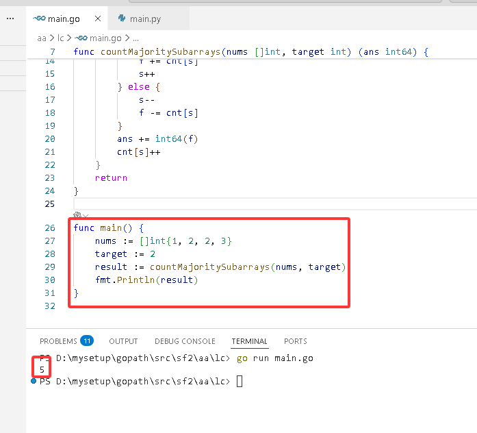

Go完整代码如下:
package main
import (
	"fmt"
func countMajoritySubarrays(nums []int, target int) (ans int64) {
	n := len(nums)
	cnt := make([]int, n*2+1)
	cnt[n] = 1
	s, f := n, 0
	for _, x := range nums {
		if x == target {
			f += cnt[s]
			s++
		} else {
			s--
			f -= cnt[s]
		ans += int64(f)
		cnt[s]++
	return
func main() {
	nums := []int{1, 2, 2, 3}
	target := 2
	result := countMajoritySubarrays(nums, target)
	fmt.Println(result)

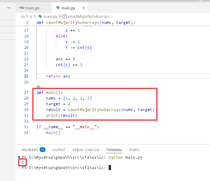

Python完整代码如下:
# -*-coding:utf-8-*-
def countMajoritySubarrays(nums, target):
    n = len(nums)
    # 偏移量 n,避免负数下标
    offset = n
    cnt = [0] * (n * 2 + 1)
    cnt[offset] = 1
    s = offset
    f = 0
    ans = 0
    for x in nums:
        if x == target:
            f += cnt[s]
            s += 1
        else:
            s -= 1
            f -= cnt[s]
        ans += f
        cnt[s] += 1
    return ans
def main():
    nums = [1, 2, 2, 3]
    target = 2
    result = countMajoritySubarrays(nums, target)
    print(result)
if __name__ == "__main__":
    main()

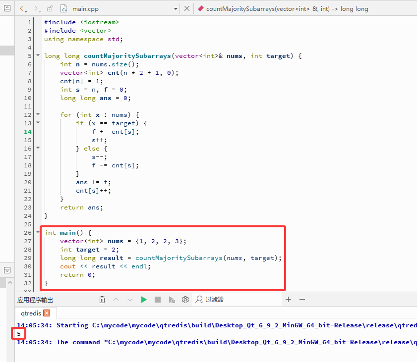

C++完整代码如下:
#include <iostream>
#include <vector>
using namespace std;
long long countMajoritySubarrays(vector<int>& nums, int target) {
    int n = nums.size();
    vector<int> cnt(n * 2 + 1, 0);
    cnt[n] = 1;
    int s = n, f = 0;
    long long ans = 0;
    for (int x : nums) {
        if (x == target) {
            f += cnt[s];
            s++;
        } else {
            s--;
            f -= cnt[s];
        ans += f;
        cnt[s]++;
    return ans;
int main() {
    vector<int> nums = {1, 2, 2, 3};
    int target = 2;
    long long result = countMajoritySubarrays(nums, target);
    cout << result << endl;
    return 0;
