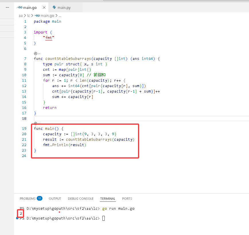

package main
import (
	"fmt"
func countStableSubarrays(capacity []int) (ans int64) {
	type pair struct{ x, s int }
	cnt := map[pair]int{}
	sum := capacity[0] // 前缀和
	for r := 1; r < len(capacity); r++ {
		ans += int64(cnt[pair{capacity[r], sum}])
		cnt[pair{capacity[r-1], capacity[r-1] + sum}]++
		sum += capacity[r]
	return
func main() {
	capacity := []int{9, 3, 3, 3, 9}
	result := countStableSubarrays(capacity)
	fmt.Println(result)

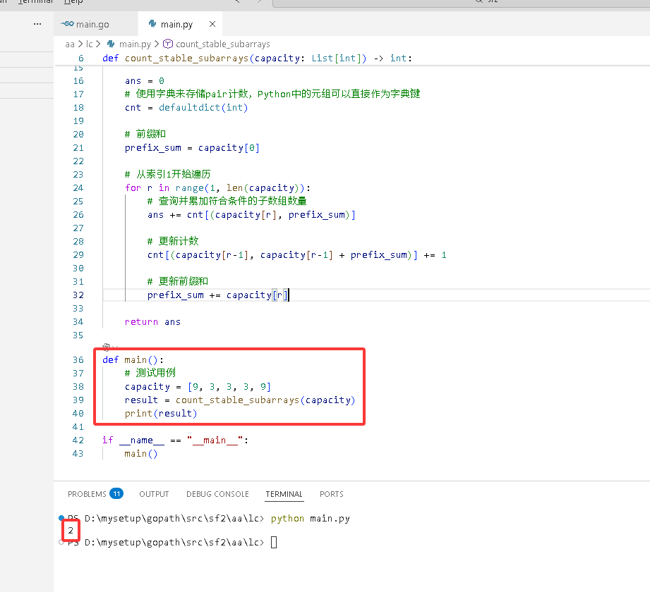

# -*-coding:utf-8-*-
from typing import List
from collections import defaultdict
def count_stable_subarrays(capacity: List[int]) -> int:
    计算稳定子数组的数量
    参数:
        capacity: 整数列表
    返回:
        稳定子数组的数量
    ans = 0
    # 使用字典来存储pair计数,Python中的元组可以直接作为字典键
    cnt = defaultdict(int)
    # 前缀和
    prefix_sum = capacity[0]
    # 从索引1开始遍历
    for r in range(1, len(capacity)):
        # 查询并累加符合条件的子数组数量
        ans += cnt[(capacity[r], prefix_sum)]
        # 更新计数
        cnt[(capacity[r-1], capacity[r-1] + prefix_sum)] += 1
        # 更新前缀和
        prefix_sum += capacity[r]
    return ans
def main():
    # 测试用例
    capacity = [9, 3, 3, 3, 9]
    result = count_stable_subarrays(capacity)
    print(result)
if __name__ == "__main__":
    main()

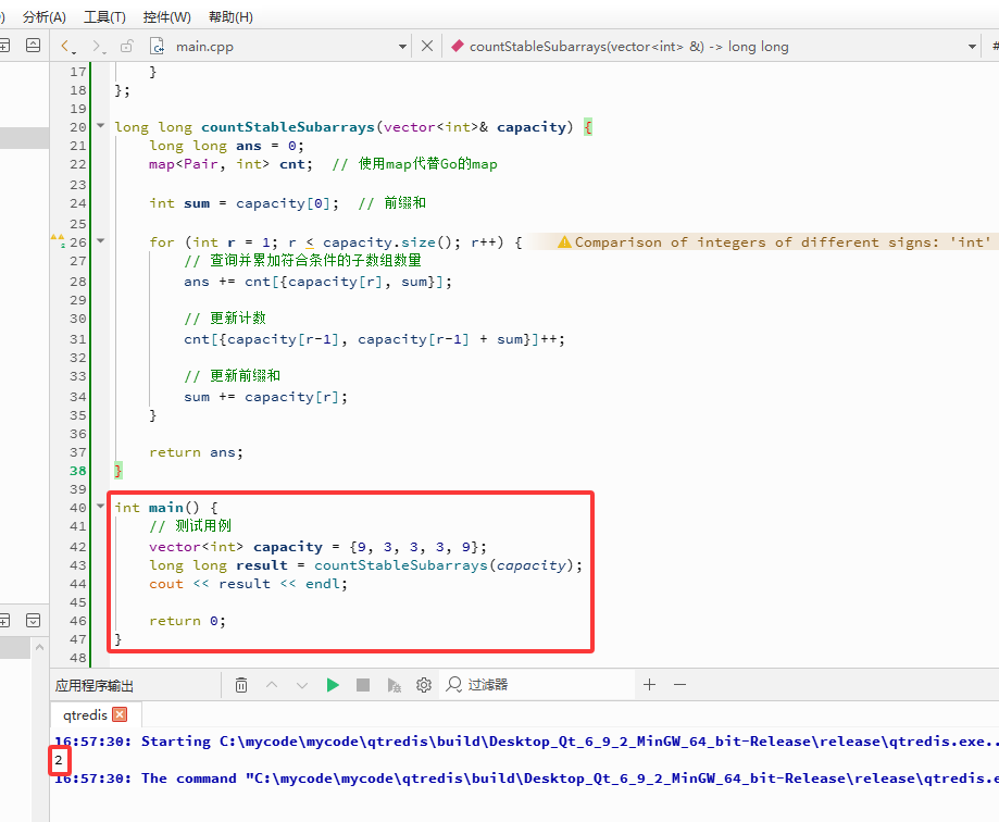

#include <iostream>
#include <vector>
#include <map>
#include <tuple>
using namespace std;
// 定义pair结构体,用于作为map的键
struct Pair {
    int x;  // 元素值
    int s;  // 和/前缀和
    // 需要定义比较运算符才能作为map的键
    bool operator<(const Pair& other) const {
        if (x != other.x) return x < other.x;
        return s < other.s;
long long countStableSubarrays(vector<int>& capacity) {
    long long ans = 0;
    map<Pair, int> cnt;  // 使用map代替Go的map
    int sum = capacity[0];  // 前缀和
    for (int r = 1; r < capacity.size(); r++) {
        // 查询并累加符合条件的子数组数量
        ans += cnt[{capacity[r], sum}];
        // 更新计数
        cnt[{capacity[r-1], capacity[r-1] + sum}]++;
        // 更新前缀和
        sum += capacity[r];
    return ans;
int main() {
    // 测试用例
    vector<int> capacity = {9, 3, 3, 3, 9};
    long long result = countStableSubarrays(capacity);
    cout << result << endl;
    return 0;
