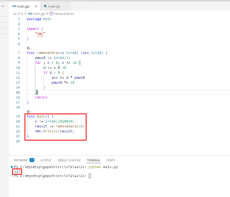

Go完整代码如下:
package main
import (
	"fmt"
func removeZeros(n int64) (ans int64) {
	pow10 := int64(1)
	for ; n > 0; n /= 10 {
		d := n % 10
		if d > 0 {
			ans += d * pow10
			pow10 *= 10
	return
func main() {
	n := int64(1020030)
	result := removeZeros(n)
	fmt.Println(result)

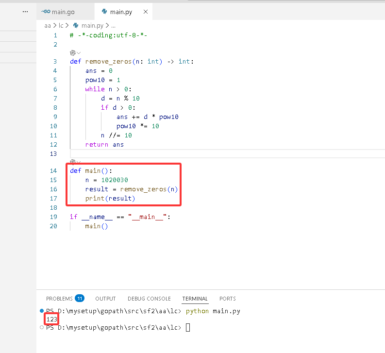

Python完整代码如下:
# -*-coding:utf-8-*-
def remove_zeros(n: int) -> int:
    ans = 0
    pow10 = 1
    while n > 0:
        d = n % 10
        if d > 0:
            ans += d * pow10
            pow10 *= 10
        n //= 10
    return ans
def main():
    n = 1020030
    result = remove_zeros(n)
    print(result)
if __name__ == "__main__":
    main()

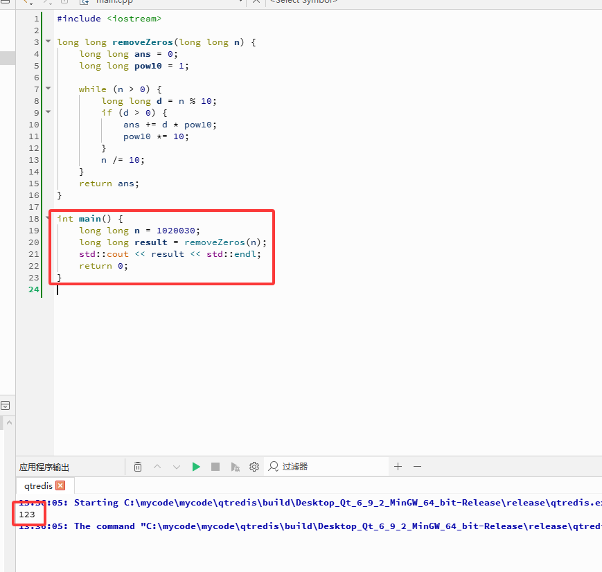

C++完整代码如下:
#include <iostream>
long long removeZeros(long long n) {
    long long ans = 0;
    long long pow10 = 1;
    while (n > 0) {
        long long d = n % 10;
        if (d > 0) {
            ans += d * pow10;
            pow10 *= 10;
        n /= 10;
    return ans;
int main() {
    long long n = 1020030;
    long long result = removeZeros(n);
    std::cout << result << std::endl;
    return 0;
