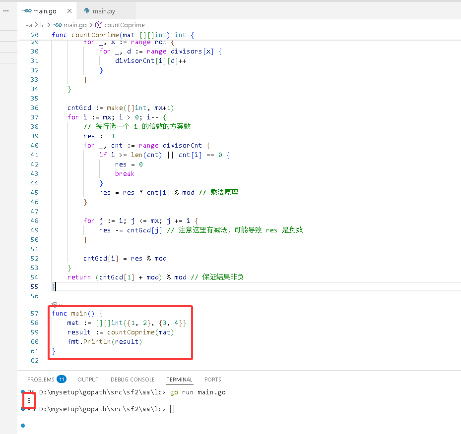

Go完整代码如下:
package main
import (
	"fmt"
	"slices"
const maxVal = 151
var divisors [maxVal][]int
func init() {
	for i := 1; i < maxVal; i++ {
		for j := i; j < maxVal; j += i {
			divisors[j] = append(divisors[j], i)
func countCoprime(mat [][]int) int {
	const mod = 1_000_000_007
	// 预处理每行的因子个数
	divisorCnt := make([][]int, len(mat))
	mx := 0
	for i, row := range mat {
		rowMax := slices.Max(row)
		mx = max(mx, rowMax)
		divisorCnt[i] = make([]int, rowMax+1)
		for _, x := range row {
			for _, d := range divisors[x] {
				divisorCnt[i][d]++
	cntGcd := make([]int, mx+1)
	for i := mx; i > 0; i-- {
		// 每行选一个 i 的倍数的方案数
		res := 1
		for _, cnt := range divisorCnt {
			if i >= len(cnt) || cnt[i] == 0 {
				res = 0
				break
			res = res * cnt[i] % mod // 乘法原理
		for j := i; j <= mx; j += i {
			res -= cntGcd[j] // 注意这里有减法,可能导致 res 是负数
		cntGcd[i] = res % mod
	return (cntGcd[1] + mod) % mod // 保证结果非负

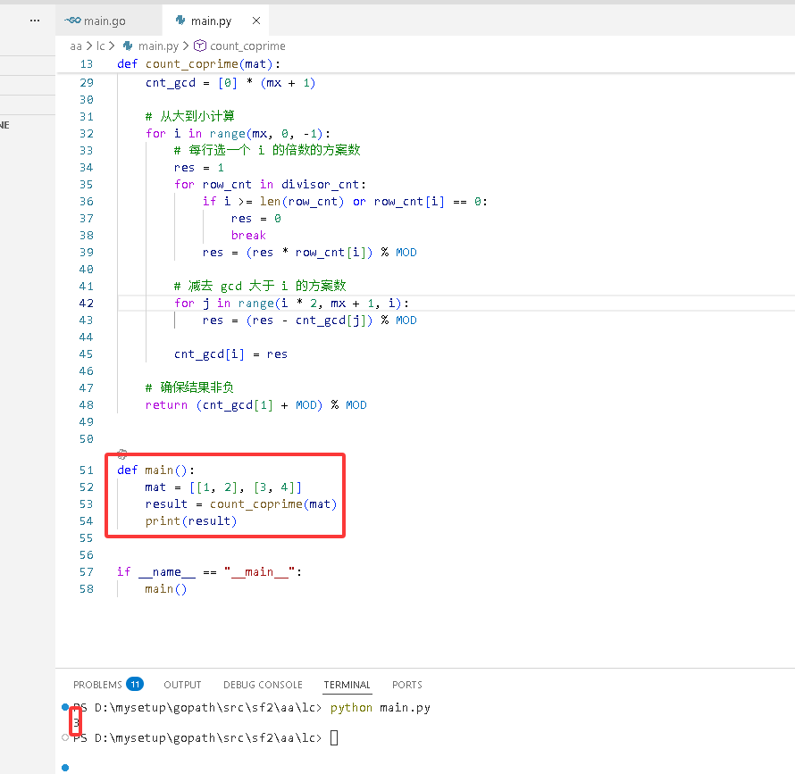

Python完整代码如下:
# -*-coding:utf-8-*-
MOD = 1_000_000_007
MAX_VAL = 151
# 预处理每个数的因子
divisors = [[] for _ in range(MAX_VAL)]
for i in range(1, MAX_VAL):
    for j in range(i, MAX_VAL, i):
        divisors[j].append(i)
def count_coprime(mat):
    # 预处理每行的因子计数
    divisor_cnt = []
    mx = 0
    for row in mat:
        row_max = max(row)
        mx = max(mx, row_max)
        # 创建当前行的计数数组,长度为 row_max + 1
        row_cnt = [0] * (row_max + 1)
        for x in row:
            for d in divisors[x]:
                if d <= row_max:
                    row_cnt[d] += 1
        divisor_cnt.append(row_cnt)
    cnt_gcd = [0] * (mx + 1)
    # 从大到小计算
    for i in range(mx, 0, -1):
        # 每行选一个 i 的倍数的方案数
        res = 1
        for row_cnt in divisor_cnt:
            if i >= len(row_cnt) or row_cnt[i] == 0:
                res = 0
                break
            res = (res * row_cnt[i]) % MOD
        # 减去 gcd 大于 i 的方案数
        for j in range(i * 2, mx + 1, i):
            res = (res - cnt_gcd[j]) % MOD
        cnt_gcd[i] = res
    # 确保结果非负
    return (cnt_gcd[1] + MOD) % MOD
def main():
    mat = [[1, 2], [3, 4]]
    result = count_coprime(mat)
    print(result)
if __name__ == "__main__":
    main()

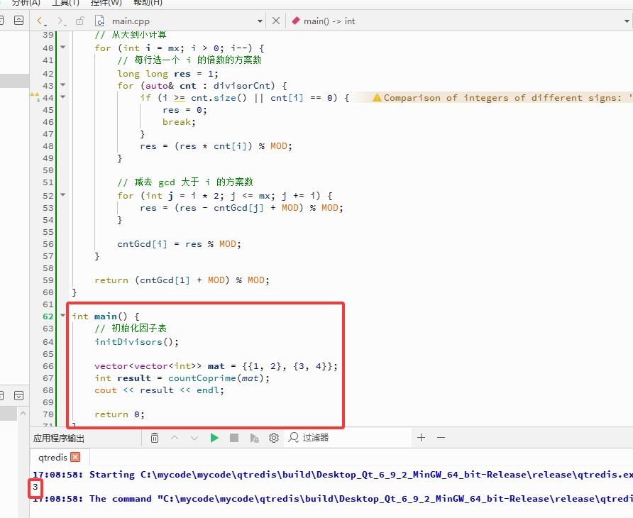

C++完整代码如下:
#include <iostream>
#include <vector>
#include <algorithm>
using namespace std;
const int MAX_VAL = 151;
const int MOD = 1'000'000'007;
vector<int> divisors[MAX_VAL];
// 初始化函数,预计算每个数的因子
void initDivisors() {
    for (int i = 1; i < MAX_VAL; i++) {
        for (int j = i; j < MAX_VAL; j += i) {
            divisors[j].push_back(i);
int countCoprime(vector<vector<int>>& mat) {
    // 预处理每行的因子个数
    vector<vector<int>> divisorCnt(mat.size());
    int mx = 0;
    for (int i = 0; i < mat.size(); i++) {
        int rowMax = *max_element(mat[i].begin(), mat[i].end());
        mx = max(mx, rowMax);
        divisorCnt[i].resize(rowMax + 1, 0);
        for (int x : mat[i]) {
            for (int d : divisors[x]) {
                divisorCnt[i][d]++;
    vector<int> cntGcd(mx + 1, 0);
    // 从大到小计算
    for (int i = mx; i > 0; i--) {
        // 每行选一个 i 的倍数的方案数
        long long res = 1;
        for (auto& cnt : divisorCnt) {
            if (i >= cnt.size() || cnt[i] == 0) {
                res = 0;
                break;
            res = (res * cnt[i]) % MOD;
        // 减去 gcd 大于 i 的方案数
        for (int j = i * 2; j <= mx; j += i) {
            res = (res - cntGcd[j] + MOD) % MOD;
        cntGcd[i] = res % MOD;
    return (cntGcd[1] + MOD) % MOD;
int main() {
    // 初始化因子表
    initDivisors();
    vector<vector<int>> mat = {{1, 2}, {3, 4}};
    int result = countCoprime(mat);
    cout << result << endl;
    return 0;
