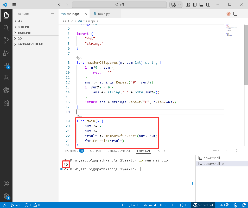

Go完整代码如下:
package main
import (
	"fmt"
	"strings"
func maxSumOfSquares(n, sum int) string {
	if n*9 < sum {
		return ""
	ans := strings.Repeat("9", sum/9)
	if sum%9 > 0 {
		ans += string('0' + byte(sum%9))
	return ans + strings.Repeat("0", n-len(ans))
func main() {
	num := 2
	sum := 3
	result := maxSumOfSquares(num, sum)
	fmt.Println(result)

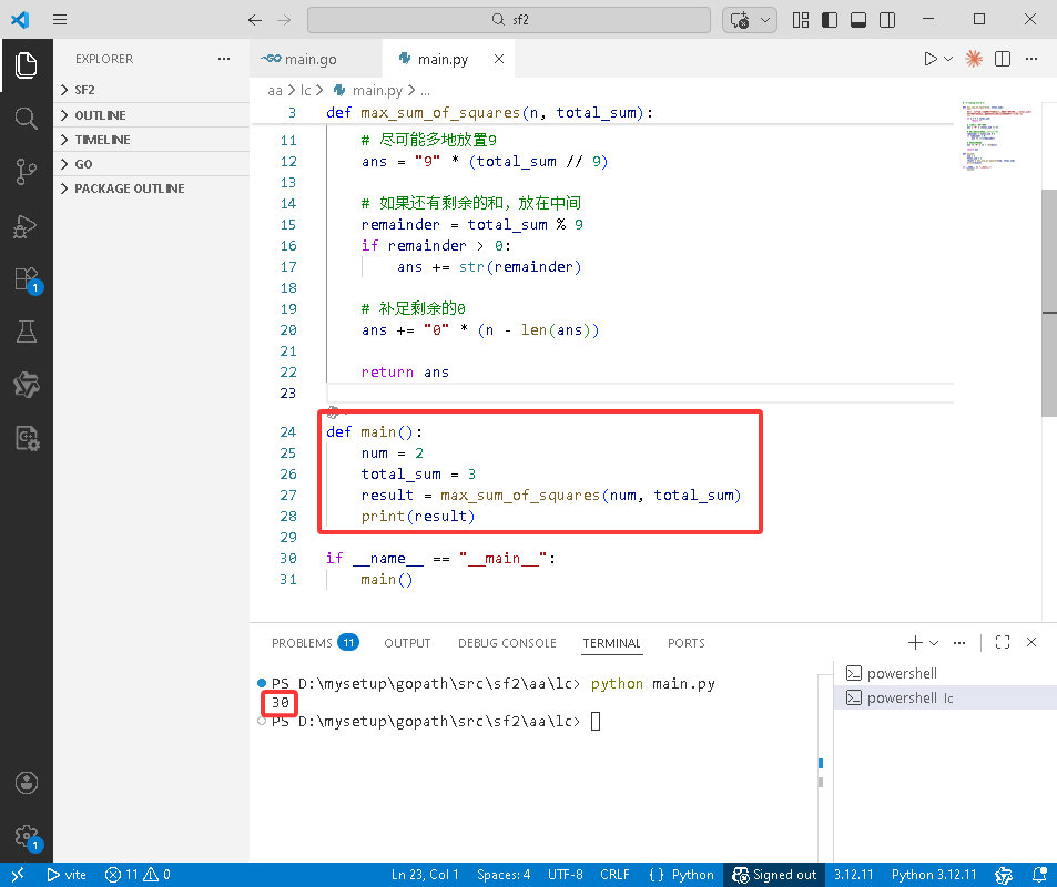

Python完整代码如下:
# -*-coding:utf-8-*-
def max_sum_of_squares(n, total_sum):
    返回一个长度为n的数字字符串,使得各位数字之和为total_sum,
    并且数字的平方和最大(即尽可能把大的数字放在高位)
    if n * 9 < total_sum:
        return ""
    # 尽可能多地放置9
    ans = "9" * (total_sum // 9)
    # 如果还有剩余的和,放在中间
    remainder = total_sum % 9
    if remainder > 0:
        ans += str(remainder)
    # 补足剩余的0
    ans += "0" * (n - len(ans))
    return ans
def main():
    num = 2
    total_sum = 3
    result = max_sum_of_squares(num, total_sum)
    print(result)
if __name__ == "__main__":
    main()

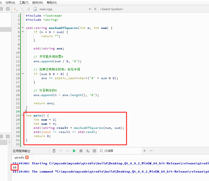

C++完整代码如下:
#include <iostream>
#include <string>
std::string maxSumOfSquares(int n, int sum) {
    if (n * 9 < sum) {
        return "";
    std::string ans;
    // 尽可能多地放置9
    ans.append(sum / 9, '9');
    // 如果还有剩余的和,放在中间
    if (sum % 9 > 0) {
        ans += static_cast<char>('0' + sum % 9);
    // 补足剩余的0
    ans.append(n - ans.length(), '0');
    return ans;
int main() {
    int num = 2;
    int sum = 3;
    std::string result = maxSumOfSquares(num, sum);
    std::cout << result << std::endl;
    return 0;
