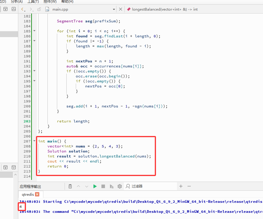

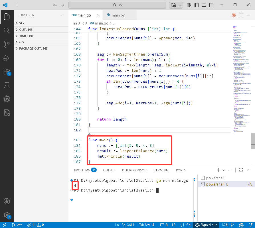

func main() {
	nums := []int{2, 5, 4, 3}
	result := longestBalanced(nums)
	fmt.Println(result)

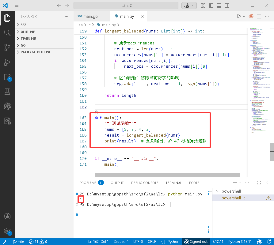

def main():
    """测试函数"""
    nums = [2, 5, 4, 3]
    result = longest_balanced(nums)
    print(result)  # 预期输出:0?4?根据算法逻辑
if __name__ == "__main__":
    main()
C++完整代码如下:
#include <iostream>
#include <vector>
#include <unordered_map>
#include <algorithm>
using namespace std;
class LazyTag {
public:
    int toAdd;
    LazyTag(int to_add = 0) : toAdd(to_add) {}
    LazyTag* add(LazyTag* other) {
        toAdd += other->toAdd;
        return this;
    bool hasTag() const {
        return toAdd != 0;
    void clear() {
        toAdd = 0;
class SegmentTreeNode {
public:
    int minValue;
    int maxValue;
    LazyTag* lazyTag;
    SegmentTreeNode() : minValue(0), maxValue(0) {
        lazyTag = new LazyTag();
    ~SegmentTreeNode() {
        delete lazyTag;
class SegmentTree {
private:
    int n;
    vector<SegmentTreeNode*> tree;
    void applyTag(int i, LazyTag* tag) {
        tree[i]->minValue += tag->toAdd;
        tree[i]->maxValue += tag->toAdd;
        tree[i]->lazyTag->add(tag);
    void pushdown(int i) {
        if (tree[i]->lazyTag->hasTag()) {
            LazyTag* tag = new LazyTag(tree[i]->lazyTag->toAdd);
            applyTag(i << 1, tag);
            applyTag((i << 1) | 1, tag);
            tree[i]->lazyTag->clear();
            delete tag;
    void pushup(int i) {
        tree[i]->minValue = min(tree[i << 1]->minValue, tree[(i << 1) | 1]->minValue);
        tree[i]->maxValue = max(tree[i << 1]->maxValue, tree[(i << 1) | 1]->maxValue);
    void build(const vector<int>& data, int l, int r, int i) {
        if (l == r) {
            tree[i]->minValue = data[l - 1];
            tree[i]->maxValue = data[l - 1];
            return;
        int mid = l + ((r - l) >> 1);
        build(data, l, mid, i << 1);
        build(data, mid + 1, r, (i << 1) | 1);
        pushup(i);
    void update(int targetL, int targetR, LazyTag* tag, int l, int r, int i) {
        if (targetL <= l && r <= targetR) {
            applyTag(i, tag);
            return;
        pushdown(i);
        if (targetL <= mid) {
            update(targetL, targetR, tag, l, mid, i << 1);
        if (targetR > mid) {
            update(targetL, targetR, tag, mid + 1, r, (i << 1) | 1);
        pushup(i);
    int find(int targetL, int targetR, int val, int l, int r, int i) {
        if (tree[i]->minValue > val || tree[i]->maxValue < val) {
            return -1;
        if (l == r) {
            return l;
        pushdown(i);
        // 先查找右半部分
        if (targetR >= mid + 1) {
            int res = find(targetL, targetR, val, mid + 1, r, (i << 1) | 1);
            if (res != -1) {
                return res;
        // 再查找左半部分
        if (l <= targetR && mid >= targetL) {
            return find(targetL, targetR, val, l, mid, i << 1);
        return -1;
public:
    SegmentTree(const vector<int>& data) {
        n = data.size();
        tree.resize(n * 4 + 1);
        for (int i = 0; i <= n * 4; i++) {
            tree[i] = new SegmentTreeNode();
        build(data, 1, n, 1);
    ~SegmentTree() {
        for (auto node : tree) {
            delete node;
    void add(int l, int r, int val) {
        LazyTag* tag = new LazyTag(val);
        update(l, r, tag, 1, n, 1);
        delete tag;
    int findLast(int start, int val) {
        if (start > n) {
            return -1;
        return find(start, n, val, 1, n, 1);
class Solution {
public:
    int longestBalanced(vector<int>& nums) {
        unordered_map<int, vector<int>> occurrences;
        auto sgn = [](int x) -> int {
            return (x % 2 == 0) ? 1 : -1;
        int length = 0;
        int n = nums.size();
        vector<int> prefixSum(n);
        if (n == 0) return 0;
        prefixSum[0] = sgn(nums[0]);
        occurrences[nums[0]] = vector<int>{1};
        for (int i = 1; i < n; i++) {
            prefixSum[i] = prefixSum[i - 1];
            auto& occ = occurrences[nums[i]];
            if (occ.empty()) {
                prefixSum[i] += sgn(nums[i]);
            occ.push_back(i + 1);
        SegmentTree seg(prefixSum);
        for (int i = 0; i < n; i++) {
            int found = seg.findLast(i + length, 0);
            if (found != -1) {
                length = max(length, found - i);
            int nextPos = n + 1;
            if (!occ.empty()) {
                occ.erase(occ.begin());
                if (!occ.empty()) {
                    nextPos = occ[0];
            seg.add(i + 1, nextPos - 1, -sgn(nums[i]));
        return length;
int main() {
    vector<int> nums = {2, 5, 4, 3};
    Solution solution;
    int result = solution.longestBalanced(nums);
    cout << result << endl;
    return 0;
