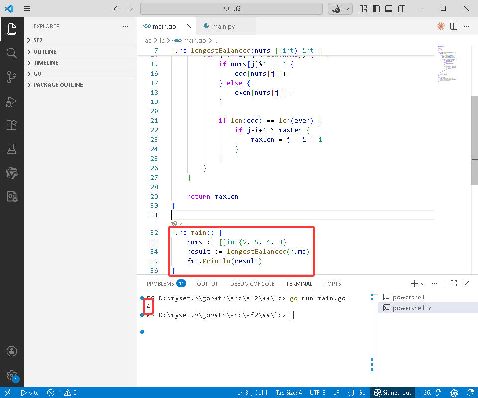

Go完整代码如下:
package main
import (
	"fmt"
func longestBalanced(nums []int) int {
	maxLen := 0
	for i := 0; i < len(nums); i++ {
		odd := make(map[int]int)
		even := make(map[int]int)
		for j := i; j < len(nums); j++ {
			if nums[j]&1 == 1 {
				odd[nums[j]]++
			} else {
				even[nums[j]]++
			if len(odd) == len(even) {
				if j-i+1 > maxLen {
					maxLen = j - i + 1
	return maxLen
func main() {
	nums := []int{2, 5, 4, 3}
	result := longestBalanced(nums)
	fmt.Println(result)

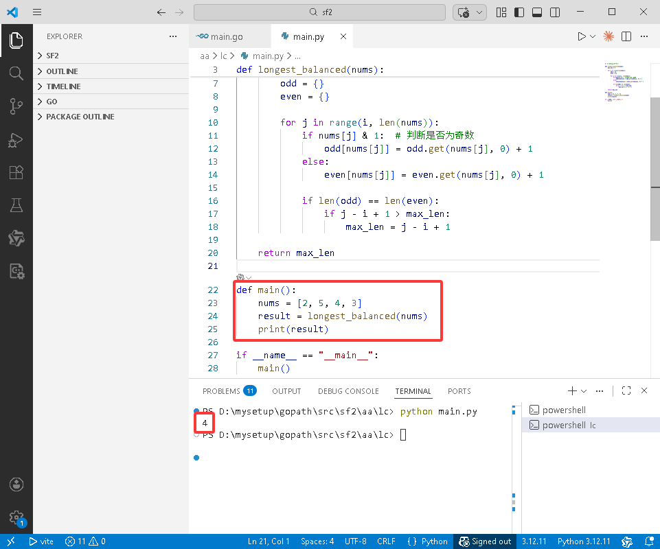

Python完整代码如下:
# -*-coding:utf-8-*-
def longest_balanced(nums):
    max_len = 0
    for i in range(len(nums)):
        odd = {}
        even = {}
        for j in range(i, len(nums)):
            if nums[j] & 1:  # 判断是否为奇数
                odd[nums[j]] = odd.get(nums[j], 0) + 1
            else:
                even[nums[j]] = even.get(nums[j], 0) + 1
            if len(odd) == len(even):
                if j - i + 1 > max_len:
                    max_len = j - i + 1
    return max_len
def main():
    nums = [2, 5, 4, 3]
    result = longest_balanced(nums)
    print(result)
if __name__ == "__main__":
    main()
