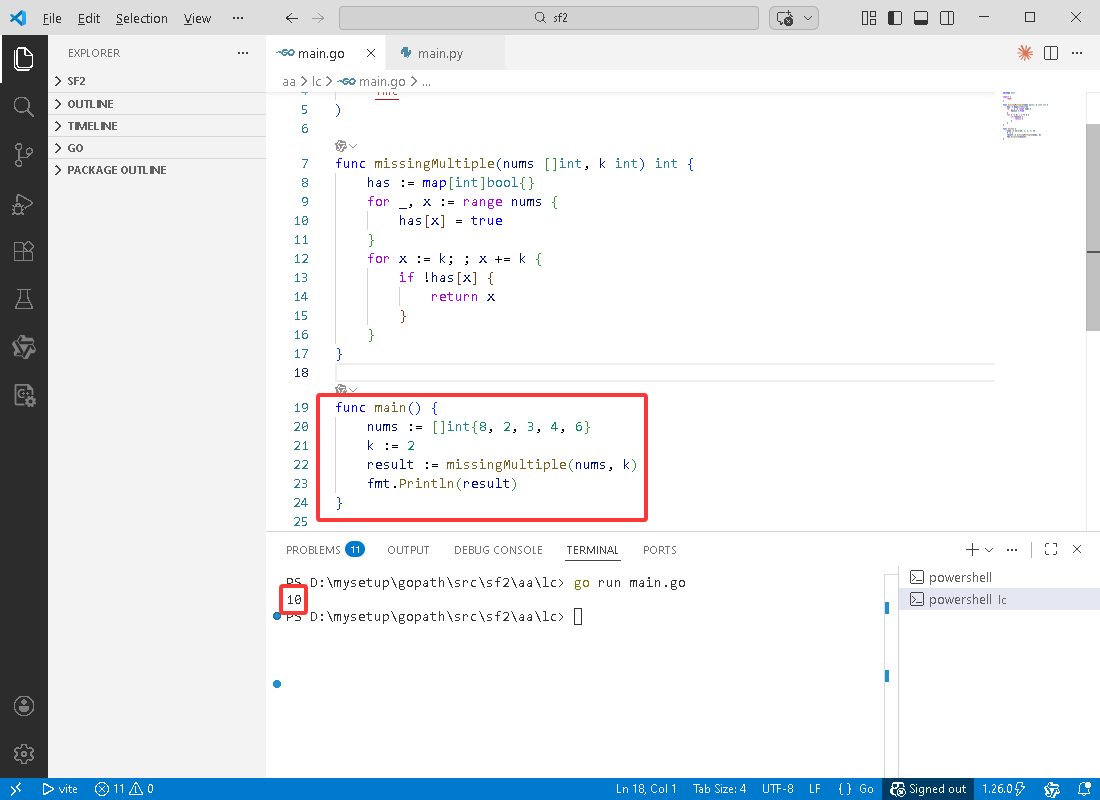

Go完整代码如下:
package main
import (
	"fmt"
func missingMultiple(nums []int, k int) int {
	has := map[int]bool{}
	for _, x := range nums {
		has[x] = true
	for x := k; ; x += k {
		if !has[x] {
			return x
func main() {
	nums := []int{8, 2, 3, 4, 6}
	k := 2
	result := missingMultiple(nums, k)
	fmt.Println(result)

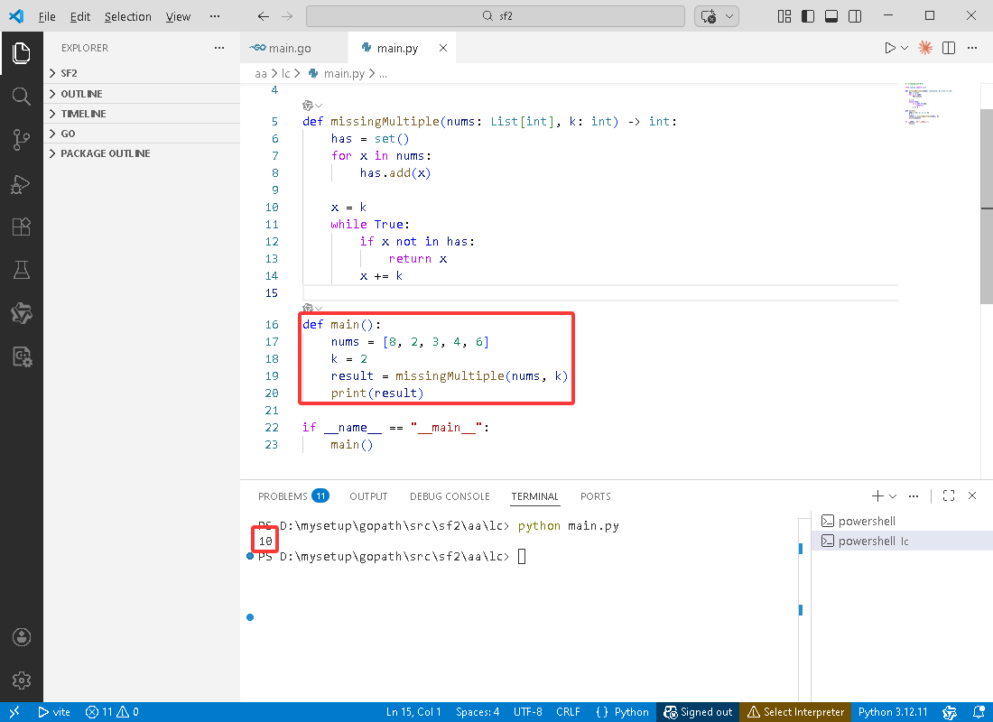

Python完整代码如下:
# -*-coding:utf-8-*-
from typing import List
def missingMultiple(nums: List[int], k: int) -> int:
    has = set()
    for x in nums:
        has.add(x)
    x = k
    while True:
        if x not in has:
            return x
        x += k
def main():
    nums = [8, 2, 3, 4, 6]
    k = 2
    result = missingMultiple(nums, k)
    print(result)
if __name__ == "__main__":
    main()

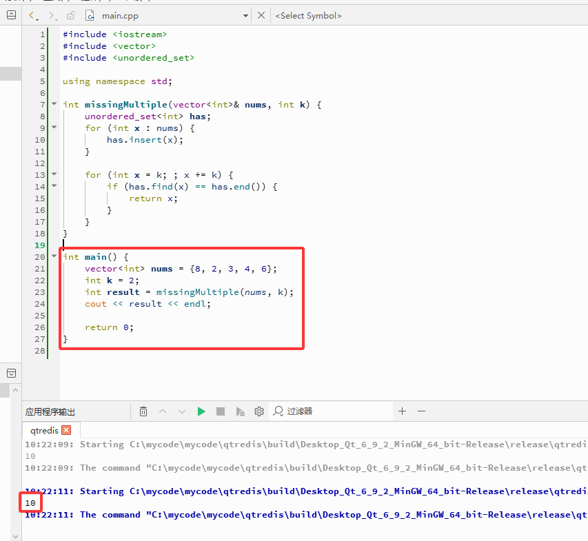

C++完整代码如下:
#include <iostream>
#include <vector>
#include <unordered_set>
using namespace std;
int missingMultiple(vector<int>& nums, int k) {
    unordered_set<int> has;
    for (int x : nums) {
        has.insert(x);
    for (int x = k; ; x += k) {
        if (has.find(x) == has.end()) {
            return x;
int main() {
    vector<int> nums = {8, 2, 3, 4, 6};
    int k = 2;
    int result = missingMultiple(nums, k);
    cout << result << endl;
    return 0;
