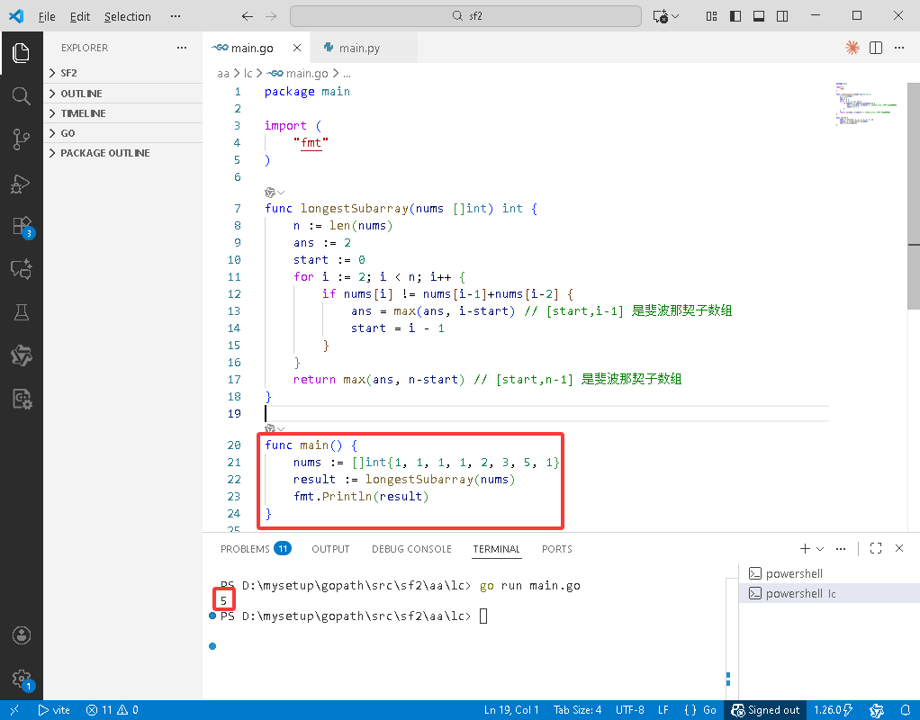

Go完整代码如下:
package main
import (
	"fmt"
func longestSubarray(nums []int) int {
	n := len(nums)
	ans := 2
	start := 0
	for i := 2; i < n; i++ {
		if nums[i] != nums[i-1]+nums[i-2] {
			ans = max(ans, i-start) // [start,i-1] 是斐波那契子数组
			start = i - 1
	return max(ans, n-start) // [start,n-1] 是斐波那契子数组
func main() {
	nums := []int{1, 1, 1, 1, 2, 3, 5, 1}
	result := longestSubarray(nums)
	fmt.Println(result)

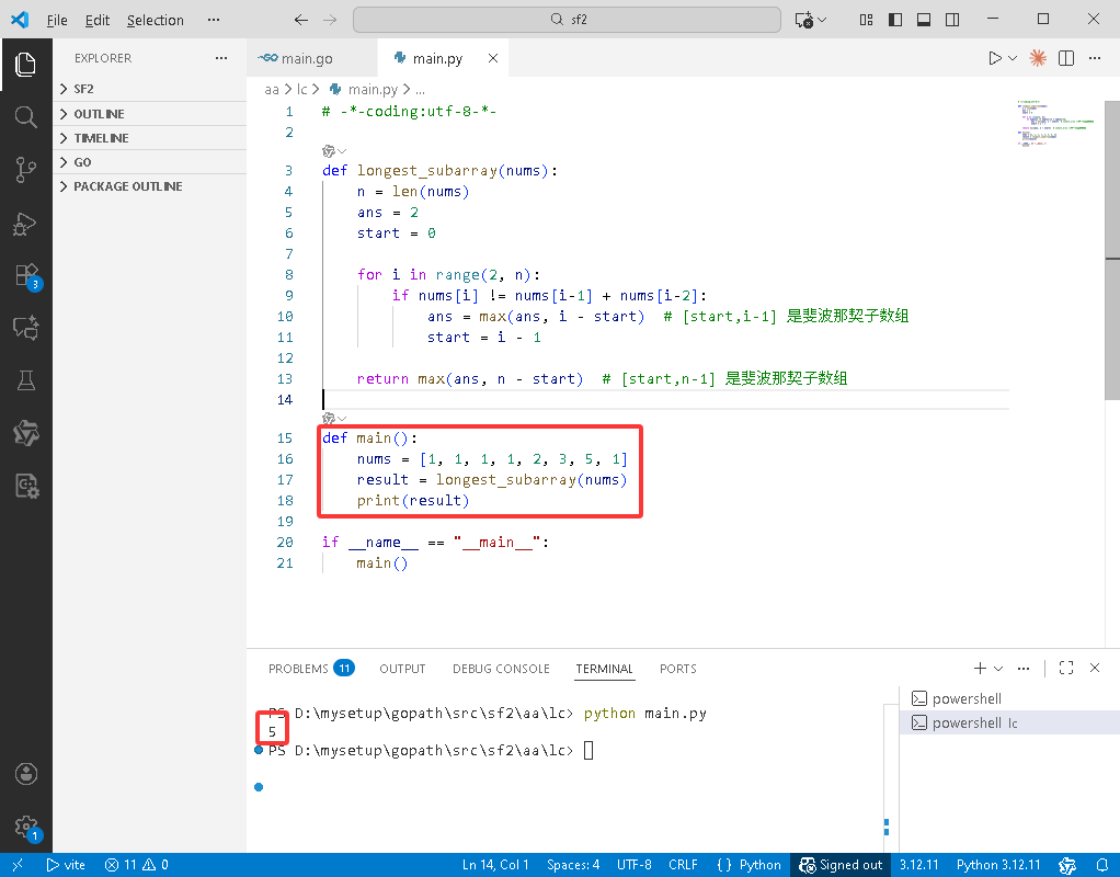

Python完整代码如下:
# -*-coding:utf-8-*-
def longest_subarray(nums):
    n = len(nums)
    ans = 2
    start = 0
    for i in range(2, n):
        if nums[i] != nums[i-1] + nums[i-2]:
            ans = max(ans, i - start)  # [start,i-1] 是斐波那契子数组
            start = i - 1
    return max(ans, n - start)  # [start,n-1] 是斐波那契子数组
def main():
    nums = [1, 1, 1, 1, 2, 3, 5, 1]
    result = longest_subarray(nums)
    print(result)
if __name__ == "__main__":
    main()

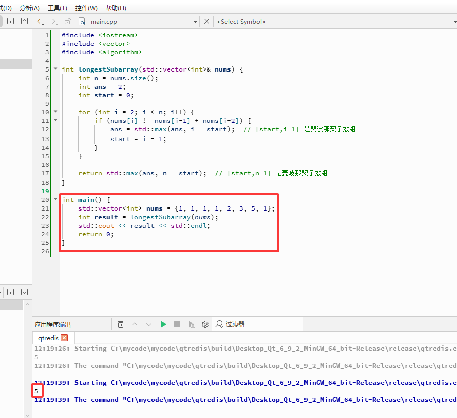

C++完整代码如下:
#include <iostream>
#include <vector>
#include <algorithm>
int longestSubarray(std::vector<int>& nums) {
    int n = nums.size();
    int ans = 2;
    int start = 0;
    for (int i = 2; i < n; i++) {
        if (nums[i] != nums[i-1] + nums[i-2]) {
            ans = std::max(ans, i - start);  // [start,i-1] 是斐波那契子数组
            start = i - 1;
    return std::max(ans, n - start);  // [start,n-1] 是斐波那契子数组
int main() {
    std::vector<int> nums = {1, 1, 1, 1, 2, 3, 5, 1};
    int result = longestSubarray(nums);
    std::cout << result << std::endl;
    return 0;
