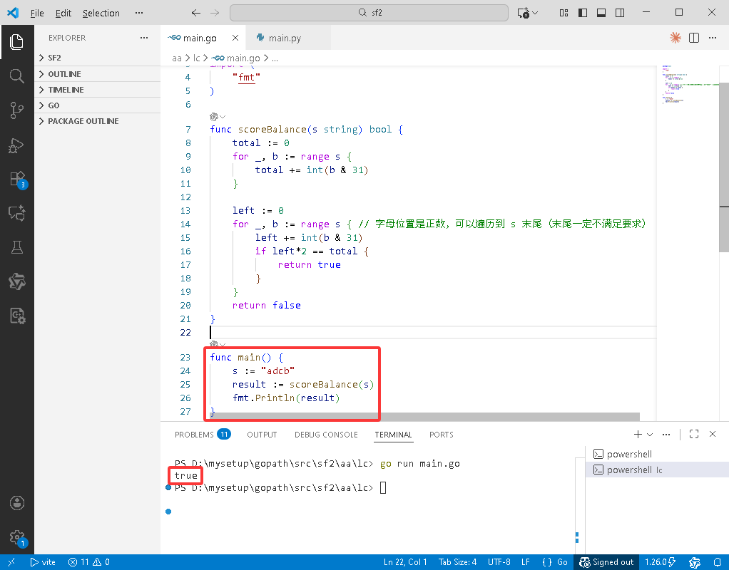

Go完整代码如下:
package main
import (
	"fmt"
func scoreBalance(s string) bool {
	total := 0
	for _, b := range s {
		total += int(b & 31)
	left := 0
	for _, b := range s { // 字母位置是正数,可以遍历到 s 末尾(末尾一定不满足要求)
		left += int(b & 31)
		if left*2 == total {
			return true
	return false
func main() {
	s := "adcb"
	result := scoreBalance(s)
	fmt.Println(result)

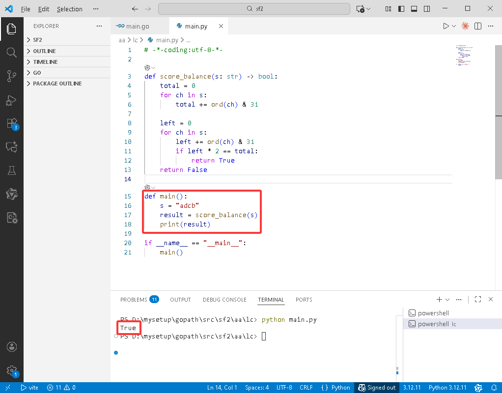

Python完整代码如下:
# -*-coding:utf-8-*-
def score_balance(s: str) -> bool:
    total = 0
    for ch in s:
        total += ord(ch) & 31
    left = 0
    for ch in s:
        left += ord(ch) & 31
        if left * 2 == total:
            return True
    return False
def main():
    s = "adcb"
    result = score_balance(s)
    print(result)
if __name__ == "__main__":
    main()

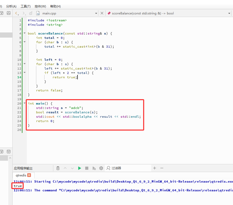

C++完整代码如下:
#include <iostream>
#include <string>
bool scoreBalance(const std::string& s) {
    int total = 0;
    for (char b : s) {
        total += static_cast<int>(b & 31);
    int left = 0;
    for (char b : s) {
        left += static_cast<int>(b & 31);
        if (left * 2 == total) {
            return true;
    return false;
int main() {
    std::string s = "adcb";
    bool result = scoreBalance(s);
    std::cout << std::boolalpha << result << std::endl;
    return 0;
