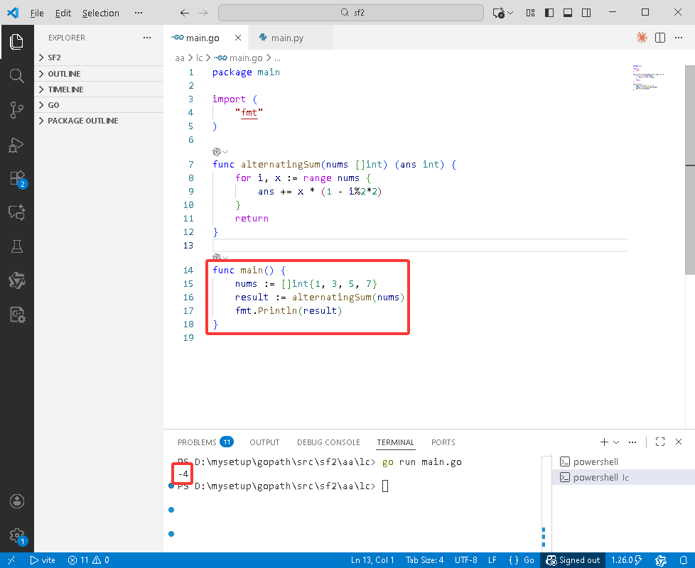

Go完整代码如下:
package main
import (
	"fmt"
func alternatingSum(nums []int) (ans int) {
	for i, x := range nums {
		ans += x * (1 - i%2*2)
	return
func main() {
	nums := []int{1, 3, 5, 7}
	result := alternatingSum(nums)
	fmt.Println(result)

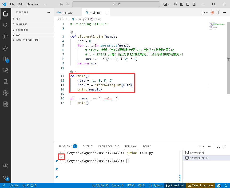

Python完整代码如下:
# -*-coding:utf-8-*-
def alternatingSum(nums):
    ans = 0
    for i, x in enumerate(nums):
        # i%2*2 计算:当i为偶数时结果为0,当i为奇数时结果为2
        # 1 - i%2*2 计算:当i为偶数时结果为1,当i为奇数时结果为-1
        ans += x * (1 - (i % 2) * 2)
    return ans
def main():
    nums = [1, 3, 5, 7]
    result = alternatingSum(nums)
    print(result)
if __name__ == "__main__":
    main()

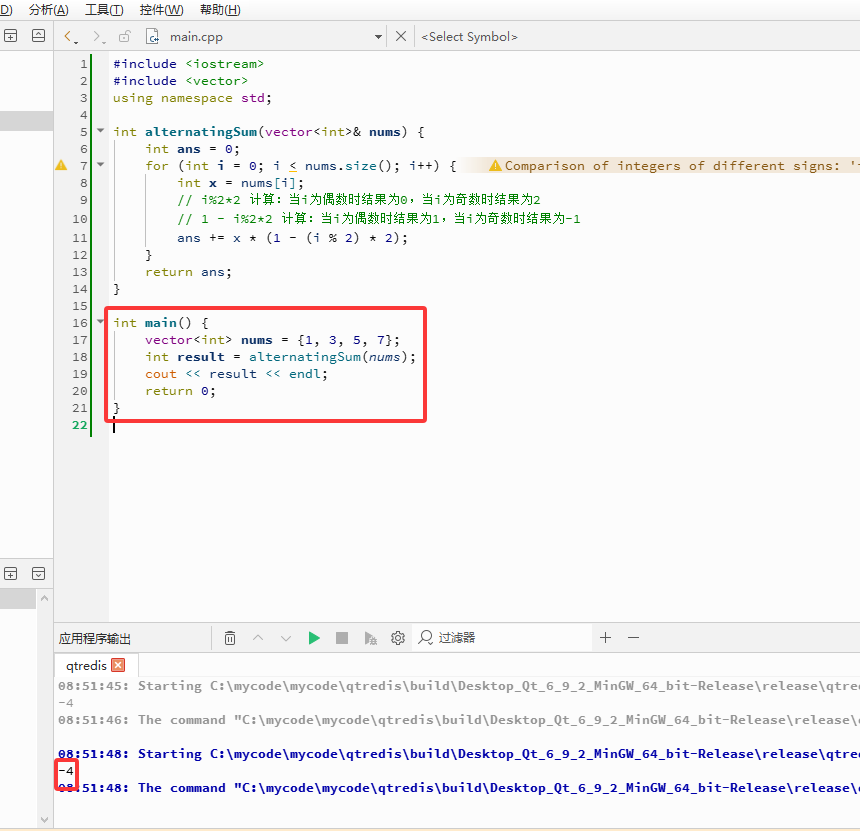

C++完整代码如下:
#include <iostream>
#include <vector>
using namespace std;
int alternatingSum(vector<int>& nums) {
    int ans = 0;
    for (int i = 0; i < nums.size(); i++) {
        int x = nums[i];
        // i%2*2 计算:当i为偶数时结果为0,当i为奇数时结果为2
        // 1 - i%2*2 计算:当i为偶数时结果为1,当i为奇数时结果为-1
        ans += x * (1 - (i % 2) * 2);
    return ans;
int main() {
    vector<int> nums = {1, 3, 5, 7};
    int result = alternatingSum(nums);
    cout << result << endl;
    return 0;
