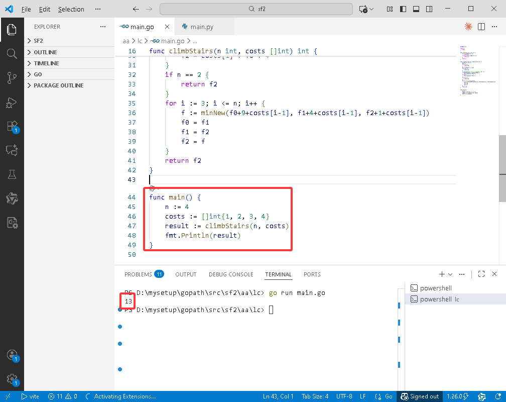

Go完整代码如下:
package main
import (
	"fmt"
func minNew(a, b, c int) int {
	if a <= b && a <= c {
		return a
	} else if b <= a && b <= c {
		return b
	return c
func climbStairs(n int, costs []int) int {
	var f0, f1, f2 int
	f0 = 0
	if n == 0 {
		return f0
	f1 = costs[0] + 1 + f0
	if n == 1 {
		return f1
	// min(costs[1] + f1 + 1, costs[1] + f0 + 4)
	if costs[1]+f1+1 < costs[1]+f0+4 {
		f2 = costs[1] + f1 + 1
	} else {
		f2 = costs[1] + f0 + 4
	if n == 2 {
		return f2
	for i := 3; i <= n; i++ {
		f := minNew(f0+9+costs[i-1], f1+4+costs[i-1], f2+1+costs[i-1])
		f0 = f1
		f1 = f2
		f2 = f
	return f2
func main() {
	n := 4
	costs := []int{1, 2, 3, 4}
	result := climbStairs(n, costs)
	fmt.Println(result)

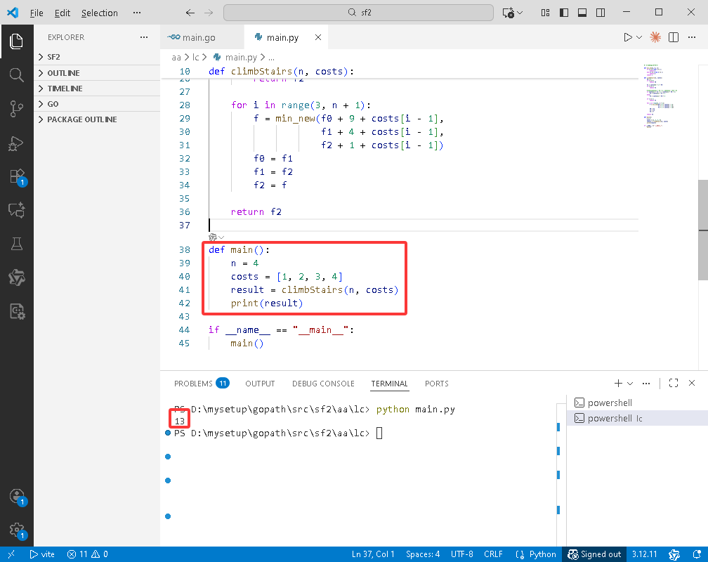

Python完整代码如下:
# -*-coding:utf-8-*-
def min_new(a, b, c):
    if a <= b and a <= c:
        return a
    elif b <= a and b <= c:
        return b
    return c
def climbStairs(n, costs):
    f0 = 0
    if n == 0:
        return f0
    if n == 1:
        return f1
    # min(costs[1] + f1 + 1, costs[1] + f0 + 4)
    if costs[1] + f1 + 1 < costs[1] + f0 + 4:
    else:
    if n == 2:
        return f2
    for i in range(3, n + 1):
        f = min_new(f0 + 9 + costs[i - 1],
                    f1 + 4 + costs[i - 1],
                    f2 + 1 + costs[i - 1])
        f0 = f1
        f1 = f2
        f2 = f
    return f2
def main():
    n = 4
    costs = [1, 2, 3, 4]
    result = climbStairs(n, costs)
    print(result)
if __name__ == "__main__":
    main()

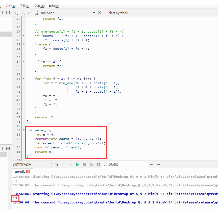

C++完整代码如下:
#include <iostream>
#include <vector>
using namespace std;
int min_new(int a, int b, int c) {
    if (a <= b && a <= c) {
        return a;
    } else if (b <= a && b <= c) {
        return b;
    return c;
int climbStairs(int n, vector<int>& costs) {
    int f0, f1, f2;
    f0 = 0;
    if (n == 0) {
        return f0;
    f1 = costs[0] + 1 + f0;
    if (n == 1) {
        return f1;
    if (costs[1] + f1 + 1 < costs[1] + f0 + 4) {
        f2 = costs[1] + f1 + 1;
    } else {
        f2 = costs[1] + f0 + 4;
    if (n == 2) {
        return f2;
    for (int i = 3; i <= n; i++) {
        int f = min_new(f0 + 9 + costs[i - 1],
                        f2 + 1 + costs[i - 1]);
        f0 = f1;
        f1 = f2;
        f2 = f;
    return f2;
int main() {
    int n = 4;
    vector<int> costs = {1, 2, 3, 4};
    int result = climbStairs(n, costs);
    cout << result << endl;
    return 0;
