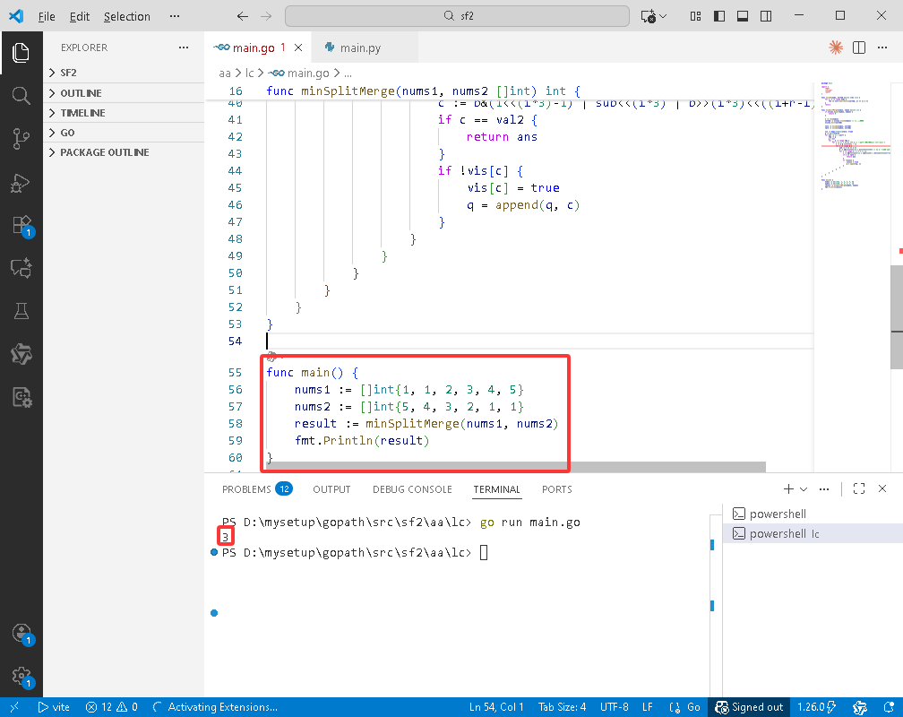

Go完整代码如下:
package main
import (
	"fmt"
	"slices"
	"sort"
func encode(nums, sorted []int) (res int) {
	for i, x := range nums {
		res |= sort.SearchInts(sorted, x) << (i * 3)
	return
func minSplitMerge(nums1, nums2 []int) int {
	if slices.Equal(nums1, nums2) {
		return 0
	n := len(nums1)
	sorted := slices.Clone(nums1) // 用于离散化
	slices.Sort(sorted)
	val1 := encode(nums1, sorted)
	val2 := encode(nums2, sorted)
	vis := map[int]bool{val1: true}
	q := []int{val1}
	for ans := 1; ; ans++ {
		tmp := q
		q = nil
		for _, a := range tmp {
			for r := 1; r <= n; r++ { // 为方便实现,先枚举 r,再枚举 l
				t := a & (1<<(r*3) - 1)
				for l := range r {
					sub := t >> (l * 3)
					b := a&(1<<(l*3)-1) | a>>(r*3)<<(l*3) // 从 a 中移除 sub
					for i := range n - r + l + 1 {
						c := b&(1<<(i*3)-1) | sub<<(i*3) | b>>(i*3)<<((i+r-l)*3)
						if c == val2 {
							return ans
						if !vis[c] {
							vis[c] = true
							q = append(q, c)
func main() {
	nums1 := []int{1, 1, 2, 3, 4, 5}
	nums2 := []int{5, 4, 3, 2, 1, 1}
	result := minSplitMerge(nums1, nums2)
	fmt.Println(result)

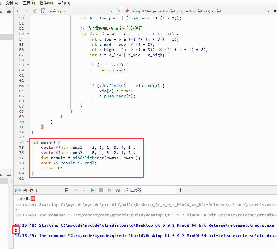

C++完整代码如下:
#include <iostream>
#include <vector>
#include <algorithm>
#include <queue>
#include <unordered_map>
using namespace std;
int encode(const vector<int>& nums, const vector<int>& sorted) {
    int res = 0;
    for (int i = 0; i < nums.size(); i++) {
        // lower_bound 相当于 Go 的 sort.SearchInts
        int idx = lower_bound(sorted.begin(), sorted.end(), nums[i]) - sorted.begin();
        res |= idx << (i * 3);
    return res;
int minSplitMerge(vector<int>& nums1, vector<int>& nums2) {
    if (nums1 == nums2) {
        return 0;
    int n = nums1.size();
    vector<int> sorted = nums1; // 用于离散化
    sort(sorted.begin(), sorted.end());
    int val1 = encode(nums1, sorted);
    int val2 = encode(nums2, sorted);
    unordered_map<int, bool> vis;
    vis[val1] = true;
    vector<int> q;
    q.push_back(val1);
    for (int ans = 1; ; ans++) {
        vector<int> tmp = q;
        q.clear();
        for (int a : tmp) {
            for (int r = 1; r <= n; r++) { // 为方便实现,先枚举 r,再枚举 l
                int t = a & ((1 << (r * 3)) - 1);
                for (int l = 0; l < r; l++) {
                    int sub = (t >> (l * 3)) & ((1 << ((r - l) * 3)) - 1);
                    // 从 a 中移除 sub
                    int low_mask = (1 << (l * 3)) - 1;
                    int low_part = a & low_mask;
                    int high_part = a >> (r * 3);
                    int b = low_part | (high_part << (l * 3));
                    // 将子数组插入到各个可能的位置
                    for (int i = 0; i < n - r + l + 1; i++) {
                        int c_low = b & ((1 << (i * 3)) - 1);
                        int c_mid = sub << (i * 3);
                        int c_high = (b >> (i * 3)) << ((i + r - l) * 3);
                        int c = c_low | c_mid | c_high;
                        if (c == val2) {
                            return ans;
                        if (vis.find(c) == vis.end()) {
                            vis[c] = true;
                            q.push_back(c);
int main() {
    vector<int> nums1 = {1, 1, 2, 3, 4, 5};
    vector<int> nums2 = {5, 4, 3, 2, 1, 1};
    int result = minSplitMerge(nums1, nums2);
    cout << result << endl;
    return 0;
