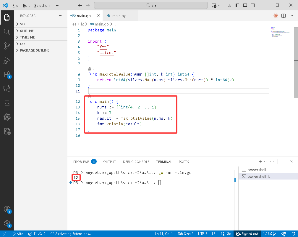

Go完整代码如下:
package main
import (
	"fmt"
	"slices"
func maxTotalValue(nums []int, k int) int64 {
	return int64(slices.Max(nums)-slices.Min(nums)) * int64(k)
func main() {
	nums := []int{4, 2, 5, 1}
	k := 3
	result := maxTotalValue(nums, k)
	fmt.Println(result)

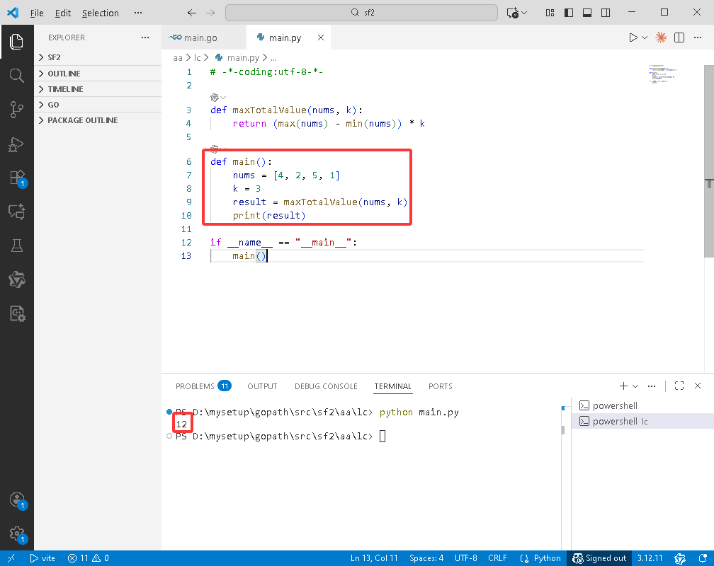

Python完整代码如下:
# -*-coding:utf-8-*-
def maxTotalValue(nums, k):
    return (max(nums) - min(nums)) * k
def main():
    nums = [4, 2, 5, 1]
    k = 3
    result = maxTotalValue(nums, k)
    print(result)
if __name__ == "__main__":
    main()
