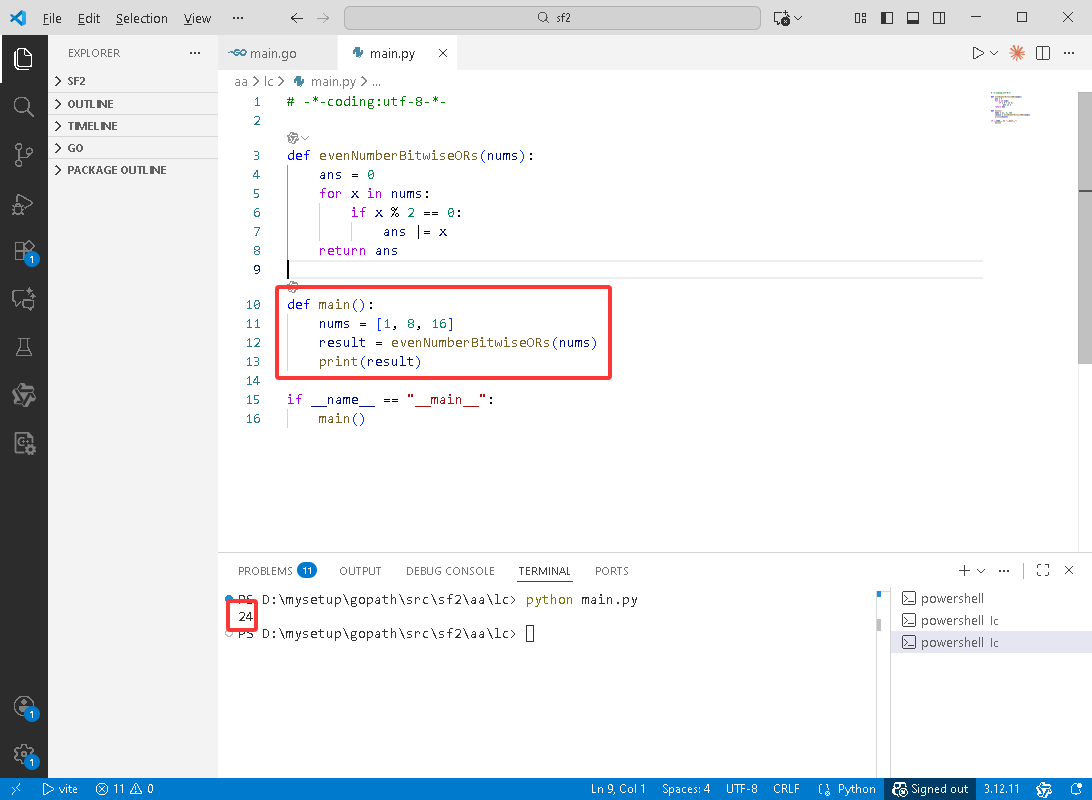

Python完整代码如下:
# -*-coding:utf-8-*-
def evenNumberBitwiseORs(nums):
    ans = 0
    for x in nums:
        if x % 2 == 0:
            ans |= x
    return ans
def main():
    nums = [1, 8, 16]
    result = evenNumberBitwiseORs(nums)
    print(result)
if __name__ == "__main__":
    main()

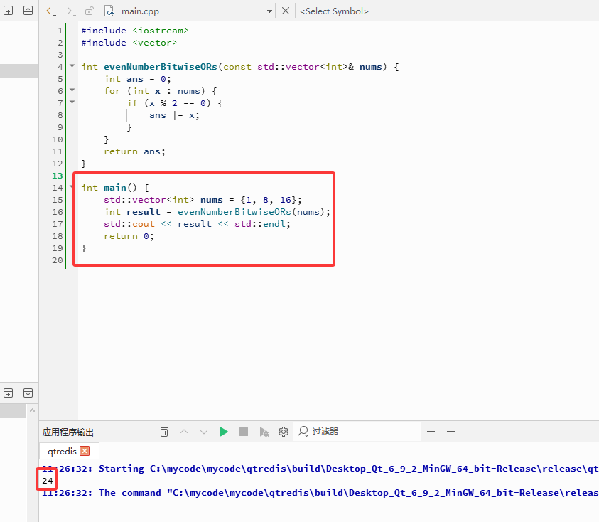

C++完整代码如下:
#include <iostream>
#include <vector>
int evenNumberBitwiseORs(const std::vector<int>& nums) {
    int ans = 0;
    for (int x : nums) {
        if (x % 2 == 0) {
            ans |= x;
    return ans;
int main() {
    std::vector<int> nums = {1, 8, 16};
    int result = evenNumberBitwiseORs(nums);
    std::cout << result << std::endl;
    return 0;
