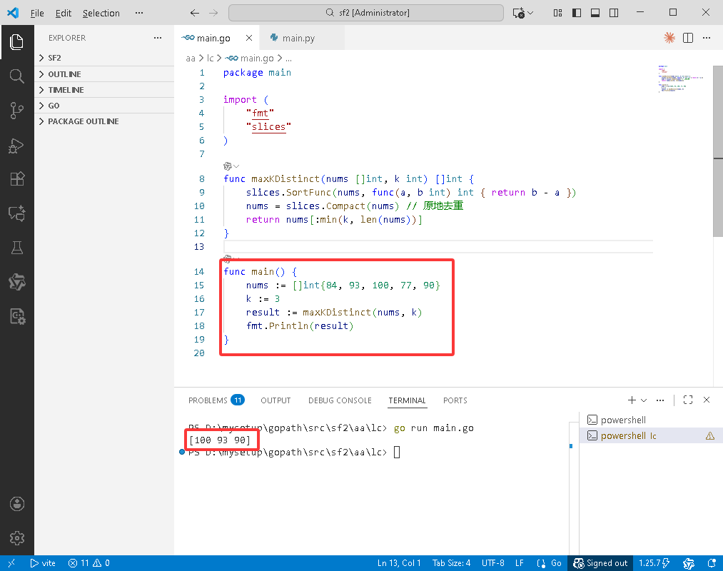

Go完整代码如下:
package main
import (
	"fmt"
	"slices"
func maxKDistinct(nums []int, k int) []int {
	slices.SortFunc(nums, func(a, b int) int { return b - a })
	nums = slices.Compact(nums) // 原地去重
	return nums[:min(k, len(nums))]
func main() {
	nums := []int{84, 93, 100, 77, 90}
	k := 3
	result := maxKDistinct(nums, k)
	fmt.Println(result)

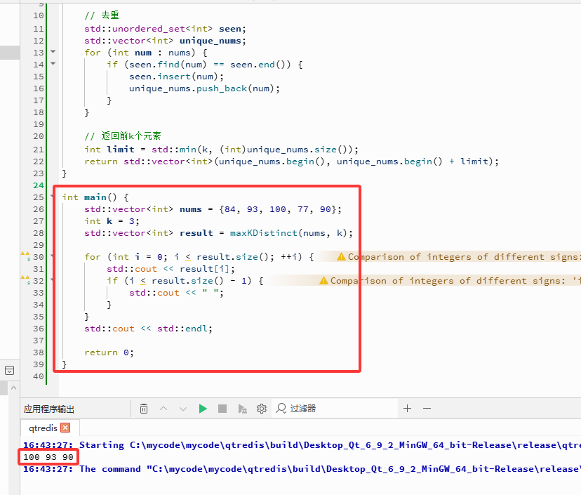

C++完整代码如下:
#include <iostream>
#include <vector>
#include <algorithm>
#include <unordered_set>
std::vector<int> maxKDistinct(std::vector<int> nums, int k) {
    // 降序排序
    std::sort(nums.begin(), nums.end(), std::greater<int>());
    // 去重
    std::unordered_set<int> seen;
    std::vector<int> unique_nums;
    for (int num : nums) {
        if (seen.find(num) == seen.end()) {
            seen.insert(num);
            unique_nums.push_back(num);
    // 返回前k个元素
    int limit = std::min(k, (int)unique_nums.size());
    return std::vector<int>(unique_nums.begin(), unique_nums.begin() + limit);
int main() {
    std::vector<int> nums = {84, 93, 100, 77, 90};
    int k = 3;
    std::vector<int> result = maxKDistinct(nums, k);
    for (int i = 0; i < result.size(); ++i) {
        std::cout << result[i];
        if (i < result.size() - 1) {
            std::cout << " ";
    std::cout << std::endl;
    return 0;
