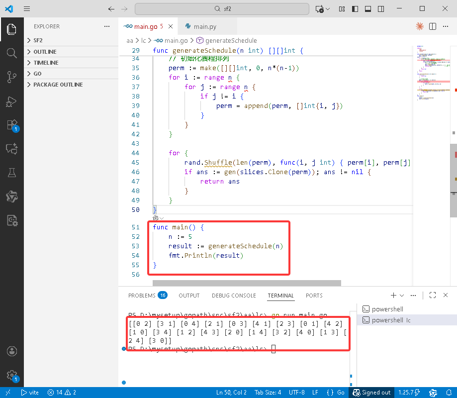

package main
import (
	"fmt"
	"math/rand/v2"
	"slices"
func gen(perm [][]int) (ans [][]int) {
	ans = append(ans, perm[0])
	perm = perm[1:]
next:
	for len(perm) > 0 {
		// 倒着遍历,这样删除的时候 i 更大,移动的数据少
		for i, p := range slices.Backward(perm) {
			last := ans[len(ans)-1]
			if p[0] != last[0] && p[0] != last[1] && p[1] != last[0] && p[1] != last[1] {
				// p 和上一场比赛无冲突
				ans = append(ans, p)
				perm = append(perm[:i], perm[i+1:]...) // 删除 perm[i]
				continue next                          // 找下一场比赛
		return nil
	return
func generateSchedule(n int) [][]int {
	if n < 5 {
		return nil
	// 初始化赛程排列
	perm := make([][]int, 0, n*(n-1))
	for i := range n {
		for j := range n {
			if j != i {
				perm = append(perm, []int{i, j})
	for {
		rand.Shuffle(len(perm), func(i, j int) { perm[i], perm[j] = perm[j], perm[i] })
		if ans := gen(slices.Clone(perm)); ans != nil {
			return ans
func main() {
	n := 5
	result := generateSchedule(n)
	fmt.Println(result)

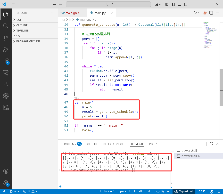

Python完整代码如下:
# -*-coding:utf-8-*-
import random
from typing import List, Optional
def gen(perm: List[List[int]]) -> Optional[List[List[int]]]:
    ans = [perm[0]]
    perm = perm[1:]
    while perm:
        found = False
        # 倒着遍历
        for i in range(len(perm) - 1, -1, -1):
            p = perm[i]
            last = ans[-1]
            if (p[0] != last[0] and p[0] != last[1] and
                p[1] != last[0] and p[1] != last[1]):
                # p 和上一场比赛无冲突
                ans.append(p)
                perm.pop(i)  # 删除 perm[i]
                found = True
                break
        if not found:
            return None
    return ans
def generate_schedule(n: int) -> Optional[List[List[int]]]:
    if n < 5:
        return None
    # 初始化赛程排列
    perm = []
    for i in range(n):
        for j in range(n):
            if j != i:
                perm.append([i, j])
    while True:
        random.shuffle(perm)
        perm_copy = perm.copy()
        result = gen(perm_copy)
        if result is not None:
            return result
def main():
    n = 5
    result = generate_schedule(n)
    print(result)
if __name__ == "__main__":
    main()

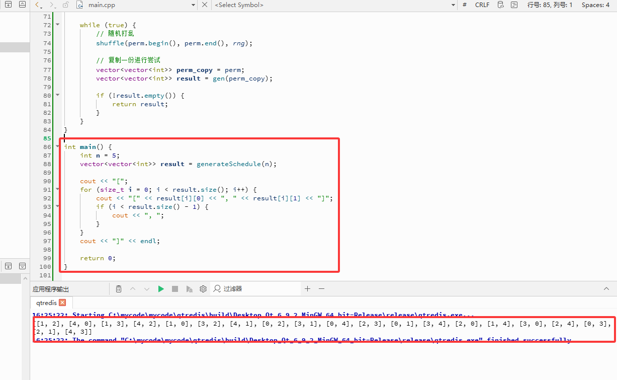

C++完整代码如下:
#include <iostream>
#include <vector>
#include <algorithm>
#include <random>
#include <chrono>
using namespace std;
// 生成倒序遍历的索引序列
vector<int> backward_indices(int size) {
    vector<int> indices(size);
    for (int i = 0; i < size; i++) {
        indices[i] = size - 1 - i;
    return indices;
vector<vector<int>> gen(vector<vector<int>> perm) {
    if (perm.empty()) return {};
    vector<vector<int>> ans;
    ans.push_back(perm[0]);
    perm.erase(perm.begin()); // 删除第一个元素
    while (!perm.empty()) {
        bool found = false;
        // 获取倒序遍历的索引
        vector<int> indices = backward_indices(perm.size());
        for (int i : indices) {
            const vector<int>& p = perm[i];
            const vector<int>& last = ans.back();
            if (p[0] != last[0] && p[0] != last[1] &&
                p[1] != last[0] && p[1] != last[1]) {
                // p 和上一场比赛无冲突
                ans.push_back(p);
                perm.erase(perm.begin() + i); // 删除 perm[i]
                found = true;
                break;
        if (!found) {
            return {};
    return ans;
vector<vector<int>> generateSchedule(int n) {
    if (n < 5) {
        return {};
    // 初始化赛程排列
    vector<vector<int>> perm;
    perm.reserve(n * (n - 1));
    for (int i = 0; i < n; i++) {
        for (int j = 0; j < n; j++) {
            if (j != i) {
                perm.push_back({i, j});
    // 使用随机数引擎
    unsigned seed = chrono::system_clock::now().time_since_epoch().count();
    mt19937 rng(seed);
    while (true) {
        // 随机打乱
        shuffle(perm.begin(), perm.end(), rng);
        // 复制一份进行尝试
        vector<vector<int>> perm_copy = perm;
        vector<vector<int>> result = gen(perm_copy);
        if (!result.empty()) {
            return result;
int main() {
    int n = 5;
    vector<vector<int>> result = generateSchedule(n);
    cout << "[";
    for (size_t i = 0; i < result.size(); i++) {
        cout << "[" << result[i][0] << ", " << result[i][1] << "]";
        if (i < result.size() - 1) {
            cout << ", ";
    cout << "]" << endl;
    return 0;
