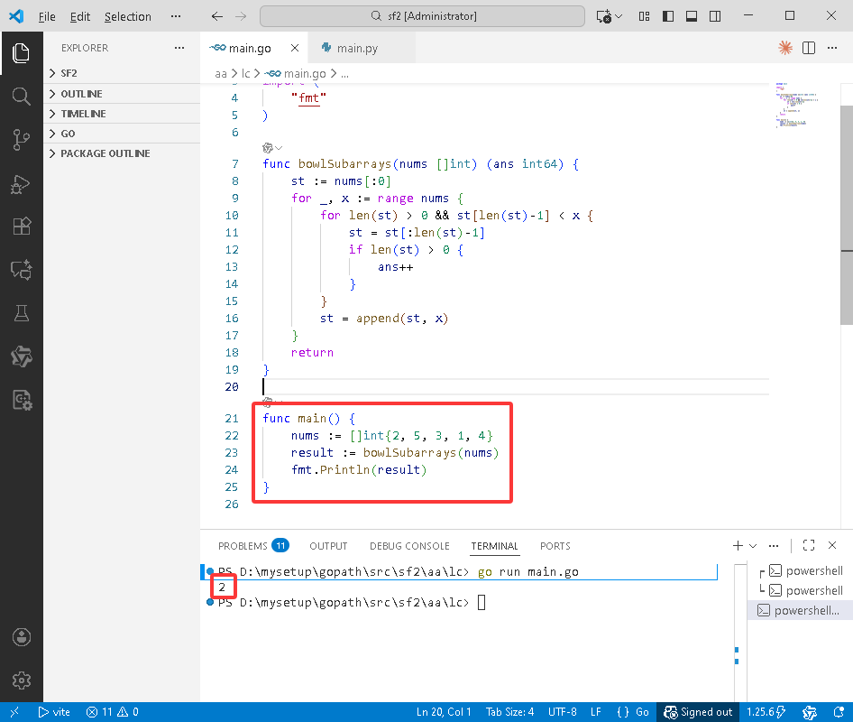

Go完整代码如下:
package main
import (
	"fmt"
func bowlSubarrays(nums []int) (ans int64) {
	st := nums[:0]
	for _, x := range nums {
		for len(st) > 0 && st[len(st)-1] < x {
			st = st[:len(st)-1]
			if len(st) > 0 {
				ans++
		st = append(st, x)
	return
func main() {
	nums := []int{2, 5, 3, 1, 4}
	result := bowlSubarrays(nums)
	fmt.Println(result)

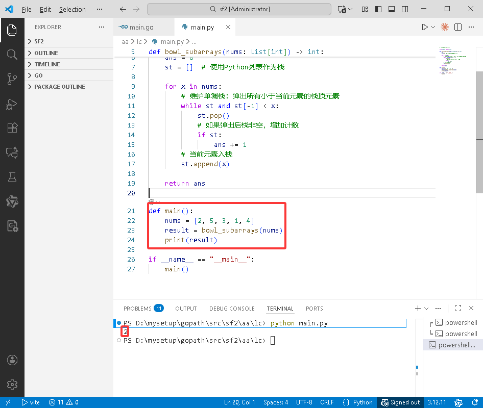

Python完整代码如下:
# -*-coding:utf-8-*-
from typing import List
def bowl_subarrays(nums: List[int]) -> int:
    ans = 0
    st = []  # 使用Python列表作为栈
    for x in nums:
        # 维护单调栈:弹出所有小于当前元素的栈顶元素
        while st and st[-1] < x:
            st.pop()
            # 如果弹出后栈非空,增加计数
            if st:
                ans += 1
        # 当前元素入栈
        st.append(x)
    return ans
def main():
    nums = [2, 5, 3, 1, 4]
    result = bowl_subarrays(nums)
    print(result)
if __name__ == "__main__":
    main()

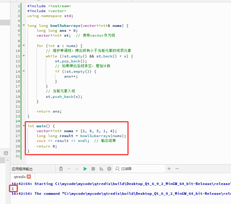

C++完整代码如下:
#include <iostream>
#include <vector>
using namespace std;
long long bowlSubarrays(vector<int>& nums) {
    long long ans = 0;
    vector<int> st;  // 使用vector作为栈
    for (int x : nums) {
        // 维护单调栈:弹出所有小于当前元素的栈顶元素
        while (!st.empty() && st.back() < x) {
            st.pop_back();
            // 如果弹出后栈非空,增加计数
            if (!st.empty()) {
                ans++;
        // 当前元素入栈
        st.push_back(x);
    return ans;
int main() {
    vector<int> nums = {2, 5, 3, 1, 4};
    long long result = bowlSubarrays(nums);
    cout << result << endl;  // 输出结果
    return 0;
