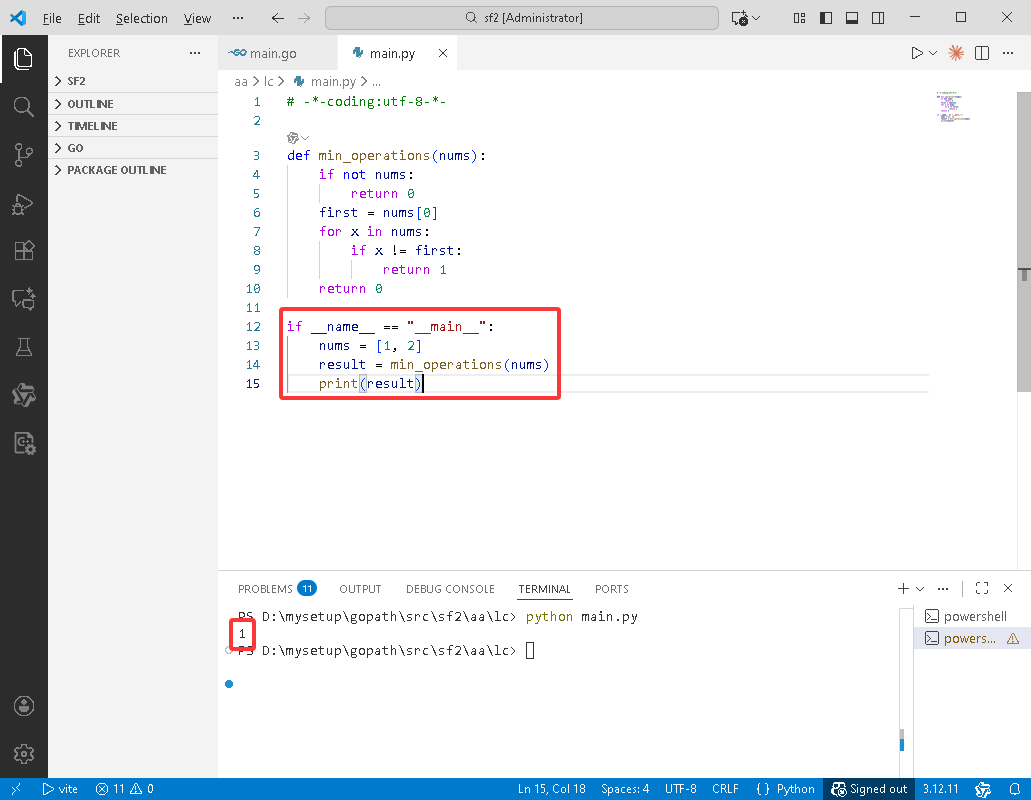

Python完整代码如下:
# -*-coding:utf-8-*-
def min_operations(nums):
    if not nums:
        return 0
    first = nums[0]
    for x in nums:
        if x != first:
            return 1
    return 0
if __name__ == "__main__":
    nums = [1, 2]
    result = min_operations(nums)
    print(result)

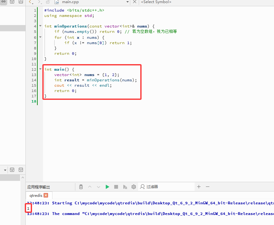

C++完整代码如下:
#include <bits/stdc++.h>
using namespace std;
int minOperations(const vector<int>& nums) {
    if (nums.empty()) return 0; // 若为空数组,视为已相等
    for (int x : nums) {
        if (x != nums[0]) return 1;
    return 0;
int main() {
    vector<int> nums = {1, 2};
    int result = minOperations(nums);
    cout << result << endl;
    return 0;
