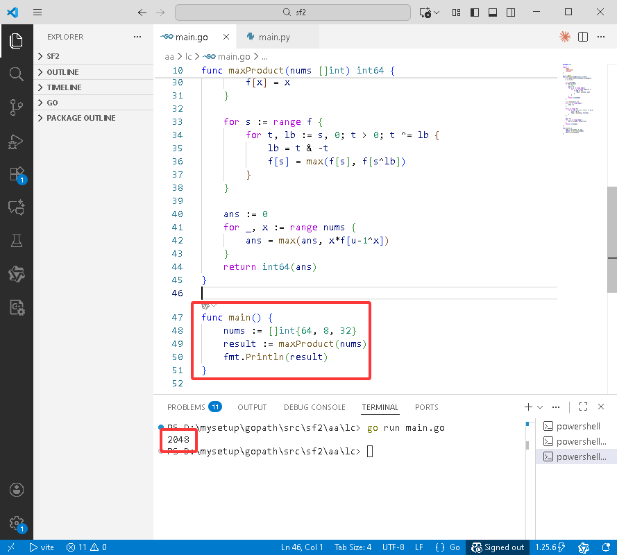

Go完整代码如下:
package main
import (
	"fmt"
	"math/bits"
	"slices"
// 基于方法一
func maxProduct(nums []int) int64 {
	w := bits.Len(uint(slices.Max(nums)))
	u := 1 << w
	n := len(nums)
	if n*n <= u*w {
		// 暴力
		ans := 0
		for i, x := range nums {
			for _, y := range nums[:i] {
				if x&y == 0 {
					ans = max(ans, x*y)
		return int64(ans)
	f := make([]int, u)
	for _, x := range nums {
		f[x] = x
	for s := range f {
		for t, lb := s, 0; t > 0; t ^= lb {
			lb = t & -t
			f[s] = max(f[s], f[s^lb])
	ans := 0
		ans = max(ans, x*f[u-1^x])
	return int64(ans)
func main() {
	nums := []int{64, 8, 32}
	result := maxProduct(nums)
	fmt.Println(result)

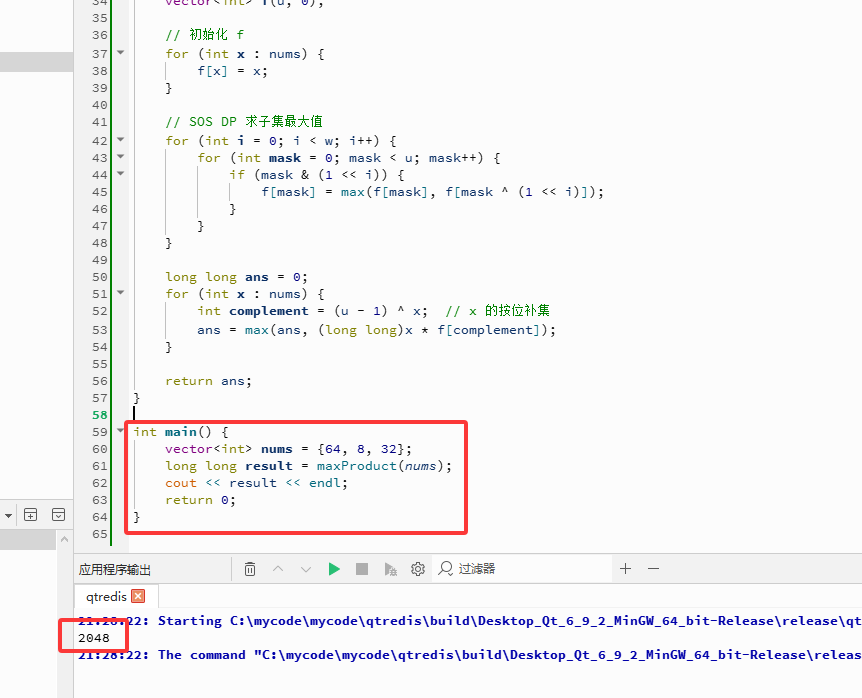

C++完整代码如下:
#include <iostream>
#include <vector>
#include <algorithm>
#include <bitset>
#include <climits>
using namespace std;
long long maxProduct(vector<int>& nums) {
    int max_val = *max_element(nums.begin(), nums.end());
    int w = 0;
    while (max_val > 0) {
        w++;
        max_val >>= 1;
    int u = 1 << w;  // 2^w
    int n = nums.size();
    // 情况一:暴力枚举
    if (n * n <= u * w) {
        long long ans = 0;
        for (int i = 0; i < n; i++) {
            for (int j = 0; j < i; j++) {
                if ((nums[i] & nums[j]) == 0) {
                    ans = max(ans, (long long)nums[i] * nums[j]);
        return ans;
    // 情况二:SOS DP
    vector<int> f(u, 0);
    // 初始化 f
    for (int x : nums) {
        f[x] = x;
    // SOS DP 求子集最大值
    for (int i = 0; i < w; i++) {
        for (int mask = 0; mask < u; mask++) {
            if (mask & (1 << i)) {
                f[mask] = max(f[mask], f[mask ^ (1 << i)]);
    long long ans = 0;
        int complement = (u - 1) ^ x;  // x 的按位补集
        ans = max(ans, (long long)x * f[complement]);
    return ans;
int main() {
    vector<int> nums = {64, 8, 32};
    long long result = maxProduct(nums);
    cout << result << endl;
    return 0;
