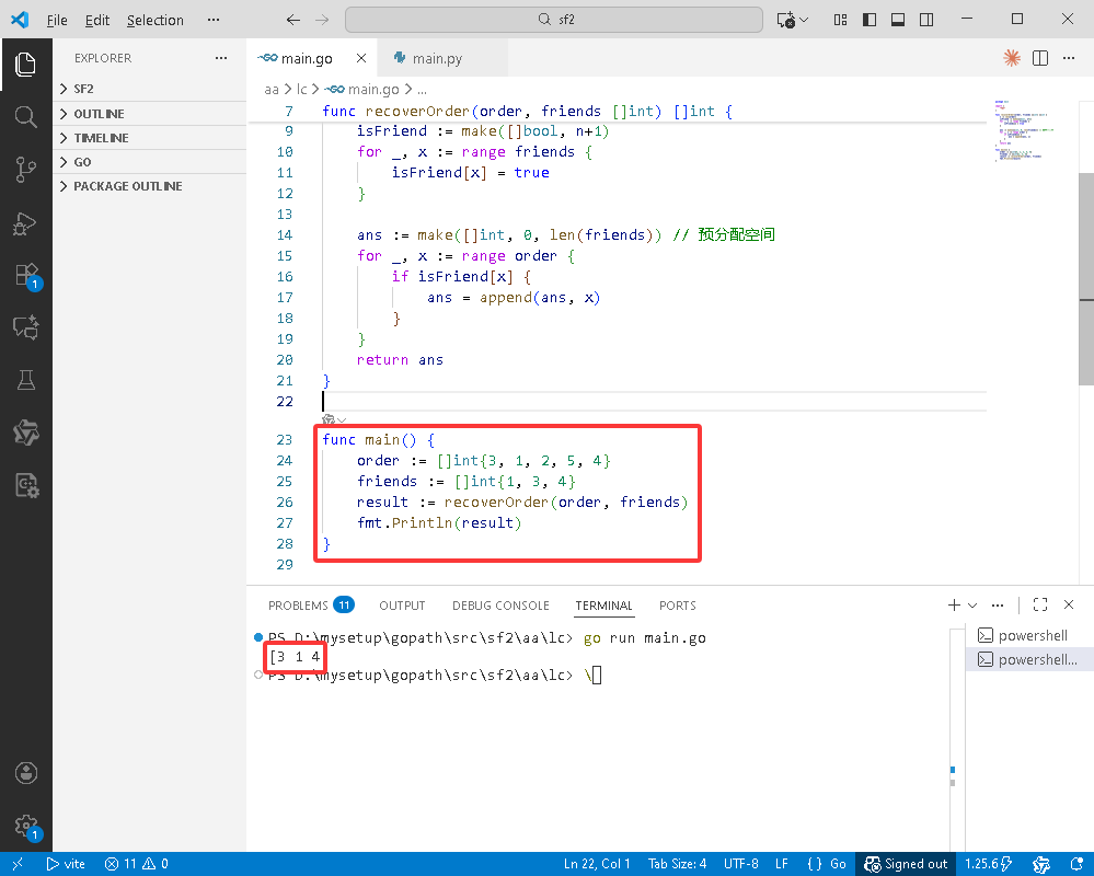

Go完整代码如下:
package main
import (
	"fmt"
func recoverOrder(order, friends []int) []int {
	n := len(order)
	isFriend := make([]bool, n+1)
	for _, x := range friends {
		isFriend[x] = true
	ans := make([]int, 0, len(friends)) // 预分配空间
	for _, x := range order {
		if isFriend[x] {
			ans = append(ans, x)
	return ans
func main() {
	order := []int{3, 1, 2, 5, 4}
	friends := []int{1, 3, 4}
	result := recoverOrder(order, friends)
	fmt.Println(result)

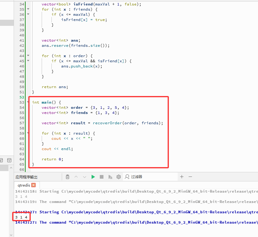

C++完整代码如下:
#include <iostream>
#include <vector>
#include <unordered_set>
using namespace std;
vector<int> recoverOrder(const vector<int>& order, const vector<int>& friends) {
    // 使用哈希集合的方法(更高效)
    unordered_set<int> friendSet(friends.begin(), friends.end());
    vector<int> ans;
    ans.reserve(friends.size()); // 预分配空间
    for (int x : order) {
        if (friendSet.find(x) != friendSet.end()) {
            ans.push_back(x);
    return ans;
// 如果要用类似Go版本的布尔数组方法(要求数值范围不大)
vector<int> recoverOrderBoolArray(const vector<int>& order, const vector<int>& friends) {
    // 找到最大值来确定数组大小
    int maxVal = 0;
        if (x > maxVal) maxVal = x;
    for (int x : friends) {
    vector<bool> isFriend(maxVal + 1, false);
        if (x <= maxVal) {
            isFriend[x] = true;
    vector<int> ans;
        if (x <= maxVal && isFriend[x]) {
            ans.push_back(x);
    return ans;
int main() {
    vector<int> order = {3, 1, 2, 5, 4};
    vector<int> friends = {1, 3, 4};
    vector<int> result = recoverOrder(order, friends);
    for (int x : result) {
        cout << x << " ";
    cout << endl;
    return 0;
