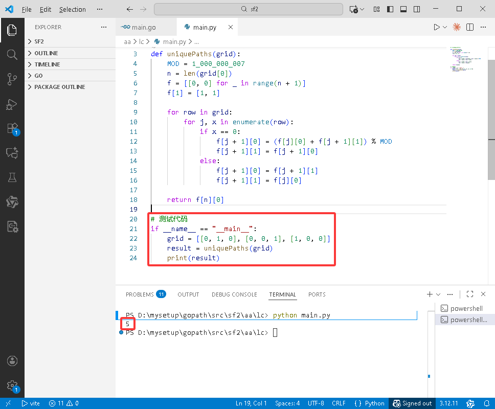

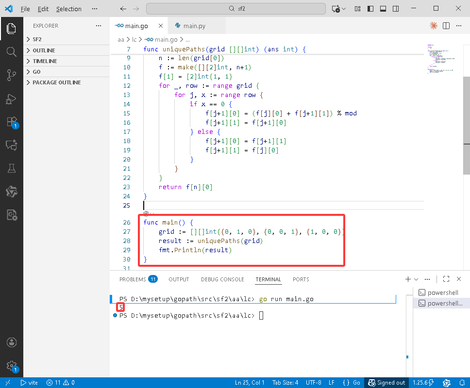

Go完整代码如下:
package main
import (
	"fmt"
func uniquePaths(grid [][]int) (ans int) {
	const mod = 1_000_000_007
	n := len(grid[0])
	f := make([][2]int, n+1)
	f[1] = [2]int{1, 1}
	for _, row := range grid {
		for j, x := range row {
			if x == 0 {
				f[j+1][0] = (f[j][0] + f[j+1][1]) % mod
				f[j+1][1] = f[j+1][0]
			} else {
				f[j+1][0] = f[j+1][1]
				f[j+1][1] = f[j][0]
	return f[n][0]
func main() {
	grid := [][]int{{0, 1, 0}, {0, 0, 1}, {1, 0, 0}}
	result := uniquePaths(grid)
	fmt.Println(result)
Python完整代码如下:
# -*-coding:utf-8-*-
def uniquePaths(grid):
    MOD = 1_000_000_007
    n = len(grid[0])
    f = [[0, 0] for _ in range(n + 1)]
    f[1] = [1, 1]
    for row in grid:
        for j, x in enumerate(row):
            if x == 0:
                f[j + 1][0] = (f[j][0] + f[j + 1][1]) % MOD
                f[j + 1][1] = f[j + 1][0]
            else:
                f[j + 1][0] = f[j + 1][1]
                f[j + 1][1] = f[j][0]
    return f[n][0]
# 测试代码
if __name__ == "__main__":
    grid = [[0, 1, 0], [0, 0, 1], [1, 0, 0]]
    result = uniquePaths(grid)
    print(result)
