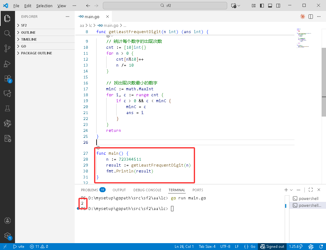

Go完整代码如下:
package main
import (
	"fmt"
	"math"
func getLeastFrequentDigit(n int) (ans int) {
	// 统计每个数字的出现次数
	cnt := [10]int{}
	for n > 0 {
		cnt[n%10]++
		n /= 10
	// 找出现次数最小的数字
	minC := math.MaxInt
	for i, c := range cnt {
		if c > 0 && c < minC {
			minC = c
			ans = i
	return
func main() {
	n := 723344511
	result := getLeastFrequentDigit(n)
	fmt.Println(result)

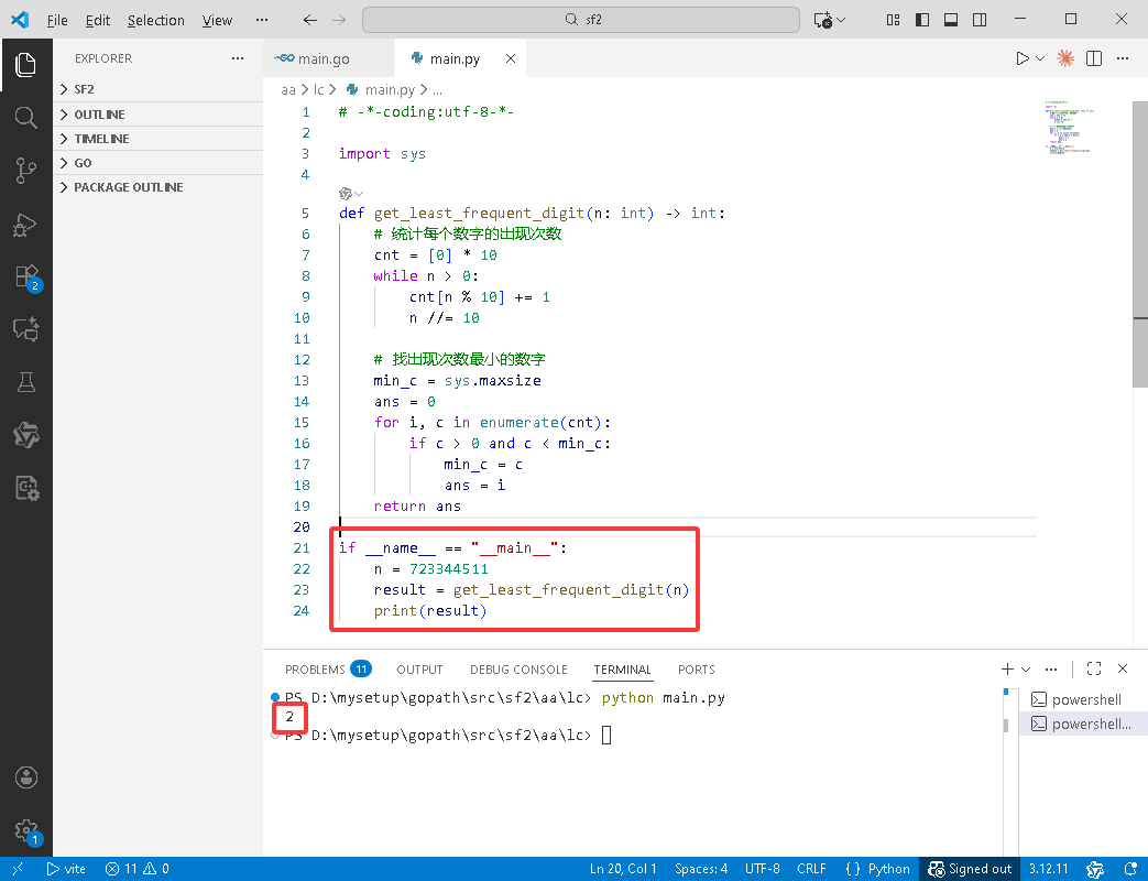

Python完整代码如下:
# -*-coding:utf-8-*-
import sys
def get_least_frequent_digit(n: int) -> int:
    # 统计每个数字的出现次数
    cnt = [0] * 10
    while n > 0:
        cnt[n % 10] += 1
        n //= 10
    # 找出现次数最小的数字
    min_c = sys.maxsize
    ans = 0
    for i, c in enumerate(cnt):
        if c > 0 and c < min_c:
            min_c = c
            ans = i
    return ans
if __name__ == "__main__":
    n = 723344511
    result = get_least_frequent_digit(n)
    print(result)

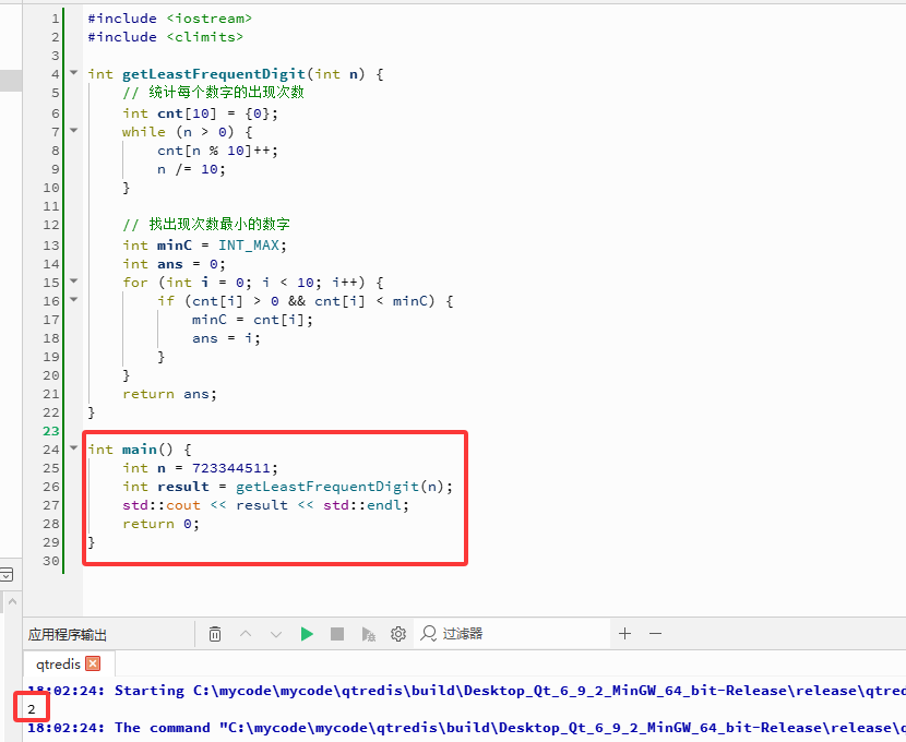

C++完整代码如下:
#include <iostream>
#include <climits>
int getLeastFrequentDigit(int n) {
    // 统计每个数字的出现次数
    int cnt[10] = {0};
    while (n > 0) {
        cnt[n % 10]++;
        n /= 10;
    // 找出现次数最小的数字
    int minC = INT_MAX;
    int ans = 0;
    for (int i = 0; i < 10; i++) {
        if (cnt[i] > 0 && cnt[i] < minC) {
            minC = cnt[i];
            ans = i;
    return ans;
int main() {
    int n = 723344511;
    int result = getLeastFrequentDigit(n);
    std::cout << result << std::endl;
    return 0;
