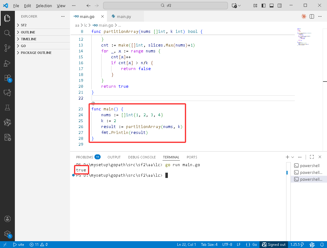

Go完整代码如下:
package main
import (
	"fmt"
	"slices"
func partitionArray(nums []int, k int) bool {
	n := len(nums)
	if n%k > 0 {
		return false
	cnt := make([]int, slices.Max(nums)+1)
	for _, x := range nums {
		cnt[x]++
		if cnt[x] > n/k {
			return false
	return true
func main() {
	nums := []int{1, 2, 3, 4}
	k := 2
	result := partitionArray(nums, k)
	fmt.Println(result)

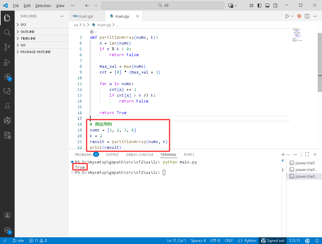

Python完整代码如下:
# -*-coding:utf-8-*-
def partitionArray(nums, k):
    n = len(nums)
    if n % k > 0:
        return False
    max_val = max(nums)
    cnt = [0] * (max_val + 1)
    for x in nums:
        cnt[x] += 1
        if cnt[x] > n // k:
            return False
    return True
# 测试用例
nums = [1, 2, 3, 4]
k = 2
result = partitionArray(nums, k)
print(result)

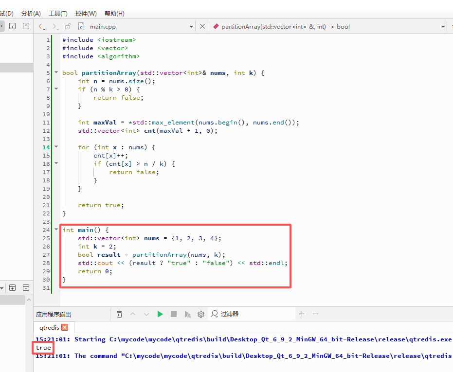

C++完整代码如下:
#include <iostream>
#include <vector>
#include <algorithm>
bool partitionArray(std::vector<int>& nums, int k) {
    int n = nums.size();
    if (n % k > 0) {
        return false;
    int maxVal = *std::max_element(nums.begin(), nums.end());
    std::vector<int> cnt(maxVal + 1, 0);
    for (int x : nums) {
        cnt[x]++;
        if (cnt[x] > n / k) {
            return false;
    return true;
int main() {
    std::vector<int> nums = {1, 2, 3, 4};
    int k = 2;
    bool result = partitionArray(nums, k);
    std::cout << (result ? "true" : "false") << std::endl;
    return 0;
