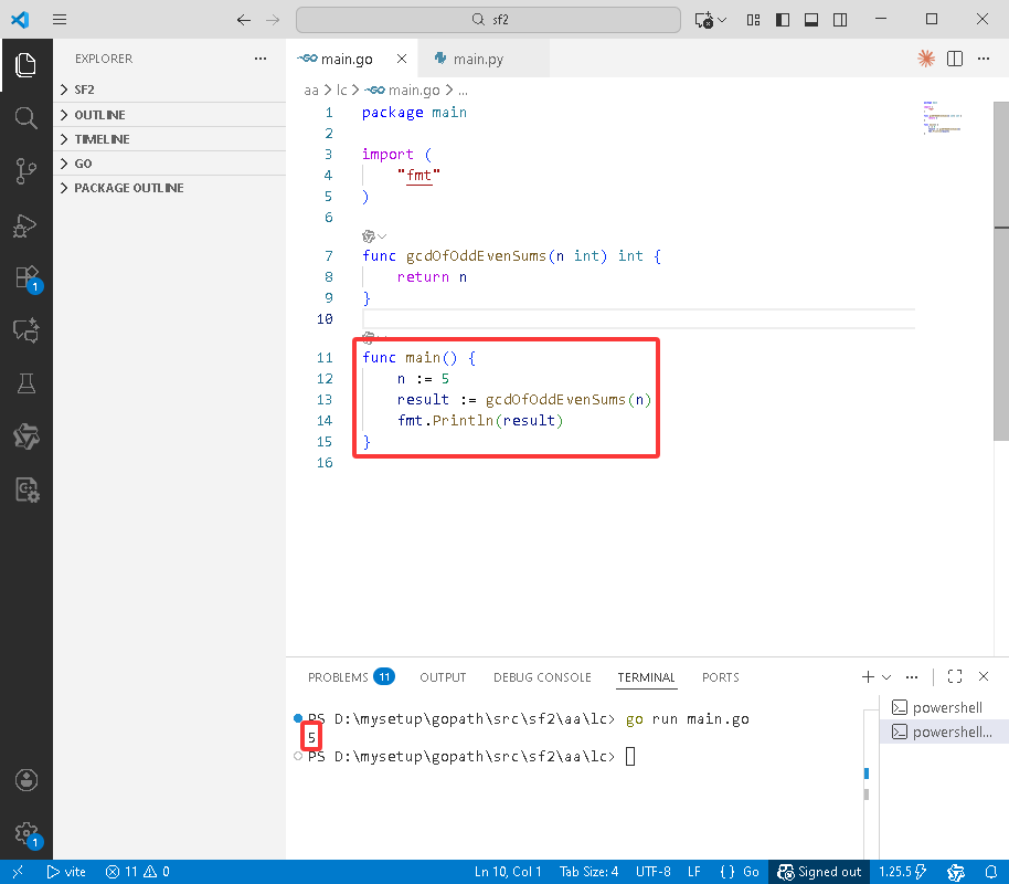

Go完整代码如下:
package main
import (
	"fmt"
func gcdOfOddEvenSums(n int) int {
	return n
func main() {
	n := 5
	result := gcdOfOddEvenSums(n)
	fmt.Println(result)

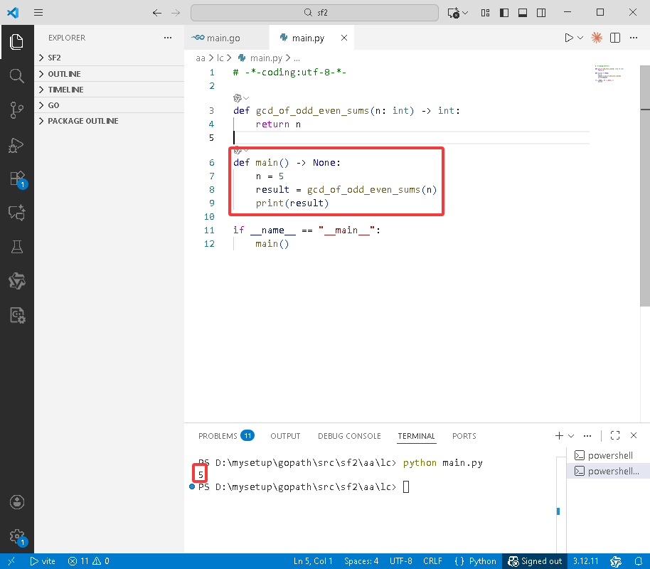

Python完整代码如下:
# -*-coding:utf-8-*-
def gcd_of_odd_even_sums(n: int) -> int:
    return n
def main() -> None:
    n = 5
    result = gcd_of_odd_even_sums(n)
    print(result)
if __name__ == "__main__":
    main()

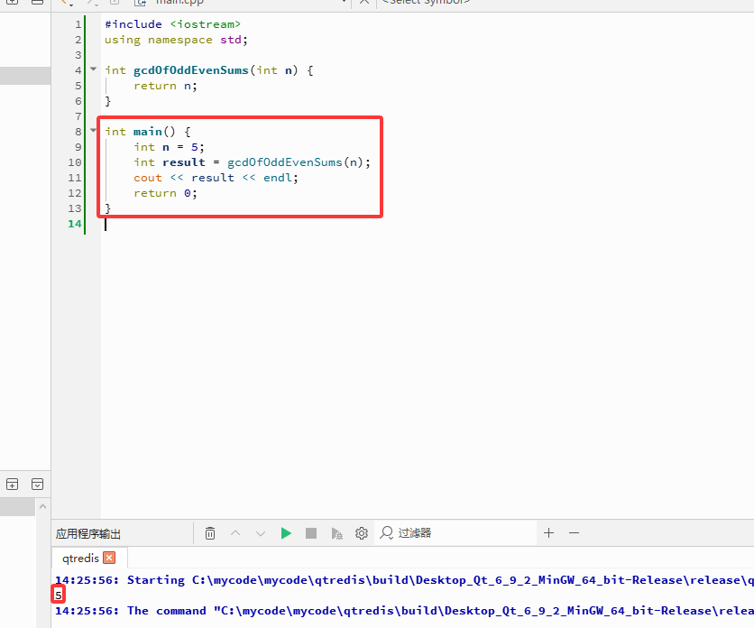

C++完整代码如下:
#include <iostream>
using namespace std;
int gcdOfOddEvenSums(int n) {
    return n;
int main() {
    int n = 5;
    int result = gcdOfOddEvenSums(n);
    cout << result << endl;
    return 0;
