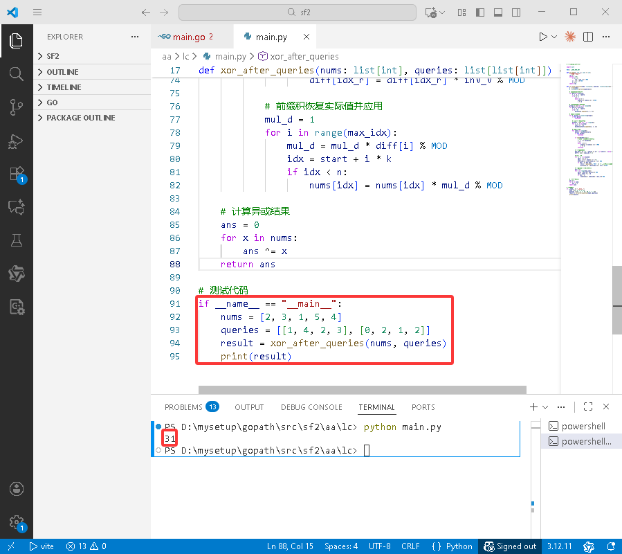

    # 计算异或结果
    ans = 0
    for x in nums:
        ans ^= x
    return ans
# 测试代码
if __name__ == "__main__":
    nums = [2, 3, 1, 5, 4]
    queries = [[1, 4, 2, 3], [0, 2, 1, 2]]
    result = xor_after_queries(nums, queries)
    print(result)
