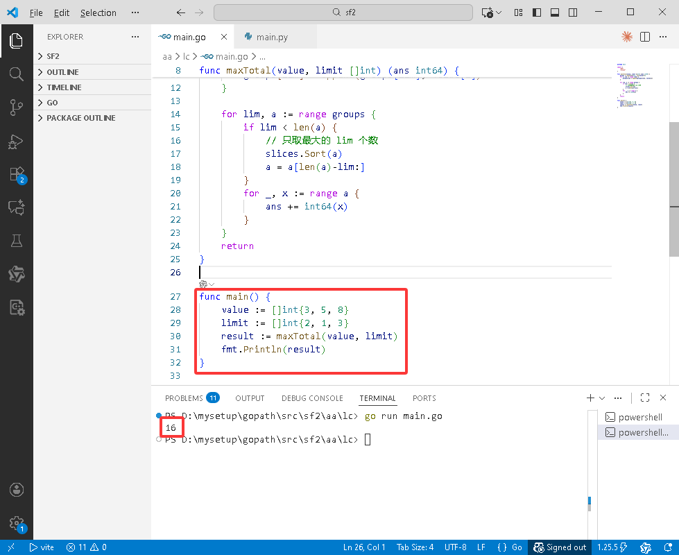

Go完整代码如下:
package main
import (
	"fmt"
	"slices"
func maxTotal(value, limit []int) (ans int64) {
	groups := make([][]int, len(value)+1)
	for i, lim := range limit {
		groups[lim] = append(groups[lim], value[i])
	for lim, a := range groups {
		if lim < len(a) {
			// 只取最大的 lim 个数
			slices.Sort(a)
			a = a[len(a)-lim:]
		for _, x := range a {
			ans += int64(x)
	return
func main() {
	value := []int{3, 5, 8}
	limit := []int{2, 1, 3}
	result := maxTotal(value, limit)
	fmt.Println(result)

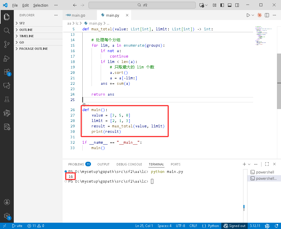

Python完整代码如下:
# -*-coding:utf-8-*-
from typing import List
def max_total(value: List[int], limit: List[int]) -> int:
    ans = 0
    n = len(value)
    groups = [[] for _ in range(n + 1)]
    # 按照 limit 分组
    for i in range(n):
        groups[limit[i]].append(value[i])
    # 处理每个分组
    for lim, a in enumerate(groups):
        if not a:
            continue
        if lim < len(a):
            # 只取最大的 lim 个数
            a.sort()
            a = a[-lim:]
        ans += sum(a)
    return ans
def main():
    value = [3, 5, 8]
    limit = [2, 1, 3]
    result = max_total(value, limit)
    print(result)
if __name__ == "__main__":
    main()

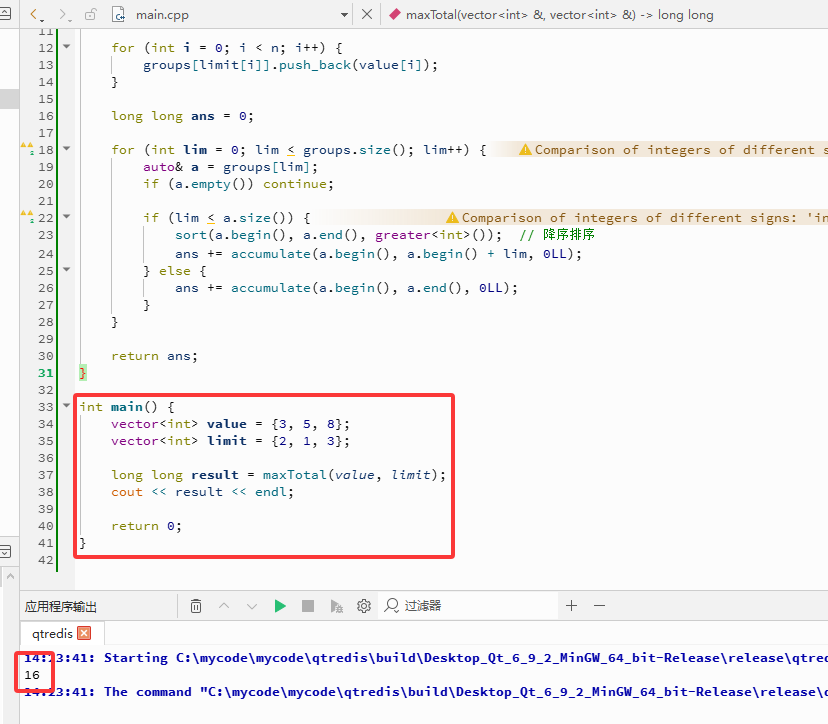

C++完整代码如下:
#include <iostream>
#include <vector>
#include <algorithm>
#include <numeric>
using namespace std;
long long maxTotal(vector<int>& value, vector<int>& limit) {
    int n = value.size();
    vector<vector<int>> groups(n + 1);
    for (int i = 0; i < n; i++) {
        groups[limit[i]].push_back(value[i]);
    long long ans = 0;
    for (int lim = 0; lim < groups.size(); lim++) {
        auto& a = groups[lim];
        if (a.empty()) continue;
        if (lim < a.size()) {
            sort(a.begin(), a.end(), greater<int>());  // 降序排序
            ans += accumulate(a.begin(), a.begin() + lim, 0LL);
        } else {
            ans += accumulate(a.begin(), a.end(), 0LL);
    return ans;
int main() {
    vector<int> value = {3, 5, 8};
    vector<int> limit = {2, 1, 3};
    long long result = maxTotal(value, limit);
    cout << result << endl;
    return 0;
