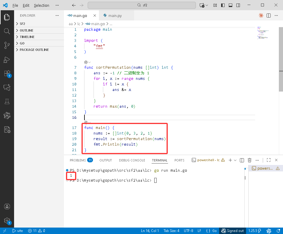

Go完整代码如下:
package main
import (
	"fmt"
func sortPermutation(nums []int) int {
	ans := -1 // 二进制全为 1
	for i, x := range nums {
		if i != x {
			ans &= x
	return max(ans, 0)
func main() {
	nums := []int{0, 3, 2, 1}
	result := sortPermutation(nums)
	fmt.Println(result)

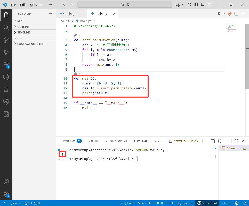

Python完整代码如下:
# -*-coding:utf-8-*-
def sort_permutation(nums):
    ans = -1  # 二进制全为 1
    for i, x in enumerate(nums):
        if i != x:
            ans &= x
    return max(ans, 0)
def main():
    nums = [0, 3, 2, 1]
    result = sort_permutation(nums)
    print(result)
if __name__ == "__main__":
    main()

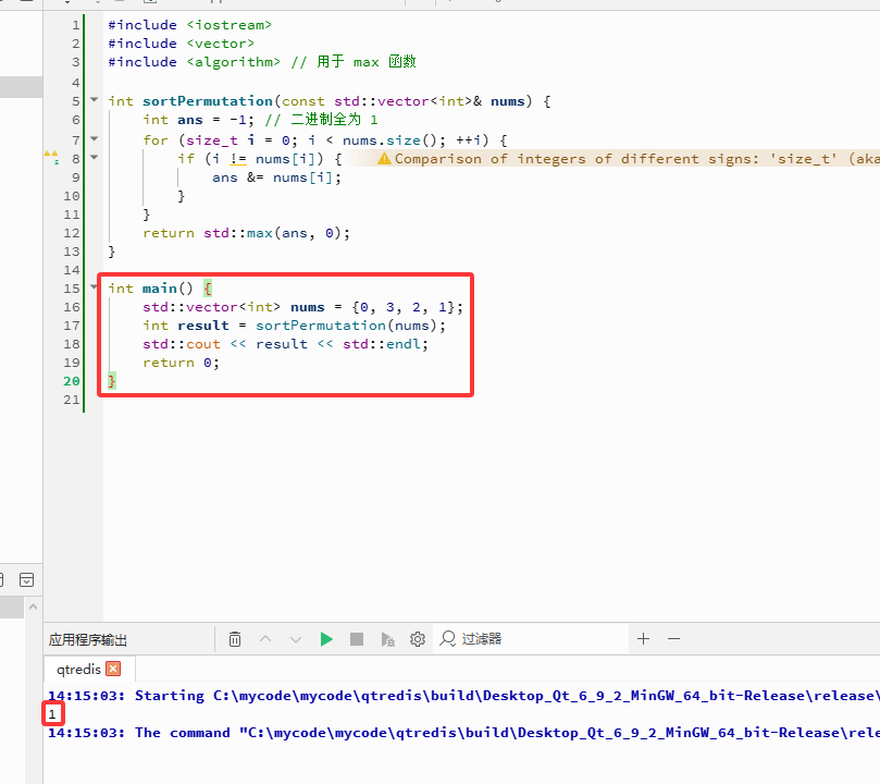

C++完整代码如下:
#include <iostream>
#include <vector>
#include <algorithm> // 用于 max 函数
int sortPermutation(const std::vector<int>& nums) {
    int ans = -1; // 二进制全为 1
    for (size_t i = 0; i < nums.size(); ++i) {
        if (i != nums[i]) {
            ans &= nums[i];
    return std::max(ans, 0);
int main() {
    std::vector<int> nums = {0, 3, 2, 1};
    int result = sortPermutation(nums);
    std::cout << result << std::endl;
    return 0;
