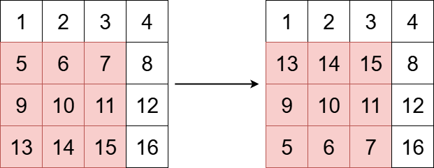

输入: grid = [[1,2,3,4],[5,6,7,8],[9,10,11,12],[13,14,15,16]], x = 1, y = 0, k = 3。
输出: [[1,2,3,4],[13,14,15,8],[9,10,11,12],[5,6,7,16]]。
解释:
上图展示了矩阵在变换前后的样子。

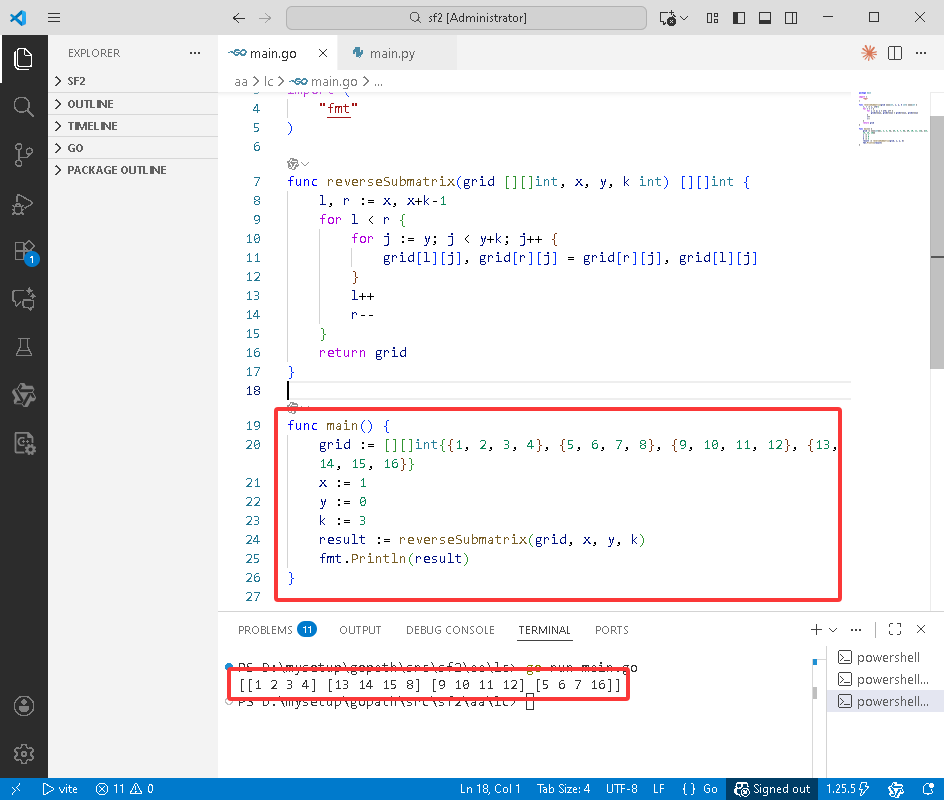

Go完整代码如下:
package main
import (
	"fmt"
func reverseSubmatrix(grid [][]int, x, y, k int) [][]int {
	l, r := x, x+k-1
	for l < r {
		for j := y; j < y+k; j++ {
			grid[l][j], grid[r][j] = grid[r][j], grid[l][j]
		l++
		r--
	return grid
func main() {
	grid := [][]int{{1, 2, 3, 4}, {5, 6, 7, 8}, {9, 10, 11, 12}, {13, 14, 15, 16}}
	x := 1
	y := 0
	k := 3
	result := reverseSubmatrix(grid, x, y, k)
	fmt.Println(result)

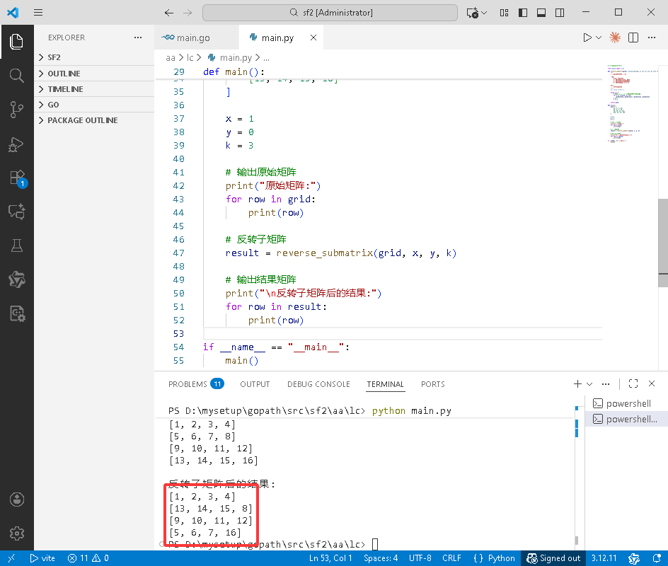

Python完整代码如下:
# -*-coding:utf-8-*-
from typing import List
def reverse_submatrix(grid: List[List[int]], x: int, y: int, k: int) -> List[List[int]]:
    反转指定子矩阵的行顺序
    参数:
        grid: 输入矩阵
        x: 子矩阵左上角的行索引
        y: 子矩阵左上角的列索引
        k: 子矩阵的大小(k × k)
    返回:
        修改后的矩阵
    l, r = x, x + k - 1
    while l < r:
        # 交换第l行和第r行在子矩阵范围内的元素
        for j in range(y, y + k):
        l += 1
        r -= 1
    return grid
def main():
    grid = [
        [1, 2, 3, 4],
        [5, 6, 7, 8],
        [9, 10, 11, 12],
        [13, 14, 15, 16]
    x = 1
    y = 0
    k = 3
    # 输出原始矩阵
    print("原始矩阵:")
    for row in grid:
        print(row)
    # 反转子矩阵
    result = reverse_submatrix(grid, x, y, k)
    # 输出结果矩阵
    print("\n反转子矩阵后的结果:")
    for row in result:
        print(row)
if __name__ == "__main__":
    main()
