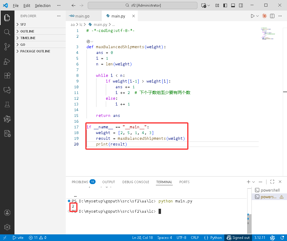

def maxBalancedShipments(weight):
    ans = 0
    i = 1
    n = len(weight)
    while i < n:
        if weight[i-1] > weight[i]:
            ans += 1
            i += 2  # 下个子数组至少要有两个数
        else:
            i += 1
    return ans
if __name__ == "__main__":
    weight = [2, 5, 1, 4, 3]
    result = maxBalancedShipments(weight)
    print(result)

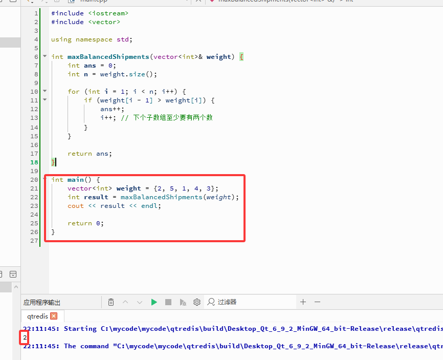

int maxBalancedShipments(vector<int>& weight) {
    int ans = 0;
    int n = weight.size();
    for (int i = 1; i < n; i++) {
        if (weight[i - 1] > weight[i]) {
            ans++;
            i++; // 下个子数组至少要有两个数
    return ans;
int main() {
    vector<int> weight = {2, 5, 1, 4, 3};
    int result = maxBalancedShipments(weight);
    cout << result << endl;
    return 0;
