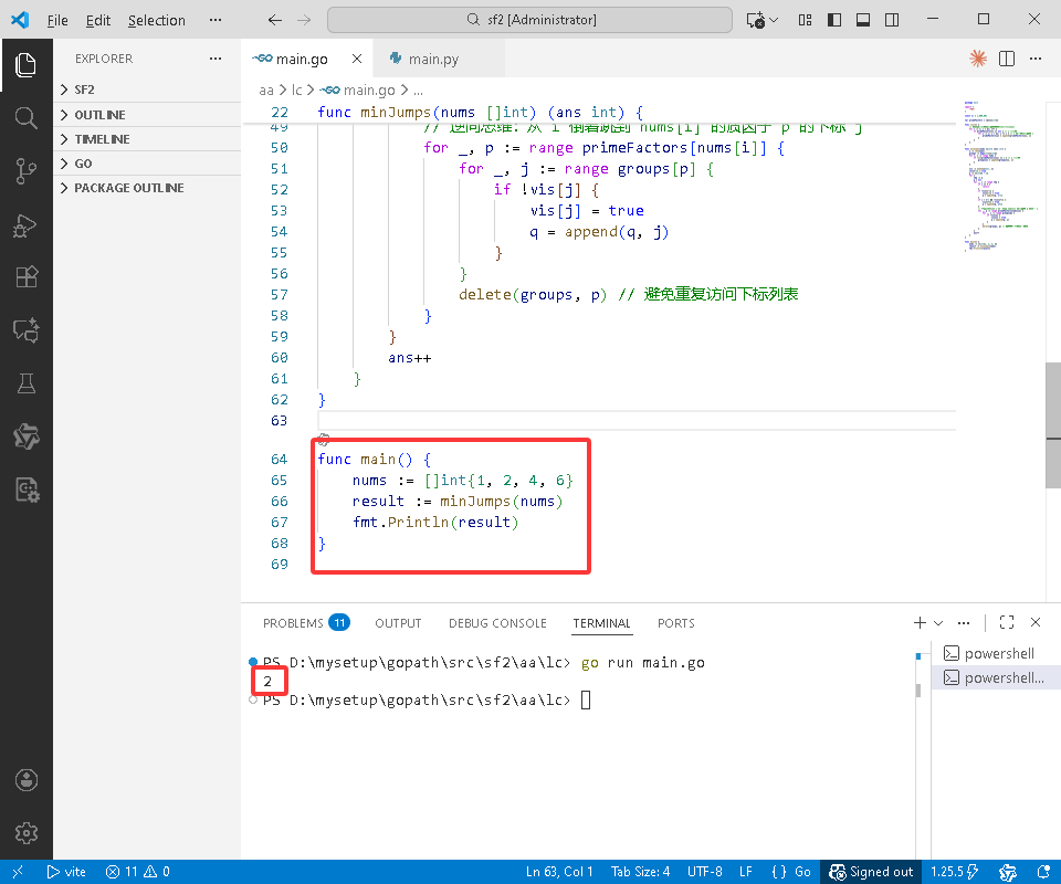

Go完整代码如下:
package main
import (
	"fmt"
const mx = 1_000_001
var primeFactors = [mx][]int{}
func init() {
	// 预处理每个数的质因子列表,思路同埃氏筛
	for i := 2; i < mx; i++ {
		if primeFactors[i] == nil { // i 是质数
			for j := i; j < mx; j += i { // i 的倍数有质因子 i
				primeFactors[j] = append(primeFactors[j], i)
func minJumps(nums []int) (ans int) {
	n := len(nums)
	groups := map[int][]int{}
	for i, x := range nums {
		if len(primeFactors[x]) == 1 { // x 是质数
			groups[x] = append(groups[x], i)
	vis := make([]bool, n)
	vis[n-1] = true
	q := []int{n - 1}
	for {
		tmp := q
		q = nil
		for _, i := range tmp {
			if i == 0 {
				return
			if !vis[i-1] {
				vis[i-1] = true
				q = append(q, i-1)
			if i < n-1 && !vis[i+1] {
				vis[i+1] = true
				q = append(q, i+1)
			// 逆向思维:从 i 倒着跳到 nums[i] 的质因子 p 的下标 j
			for _, p := range primeFactors[nums[i]] {
				for _, j := range groups[p] {
					if !vis[j] {
						vis[j] = true
						q = append(q, j)
				delete(groups, p) // 避免重复访问下标列表
		ans++
func main() {
	nums := []int{1, 2, 4, 6}
	result := minJumps(nums)
	fmt.Println(result)
