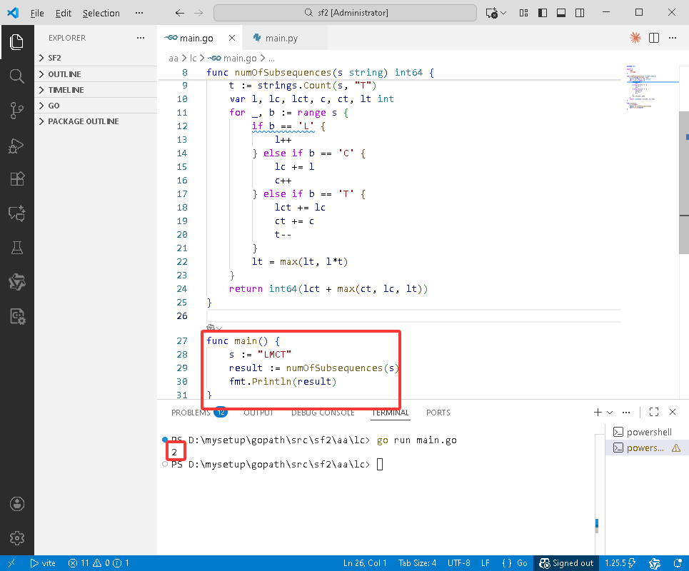

Go完整代码如下:
package main
import (
	"fmt"
	"strings"
func numOfSubsequences(s string) int64 {
	t := strings.Count(s, "T")
	var l, lc, lct, c, ct, lt int
	for _, b := range s {
		if b == 'L' {
			l++
		} else if b == 'C' {
			lc += l
			c++
		} else if b == 'T' {
			lct += lc
			ct += c
			t--
		lt = max(lt, l*t)
	return int64(lct + max(ct, lc, lt))
func main() {
	s := "LMCT"
	result := numOfSubsequences(s)
	fmt.Println(result)

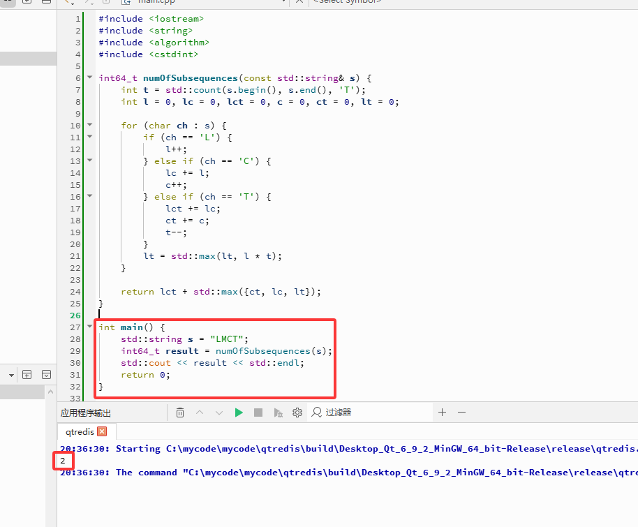

C++完整代码如下:
#include <iostream>
#include <string>
#include <algorithm>
#include <cstdint>
int64_t numOfSubsequences(const std::string& s) {
    int t = std::count(s.begin(), s.end(), 'T');
    int l = 0, lc = 0, lct = 0, c = 0, ct = 0, lt = 0;
    for (char ch : s) {
        if (ch == 'L') {
            l++;
        } else if (ch == 'C') {
            lc += l;
            c++;
        } else if (ch == 'T') {
            lct += lc;
            ct += c;
            t--;
        lt = std::max(lt, l * t);
    return lct + std::max({ct, lc, lt});
int main() {
    std::string s = "LMCT";
    int64_t result = numOfSubsequences(s);
    std::cout << result << std::endl;
    return 0;
