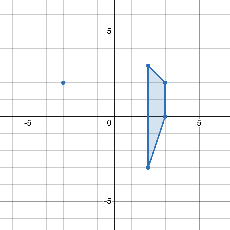

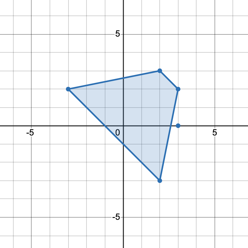

有两种不同方式选择四个点组成一个梯形:
点 [-3,2], [2,3], [3,2], [2,-3] 组成一个梯形。
点 [2,3], [3,2], [3,0], [2,-3] 组成另一个梯形。

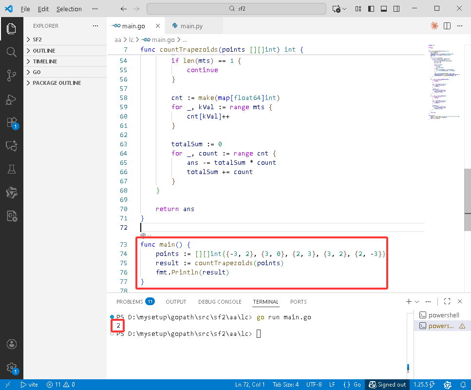

Go完整代码如下:
package main
import (
	"fmt"
func countTrapezoids(points [][]int) int {
	n := len(points)
	inf := 1e9 + 7
	slopeToIntercept := make(map[float64][]float64)
	midToSlope := make(map[float64][]float64)
	ans := 0
	for i := 0; i < n; i++ {
		x1, y1 := points[i][0], points[i][1]
		for j := i + 1; j < n; j++ {
			x2, y2 := points[j][0], points[j][1]
			dx := x1 - x2
			dy := y1 - y2
			var k, b float64
			if x2 == x1 {
				k = inf
				b = float64(x1)
			} else {
				k = float64(y2-y1) / float64(x2-x1)
				b = float64(y1*dx-x1*dy) / float64(dx)
			mid := float64((x1+x2)*10000 + (y1 + y2))
			slopeToIntercept[k] = append(slopeToIntercept[k], b)
			midToSlope[mid] = append(midToSlope[mid], k)
	for _, sti := range slopeToIntercept {
		if len(sti) == 1 {
			continue
		cnt := make(map[float64]int)
		for _, bVal := range sti {
			cnt[bVal]++
		totalSum := 0
		for _, count := range cnt {
			ans += totalSum * count
			totalSum += count
	for _, mts := range midToSlope {
		if len(mts) == 1 {
			continue
		for _, kVal := range mts {
			cnt[kVal]++
		totalSum := 0
			ans -= totalSum * count
			totalSum += count
	return ans
func main() {
	points := [][]int{{-3, 2}, {3, 0}, {2, 3}, {3, 2}, {2, -3}}
	result := countTrapezoids(points)
	fmt.Println(result)

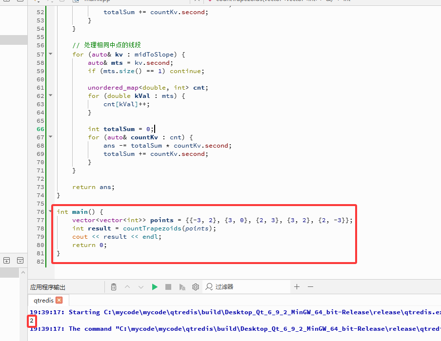

C++完整代码如下:
#include <iostream>
#include <vector>
#include <unordered_map>
#include <cmath>
using namespace std;
int countTrapezoids(vector<vector<int>>& points) {
    int n = points.size();
    double inf = 1e9 + 7;
    unordered_map<double, vector<double>> slopeToIntercept;
    unordered_map<double, vector<double>> midToSlope;
    int ans = 0;
    for (int i = 0; i < n; i++) {
        int x1 = points[i][0];
        int y1 = points[i][1];
        for (int j = i + 1; j < n; j++) {
            int x2 = points[j][0];
            int y2 = points[j][1];
            int dx = x1 - x2;
            int dy = y1 - y2;
            double k, b;
            if (x2 == x1) {
                k = inf;
                b = static_cast<double>(x1);
            } else {
                k = static_cast<double>(y2 - y1) / (x2 - x1);
                b = static_cast<double>(y1 * dx - x1 * dy) / dx;
            double mid = (x1 + x2) * 10000.0 + (y1 + y2);
            slopeToIntercept[k].push_back(b);
            midToSlope[mid].push_back(k);
    // 处理相同斜率的线段
    for (auto& kv : slopeToIntercept) {
        auto& sti = kv.second;
        if (sti.size() == 1) continue;
        unordered_map<double, int> cnt;
        for (double bVal : sti) {
            cnt[bVal]++;
        int totalSum = 0;
        for (auto& countKv : cnt) {
            ans += totalSum * countKv.second;
            totalSum += countKv.second;
    // 处理相同中点的线段
    for (auto& kv : midToSlope) {
        auto& mts = kv.second;
        if (mts.size() == 1) continue;
        for (double kVal : mts) {
            cnt[kVal]++;
        int totalSum = 0;
            ans -= totalSum * countKv.second;
    return ans;
int main() {
    vector<vector<int>> points = {{-3, 2}, {3, 0}, {2, 3}, {3, 2}, {2, -3}};
    int result = countTrapezoids(points);
    cout << result << endl;
    return 0;
