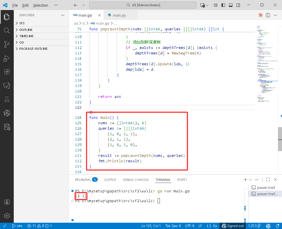

package main
import (
	"fmt"
// 计算数字的深度
func getDepth(x int64) int {
	res := 0
	for x > 1 {
		res++
		// 计算二进制中1的个数(popcount)
		count := 0
		for x > 0 {
			count += int(x & 1)
			x >>= 1
		x = int64(count)
	return res
// 线段树结构
type SegTree struct {
	n   int
	sum []int
// 创建线段树
func NewSegTree(n int) *SegTree {
	return &SegTree{
		n:   n,
		sum: make([]int, n<<2),
// 更新线段树
func (st *SegTree) update(p, l, r, idx int, val int) {
	if l == r {
		st.sum[p] += val
		return
	mid := (l + r) / 2
	if idx <= mid {
		st.update(p<<1, l, mid, idx, val)
	} else {
		st.update((p<<1)+1, mid+1, r, idx, val)
	st.sum[p] = st.sum[p<<1] + st.sum[(p<<1)+1]
// 查询线段树
func (st *SegTree) query(p, l, r, ql, qr int) int {
	if ql <= l && qr >= r {
		return st.sum[p]
	if ql > r || qr < l {
		return 0
	mid := (l + r) / 2
	return st.query(p<<1, l, mid, ql, qr) + st.query((p<<1)+1, mid+1, r, ql, qr)
// 更新接口
func (st *SegTree) Update(idx, val int) {
	st.update(1, 0, st.n-1, idx, val)
// 查询接口
func (st *SegTree) Query(l, r int) int {
	return st.query(1, 0, st.n-1, l, r)
// 主函数
func popcountDepth(nums []int64, queries [][]int64) []int {
	n := len(nums)
	// 计算每个数字的深度
	dep := make([]int, n)
	for i, num := range nums {
		dep[i] = getDepth(num)
	// 为每个深度创建线段树
	depthTrees := make(map[int]*SegTree)
	for i, d := range dep {
		if _, exists := depthTrees[d]; !exists {
			depthTrees[d] = NewSegTree(n)
		depthTrees[d].Update(i, 1)
	// 处理查询
	ans := []int{}
	for _, q := range queries {
		if q[0] == 1 { // 查询操作
			l, r, k := int(q[1]), int(q[2]), int(q[3])
			if tree, exists := depthTrees[k]; exists {
				ans = append(ans, tree.Query(l, r))
			} else {
				ans = append(ans, 0)
		} else if q[0] == 2 { // 更新操作
			idx, val := int(q[1]), q[2]
			d := getDepth(val)
			if d != dep[idx] {
				// 从原深度树中移除
				if tree, exists := depthTrees[dep[idx]]; exists {
					tree.Update(idx, -1)
				// 添加到新深度树
				depthTrees[d].Update(idx, 1)
				dep[idx] = d
	return ans
func main() {
	nums := []int64{2, 4}
	queries := [][]int64{
		{1, 0, 1, 1},
		{2, 1, 1},
		{1, 0, 1, 0},
	result := popcountDepth(nums, queries)
	fmt.Println(result)

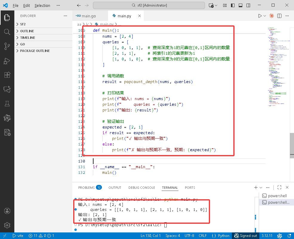

# -*-coding:utf-8-*-
def get_depth(x: int) -> int:
    """计算数字的深度"""
    res = 0
    while x > 1:
        res += 1
        # 计算二进制中1的个数(popcount)
        count = 0
        while x > 0:
            count += x & 1
            x >>= 1
        x = count
    return res
class SegTree:
    """线段树类"""
    def __init__(self, n: int):
        self.n = n
        self.sum = [0] * (n << 2)
    def _update(self, p: int, l: int, r: int, idx: int, val: int) -> None:
        """内部更新函数"""
        if l == r:
            self.sum[p] += val
            return
        mid = (l + r) // 2
        if idx <= mid:
            self._update(p << 1, l, mid, idx, val)
        else:
            self._update((p << 1) + 1, mid + 1, r, idx, val)
        self.sum[p] = self.sum[p << 1] + self.sum[(p << 1) + 1]
    def _query(self, p: int, l: int, r: int, ql: int, qr: int) -> int:
        """内部查询函数"""
        if ql <= l and qr >= r:
            return self.sum[p]
        if ql > r or qr < l:
            return 0
        mid = (l + r) // 2
        return (self._query(p << 1, l, mid, ql, qr) +
                self._query((p << 1) + 1, mid + 1, r, ql, qr))
    def update(self, idx: int, val: int) -> None:
        """更新接口"""
        self._update(1, 0, self.n - 1, idx, val)
    def query(self, l: int, r: int) -> int:
        """查询接口"""
        return self._query(1, 0, self.n - 1, l, r)
def popcount_depth(nums, queries):
    主函数:处理查询
    Args:
        nums: List[int] - 初始数字数组
        queries: List[List[int]] - 查询数组
    Returns:
        List[int] - 查询结果
    n = len(nums)
    # 计算每个数字的深度
    dep = [get_depth(x) for x in nums]
    # 为每个深度创建线段树
    depth_trees = {}
    for i, d in enumerate(dep):
        if d not in depth_trees:
            depth_trees[d] = SegTree(n)
        depth_trees[d].update(i, 1)
    # 处理查询
    ans = []
    for q in queries:
        if q[0] == 1:  # 查询操作
            l, r, k = q[1], q[2], q[3]
            if k in depth_trees:
                ans.append(depth_trees[k].query(l, r))
            else:
                ans.append(0)
        elif q[0] == 2:  # 更新操作
            idx, val = q[1], q[2]
            d = get_depth(val)
            if d != dep[idx]:
                # 从原深度树中移除
                if dep[idx] in depth_trees:
                    depth_trees[dep[idx]].update(idx, -1)
                # 添加到新深度树
                depth_trees[d].update(idx, 1)
                dep[idx] = d
    return ans
def main():
    """测试函数"""
    nums = [2, 4]
    queries = [
        [1, 0, 1, 1],  # 查询深度为1的元素在[0,1]区间内的数量
        [2, 1, 1],     # 将索引1的元素更新为1
        [1, 0, 1, 0],  # 查询深度为0的元素在[0,1]区间内的数量
    # 调用函数
    result = popcount_depth(nums, queries)
    # 打印结果
    print(f"输入: nums = {nums}")
    print(f"     queries = {queries}")
    print(f"输出: {result}")
    # 验证输出
    expected = [2, 1]
    if result == expected:
        print("✓ 输出与预期一致")
    else:
        print(f"✗ 输出与预期不一致,预期: {expected}")
if __name__ == "__main__":
    main()

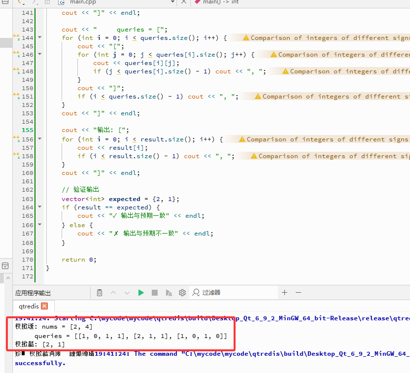

#include <iostream>
#include <vector>
#include <unordered_map>
using namespace std;
// 计算数字的深度
int getDepth(long long x) {
    int res = 0;
    while (x > 1) {
        res++;
        int count = 0;
        while (x > 0) {
            count += (x & 1);
            x >>= 1;
        x = count;
    return res;
// 线段树类
class SegTree {
private:
    int n;
    vector<int> sum;
    void update(int p, int l, int r, int idx, int val) {
        if (l == r) {
            sum[p] += val;
            return;
        int mid = (l + r) / 2;
        if (idx <= mid) {
            update(p << 1, l, mid, idx, val);
        } else {
            update((p << 1) + 1, mid + 1, r, idx, val);
        sum[p] = sum[p << 1] + sum[(p << 1) + 1];
    int query(int p, int l, int r, int ql, int qr) {
        if (ql <= l && qr >= r) {
            return sum[p];
        if (ql > r || qr < l) {
            return 0;
        return query(p << 1, l, mid, ql, qr) +
               query((p << 1) + 1, mid + 1, r, ql, qr);
public:
    SegTree(int n) : n(n), sum(n << 2, 0) {}
    void Update(int idx, int val) {
        update(1, 0, n - 1, idx, val);
    int Query(int l, int r) {
        return query(1, 0, n - 1, l, r);
// 主函数
vector<int> popcountDepth(vector<long long>& nums, vector<vector<long long>>& queries) {
    int n = nums.size();
    // 计算每个数字的深度
    vector<int> dep(n);
    for (int i = 0; i < n; i++) {
        dep[i] = getDepth(nums[i]);
    // 为每个深度创建线段树
    unordered_map<int, SegTree*> depthTrees;
        int d = dep[i];
        if (depthTrees.find(d) == depthTrees.end()) {
            depthTrees[d] = new SegTree(n);
        depthTrees[d]->Update(i, 1);
    // 处理查询
    vector<int> ans;
    for (auto& q : queries) {
        if (q[0] == 1) { // 查询操作
            int l = q[1], r = q[2], k = q[3];
            if (depthTrees.find(k) != depthTrees.end()) {
                ans.push_back(depthTrees[k]->Query(l, r));
            } else {
                ans.push_back(0);
        } else if (q[0] == 2) { // 更新操作
            int idx = q[1];
            long long val = q[2];
            int d = getDepth(val);
            if (d != dep[idx]) {
                // 从原深度树中移除
                if (depthTrees.find(dep[idx]) != depthTrees.end()) {
                    depthTrees[dep[idx]]->Update(idx, -1);
                // 添加到新深度树
                depthTrees[d]->Update(idx, 1);
                dep[idx] = d;
    // 清理动态分配的内存
    for (auto& [depth, tree] : depthTrees) {
        delete tree;
    return ans;
int main() {
    // 测试数据
    vector<long long> nums = {2, 4};
    vector<vector<long long>> queries = {
        {1, 0, 1, 1},  // 查询深度为1的元素在[0,1]区间内的数量
        {2, 1, 1},     // 将索引1的元素更新为1
        {1, 0, 1, 0},  // 查询深度为0的元素在[0,1]区间内的数量
    // 调用函数
    vector<int> result = popcountDepth(nums, queries);
    // 打印结果
    cout << "输入: nums = [";
    for (int i = 0; i < nums.size(); i++) {
        cout << nums[i];
        if (i < nums.size() - 1) cout << ", ";
    cout << "]" << endl;
    cout << "     queries = [";
    for (int i = 0; i < queries.size(); i++) {
        cout << "[";
        for (int j = 0; j < queries[i].size(); j++) {
            cout << queries[i][j];
            if (j < queries[i].size() - 1) cout << ", ";
        cout << "]";
        if (i < queries.size() - 1) cout << ", ";
    cout << "输出: [";
    for (int i = 0; i < result.size(); i++) {
        cout << result[i];
        if (i < result.size() - 1) cout << ", ";
    // 验证输出
    vector<int> expected = {2, 1};
    if (result == expected) {
        cout << "✓ 输出与预期一致" << endl;
    } else {
        cout << "✗ 输出与预期不一致" << endl;
    return 0;
