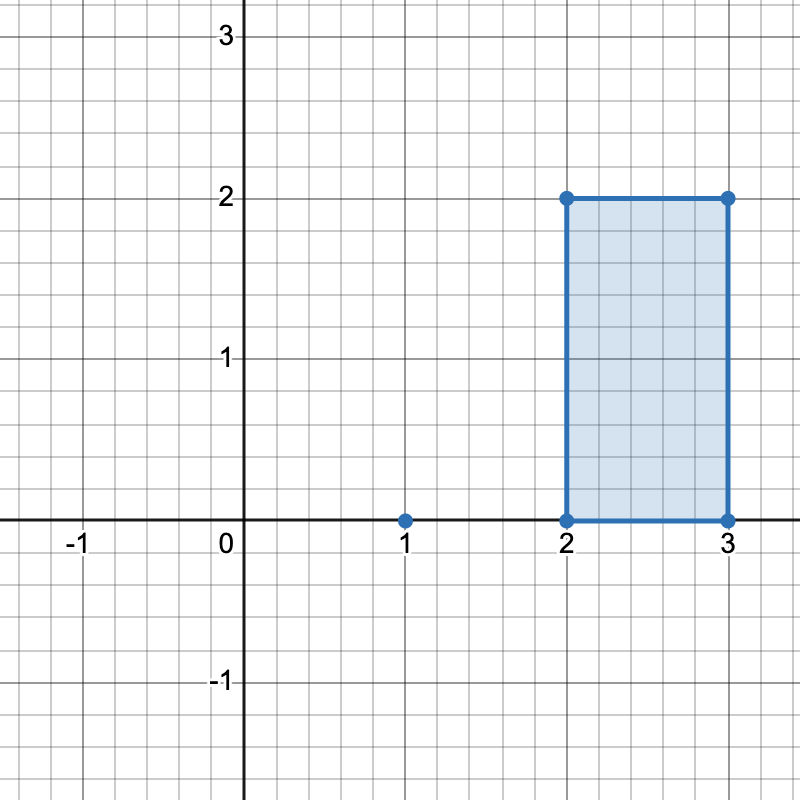

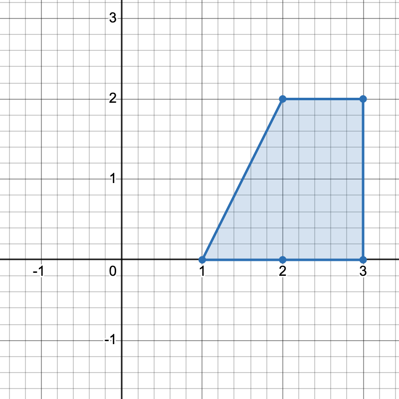

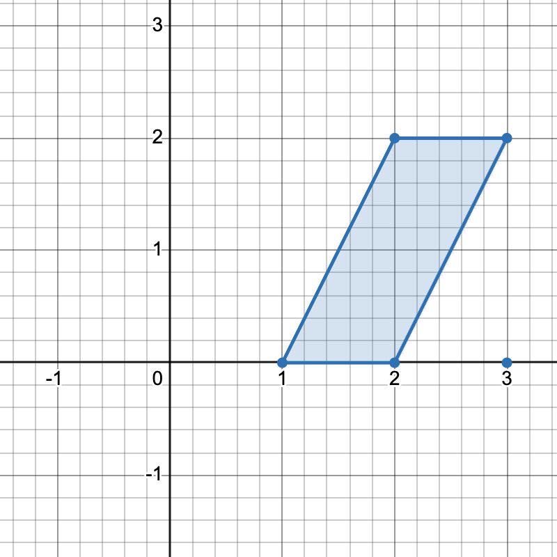

有三种不同方式选择四个点组成一个水平梯形:
使用点 [1,0]、[2,0]、[3,2] 和 [2,2]。
使用点 [2,0]、[3,0]、[3,2] 和 [2,2]。
使用点 [1,0]、[3,0]、[3,2] 和 [2,2]。

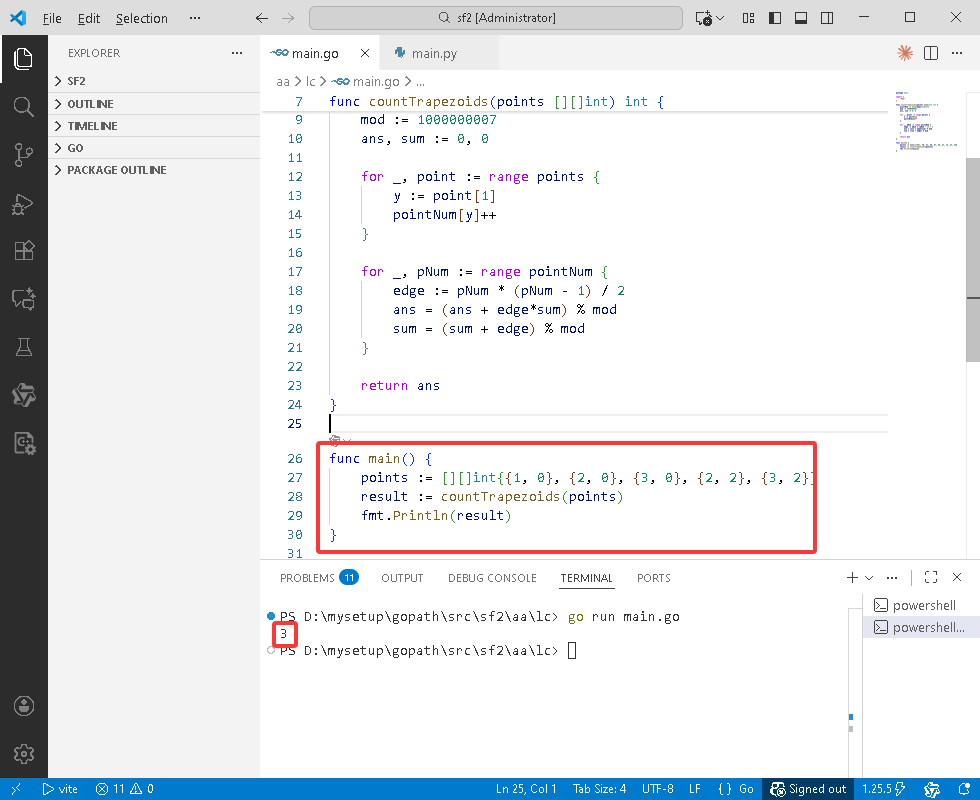

Go完整代码如下:
package main
import (
	"fmt"
func countTrapezoids(points [][]int) int {
	pointNum := make(map[int]int)
	mod := 1000000007
	ans, sum := 0, 0
	for _, point := range points {
		y := point[1]
		pointNum[y]++
	for _, pNum := range pointNum {
		edge := pNum * (pNum - 1) / 2
		ans = (ans + edge*sum) % mod
		sum = (sum + edge) % mod
	return ans
func main() {
	points := [][]int{{1, 0}, {2, 0}, {3, 0}, {2, 2}, {3, 2}}
	result := countTrapezoids(points)
	fmt.Println(result)

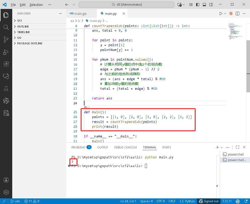

Python完整代码如下:
# -*-coding:utf-8-*-
from typing import List
from collections import defaultdict
def countTrapezoids(points: List[List[int]]) -> int:
    pointNum = defaultdict(int)
    MOD = 1000000007
    ans, total = 0, 0
    for point in points:
        y = point[1]
        pointNum[y] += 1
    for pNum in pointNum.values():
        # 计算从相同y值的点中选2个的组合数
        edge = pNum * (pNum - 1) // 2
        # 与之前的组合形成梯形
        ans = (ans + edge * total) % MOD
        # 累加当前y值的组合数
        total = (total + edge) % MOD
    return ans
def main():
    points = [[1, 0], [2, 0], [3, 0], [2, 2], [3, 2]]
    result = countTrapezoids(points)
    print(result)
if __name__ == "__main__":
    main()

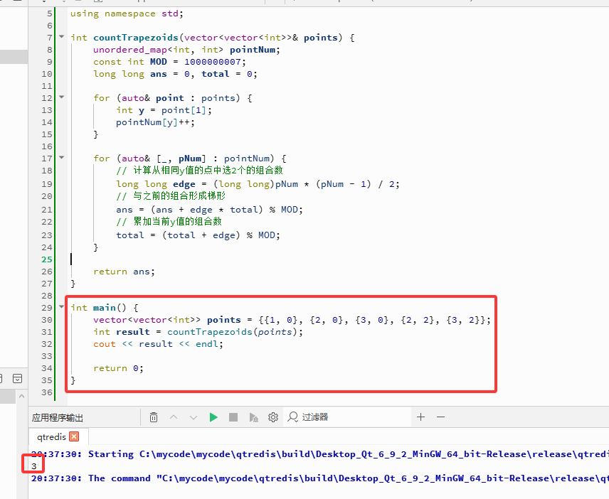

C++完整代码如下:
#include <iostream>
#include <vector>
#include <unordered_map>
using namespace std;
int countTrapezoids(vector<vector<int>>& points) {
    unordered_map<int, int> pointNum;
    const int MOD = 1000000007;
    long long ans = 0, total = 0;
    for (auto& point : points) {
        int y = point[1];
        pointNum[y]++;
    for (auto& [_, pNum] : pointNum) {
        // 计算从相同y值的点中选2个的组合数
        long long edge = (long long)pNum * (pNum - 1) / 2;
        // 与之前的组合形成梯形
        ans = (ans + edge * total) % MOD;
        // 累加当前y值的组合数
        total = (total + edge) % MOD;
    return ans;
int main() {
    vector<vector<int>> points = {{1, 0}, {2, 0}, {3, 0}, {2, 2}, {3, 2}};
    int result = countTrapezoids(points);
    cout << result << endl;
    return 0;
