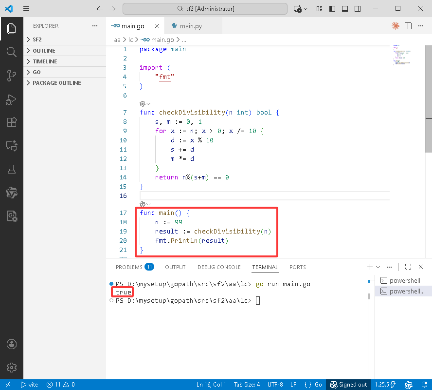

package main
import (
	"fmt"
func checkDivisibility(n int) bool {
	s, m := 0, 1
	for x := n; x > 0; x /= 10 {
		d := x % 10
		s += d
		m *= d
	return n%(s+m) == 0
func main() {
	n := 99
	result := checkDivisibility(n)
	fmt.Println(result)

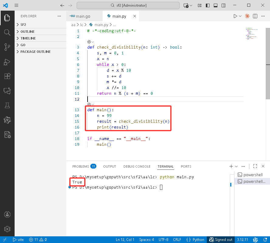

# -*-coding:utf-8-*-
def check_divisibility(n: int) -> bool:
    s, m = 0, 1
    x = n
    while x > 0:
        d = x % 10
        s += d
        m *= d
        x //= 10
    return n % (s + m) == 0
def main():
    n = 99
    result = check_divisibility(n)
    print(result)
if __name__ == "__main__":
    main()

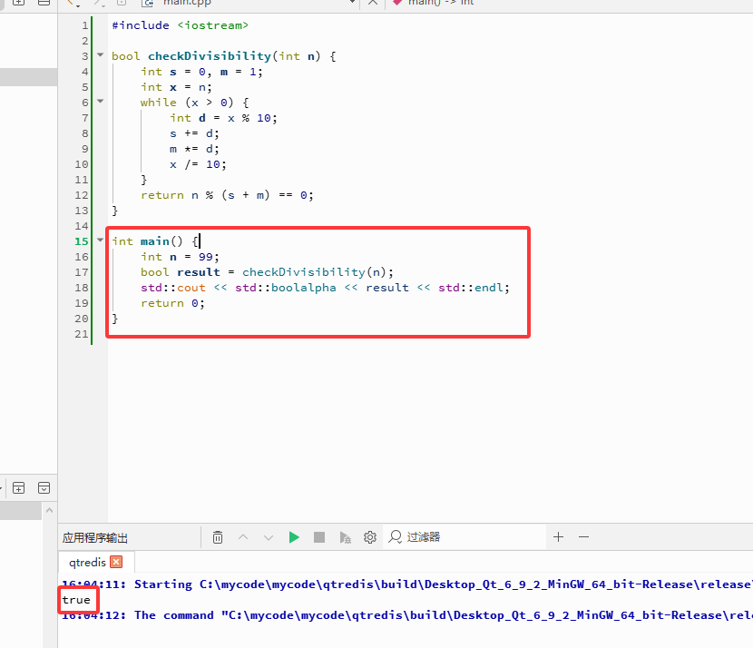

#include <iostream>
bool checkDivisibility(int n) {
    int s = 0, m = 1;
    int x = n;
    while (x > 0) {
        int d = x % 10;
        s += d;
        m *= d;
        x /= 10;
    return n % (s + m) == 0;
int main() {
    int n = 99;
    bool result = checkDivisibility(n);
    std::cout << std::boolalpha << result << std::endl;
    return 0;
