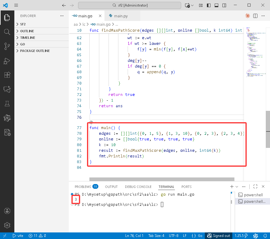

func main() {
	edges := [][]int{{0, 1, 5}, {1, 3, 10}, {0, 2, 3}, {2, 3, 4}}
	online := []bool{true, true, true, true}
	k := 10
	result := findMaxPathScore(edges, online, int64(k))
	fmt.Println(result)
