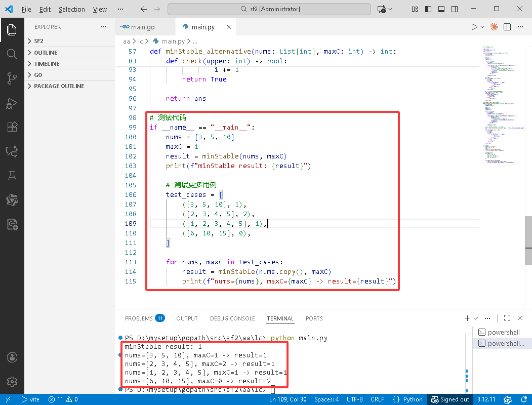

# 测试代码
if __name__ == "__main__":
    nums = [3, 5, 10]
    maxC = 1
    result = minStable(nums, maxC)
    print(f"minStable result: {result}")
    # 测试更多用例
    test_cases = [
        ([3, 5, 10], 1),
        ([2, 3, 4, 5], 2),
        ([1, 2, 3, 4, 5], 1),
        ([6, 10, 15], 0),
    for nums, maxC in test_cases:
        result = minStable(nums.copy(), maxC)
        print(f"nums={nums}, maxC={maxC} -> result={result}")

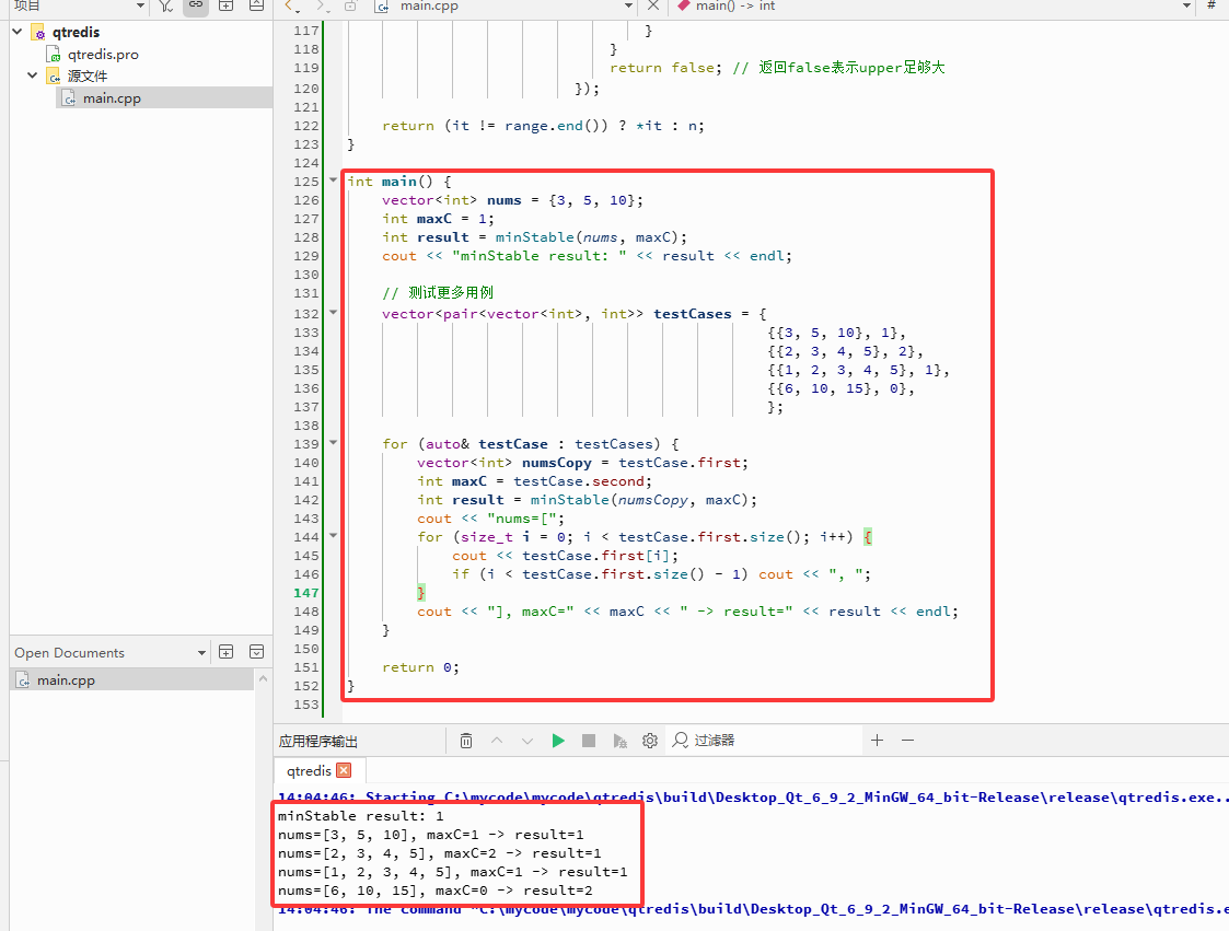

int main() {
    vector<int> nums = {3, 5, 10};
    int maxC = 1;
    int result = minStable(nums, maxC);
    cout << "minStable result: " << result << endl;
    // 测试更多用例
    vector<pair<vector<int>, int>> testCases = {
                                                {{3, 5, 10}, 1},
                                                {{2, 3, 4, 5}, 2},
                                                {{1, 2, 3, 4, 5}, 1},
                                                {{6, 10, 15}, 0},
    for (auto& testCase : testCases) {
        vector<int> numsCopy = testCase.first;
        int maxC = testCase.second;
        int result = minStable(numsCopy, maxC);
        cout << "nums=[";
        for (size_t i = 0; i < testCase.first.size(); i++) {
            cout << testCase.first[i];
            if (i < testCase.first.size() - 1) cout << ", ";
        cout << "], maxC=" << maxC << " -> result=" << result << endl;
    return 0;
