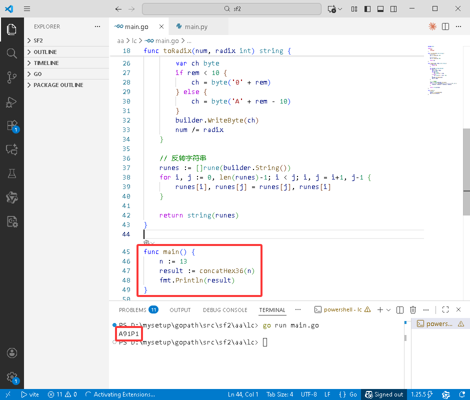

Go完整代码如下:
package main
import (
	"fmt"
	"strings"
func concatHex36(n int) string {
	h := n * n
	ans := toRadix(h, 16)
	h = n * n * n
	ans += toRadix(h, 36)
	return ans
func toRadix(num, radix int) string {
	if num == 0 {
		return "0"
	var builder strings.Builder
	for num > 0 {
		rem := num % radix
		var ch byte
		if rem < 10 {
			ch = byte('0' + rem)
		} else {
			ch = byte('A' + rem - 10)
		builder.WriteByte(ch)
		num /= radix
	// 反转字符串
	runes := []rune(builder.String())
	for i, j := 0, len(runes)-1; i < j; i, j = i+1, j-1 {
		runes[i], runes[j] = runes[j], runes[i]
	return string(runes)
func main() {
	n := 13
	result := concatHex36(n)
	fmt.Println(result)

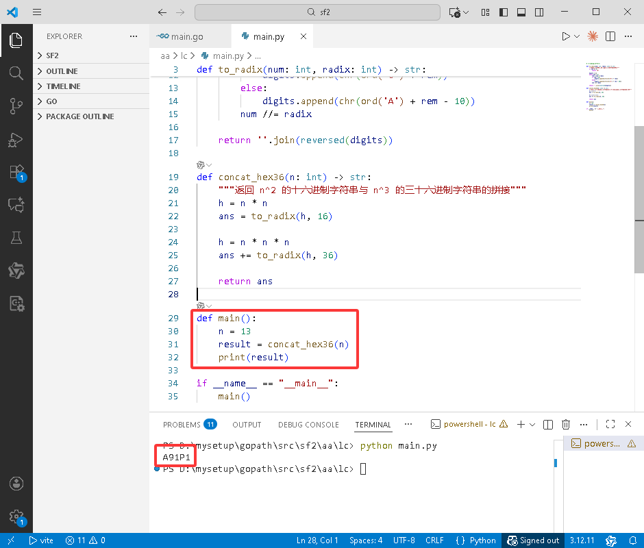

Python完整代码如下:
# -*-coding:utf-8-*-
def to_radix(num: int, radix: int) -> str:
    """将十进制整数转换为指定进制的字符串表示"""
    if num == 0:
        return "0"
    digits = []
    while num > 0:
        rem = num % radix
        if rem < 10:
            digits.append(chr(ord('0') + rem))
        else:
            digits.append(chr(ord('A') + rem - 10))
        num //= radix
    return ''.join(reversed(digits))
def concat_hex36(n: int) -> str:
    """返回 n^2 的十六进制字符串与 n^3 的三十六进制字符串的拼接"""
    h = n * n
    ans = to_radix(h, 16)
    h = n * n * n
    ans += to_radix(h, 36)
    return ans
def main():
    n = 13
    result = concat_hex36(n)
    print(result)
if __name__ == "__main__":
    main()

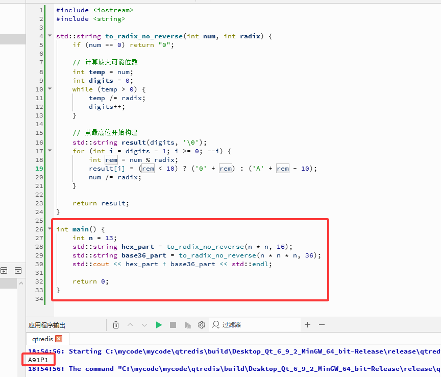

C++完整代码如下:
#include <iostream>
#include <string>
std::string to_radix_no_reverse(int num, int radix) {
    if (num == 0) return "0";
    // 计算最大可能位数
    int temp = num;
    int digits = 0;
    while (temp > 0) {
        temp /= radix;
        digits++;
    // 从最高位开始构建
    std::string result(digits, '\0');
    for (int i = digits - 1; i >= 0; --i) {
        int rem = num % radix;
        result[i] = (rem < 10) ? ('0' + rem) : ('A' + rem - 10);
        num /= radix;
    return result;
int main() {
    int n = 13;
    std::string hex_part = to_radix_no_reverse(n * n, 16);
    std::string base36_part = to_radix_no_reverse(n * n * n, 36);
    std::cout << hex_part + base36_part << std::endl;
    return 0;
