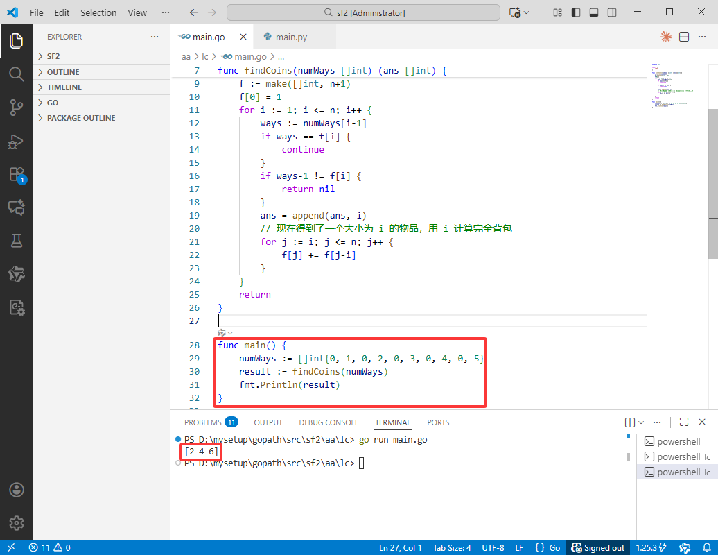

Go完整代码如下:
package main
import (
	"fmt"
func findCoins(numWays []int) (ans []int) {
	n := len(numWays)
	f := make([]int, n+1)
	f[0] = 1
	for i := 1; i <= n; i++ {
		ways := numWays[i-1]
		if ways == f[i] {
			continue
		if ways-1 != f[i] {
			return nil
		ans = append(ans, i)
		// 现在得到了一个大小为 i 的物品,用 i 计算完全背包
		for j := i; j <= n; j++ {
			f[j] += f[j-i]
	return
func main() {
	numWays := []int{0, 1, 0, 2, 0, 3, 0, 4, 0, 5}
	result := findCoins(numWays)
	fmt.Println(result)

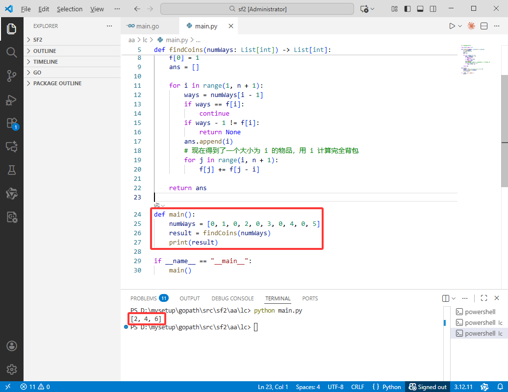

Python完整代码如下:
# -*-coding:utf-8-*-
from typing import List
def findCoins(numWays: List[int]) -> List[int]:
    n = len(numWays)
    f = [0] * (n + 1)
    f[0] = 1
    ans = []
    for i in range(1, n + 1):
        ways = numWays[i - 1]
        if ways == f[i]:
            continue
        if ways - 1 != f[i]:
            return None
        ans.append(i)
        # 现在得到了一个大小为 i 的物品,用 i 计算完全背包
        for j in range(i, n + 1):
            f[j] += f[j - i]
    return ans
def main():
    numWays = [0, 1, 0, 2, 0, 3, 0, 4, 0, 5]
    result = findCoins(numWays)
    print(result)
if __name__ == "__main__":
    main()

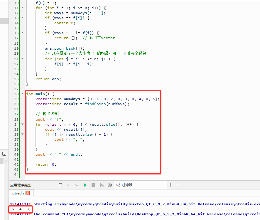

C++完整代码如下:
#include <iostream>
#include <vector>
using namespace std;
vector<int> findCoins(const vector<int>& numWays) {
    int n = numWays.size();
    vector<int> f(n + 1, 0);
    vector<int> ans;
    f[0] = 1;
    for (int i = 1; i <= n; i++) {
        int ways = numWays[i - 1];
        if (ways == f[i]) {
            continue;
        if (ways - 1 != f[i]) {
            return {};  // 返回空vector
        ans.push_back(i);
        for (int j = i; j <= n; j++) {
            f[j] += f[j - i];
    return ans;
int main() {
    vector<int> numWays = {0, 1, 0, 2, 0, 3, 0, 4, 0, 5};
    vector<int> result = findCoins(numWays);
    // 输出结果
    cout << "[";
    for (size_t i = 0; i < result.size(); i++) {
        cout << result[i];
        if (i != result.size() - 1) {
            cout << ", ";
    cout << "]" << endl;
    return 0;
