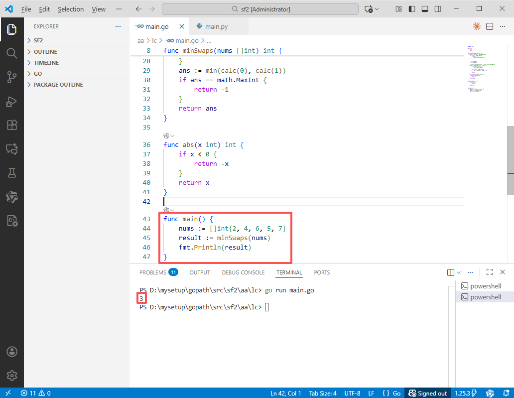

Go完整代码如下:
import math
from typing import List
def minSwaps(nums: List[int]) -> int:
    pos1 = []  # 车(奇数)的下标
    for i, x in enumerate(nums):
        if x % 2 != 0:
            pos1.append(i)
    n = len(nums)
    m = len(pos1)
    def calc(start: int) -> int:
        if (n - start + 1) // 2 != m:
            return math.inf
        res = 0
        for i, j in enumerate(pos1):
            res += abs(i * 2 + start - j)
        return res
    ans = min(calc(0), calc(1))
    if ans == math.inf:
        return -1
    return ans
def main():
    nums = [2, 4, 6, 5, 7]
    result = minSwaps(nums)
    print(result)
if __name__ == "__main__":
    main()

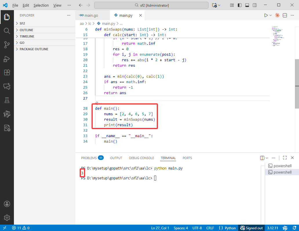

Python完整代码如下:
# -*-coding:utf-8-*-
import math
        if x % 2 != 0:
            pos1.append(i)
    n = len(nums)
    m = len(pos1)
            return math.inf
        res = 0
        return res
    if ans == math.inf:
        return -1
    return ans
def main():
    print(result)
    main()

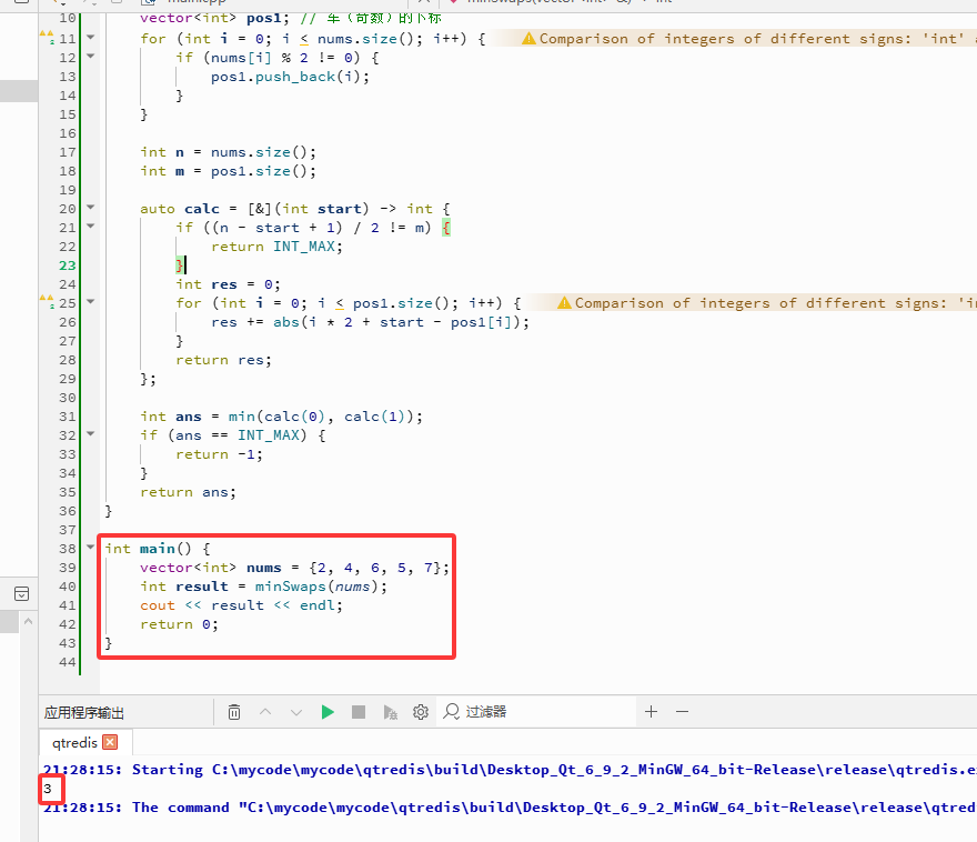

C++完整代码如下:
#include <iostream>
#include <vector>
#include <cmath>
#include <algorithm>
#include <climits>
using namespace std;
int minSwaps(vector<int>& nums) {
    vector<int> pos1; // 车(奇数)的下标
    for (int i = 0; i < nums.size(); i++) {
        if (nums[i] % 2 != 0) {
            pos1.push_back(i);
    int n = nums.size();
    int m = pos1.size();
    auto calc = [&](int start) -> int {
        if ((n - start + 1) / 2 != m) {
            return INT_MAX;
        int res = 0;
        for (int i = 0; i < pos1.size(); i++) {
            res += abs(i * 2 + start - pos1[i]);
        return res;
    int ans = min(calc(0), calc(1));
    if (ans == INT_MAX) {
        return -1;
    return ans;
int main() {
    vector<int> nums = {2, 4, 6, 5, 7};
    int result = minSwaps(nums);
    cout << result << endl;
    return 0;
