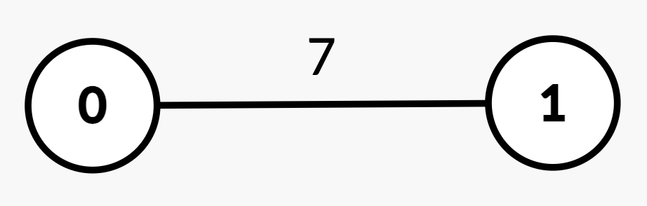

输入: n = 2, edges = [[0,1,7]], queries = [[1,0],[0,1]]。
输出: [0,1]。
解释:
查询 路径 边权 总路径权值和 一半 解释 答案
[1, 0] 1 → 0 [7] 7 3.5 从 1 → 0 的权重和为 7 ≥ 3.5,中位节点是 0。 0
[0, 1] 0 → 1 [7] 7 3.5 从 0 → 1 的权重和为 7 ≥ 3.5,中位节点是 1。 1

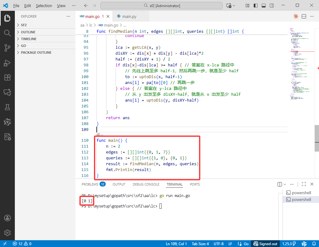

func main() {
	n := 2
	edges := [][]int{{0, 1, 7}}
	queries := [][]int{{1, 0}, {0, 1}}
	result := findMedian(n, edges, queries)
	fmt.Println(result)

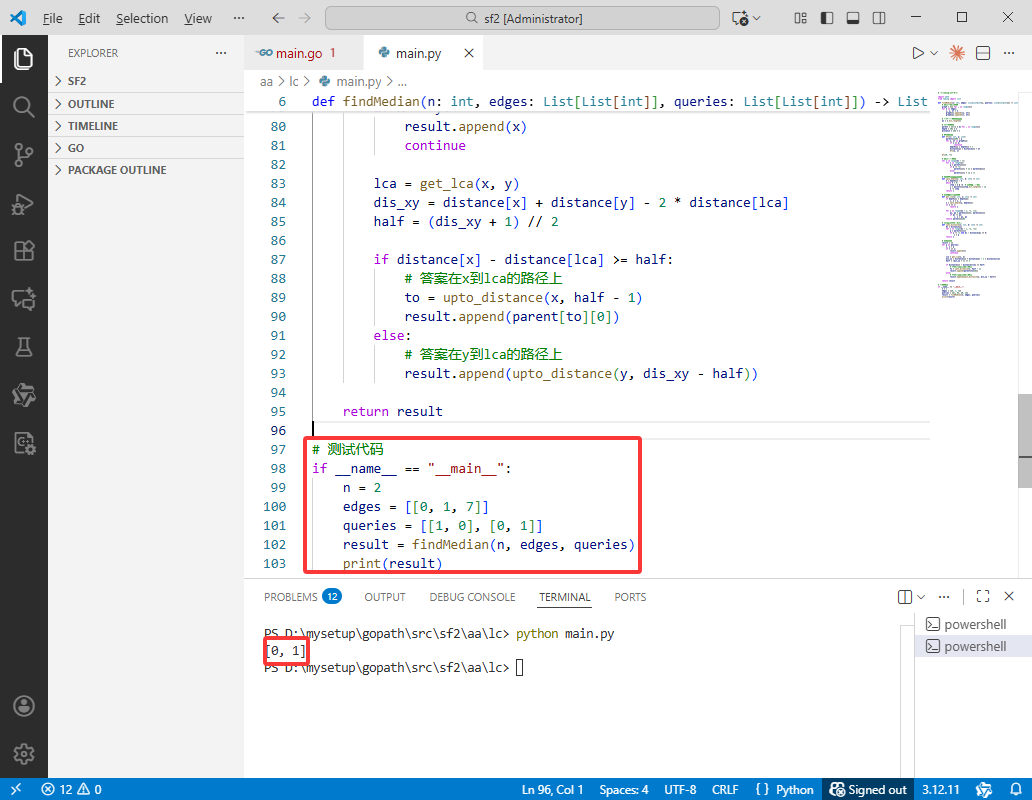

# 测试代码
if __name__ == "__main__":
    n = 2
    edges = [[0, 1, 7]]
    queries = [[1, 0], [0, 1]]
    result = findMedian(n, edges, queries)
    print(result)

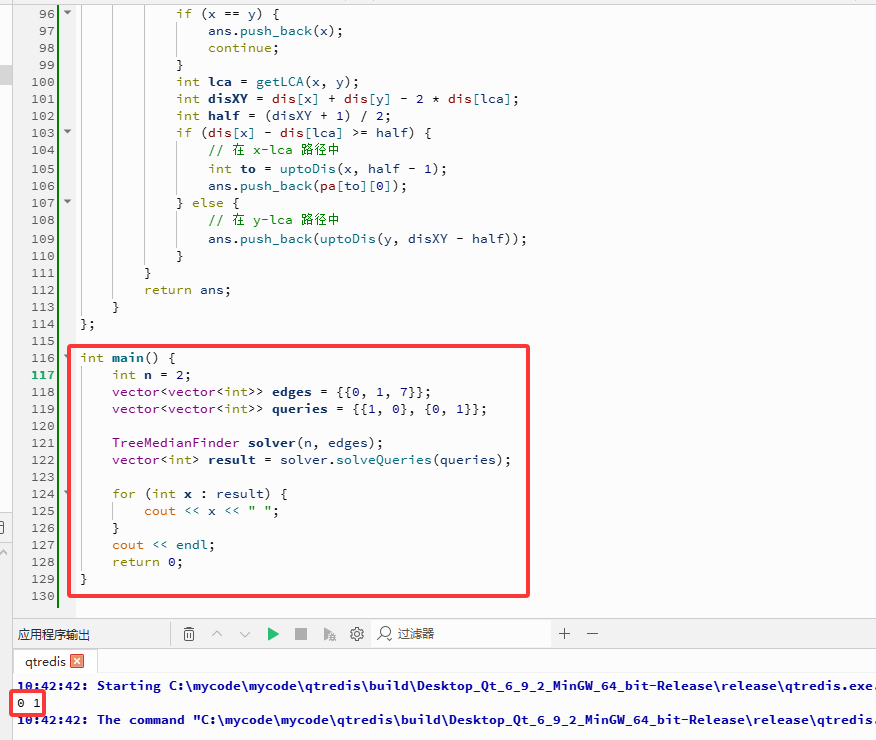

int main() {
    int n = 2;
    vector<vector<int>> edges = {{0, 1, 7}};
    vector<vector<int>> queries = {{1, 0}, {0, 1}};
    TreeMedianFinder solver(n, edges);
    vector<int> result = solver.solveQueries(queries);
    for (int x : result) {
        cout << x << " ";
    cout << endl;
    return 0;
