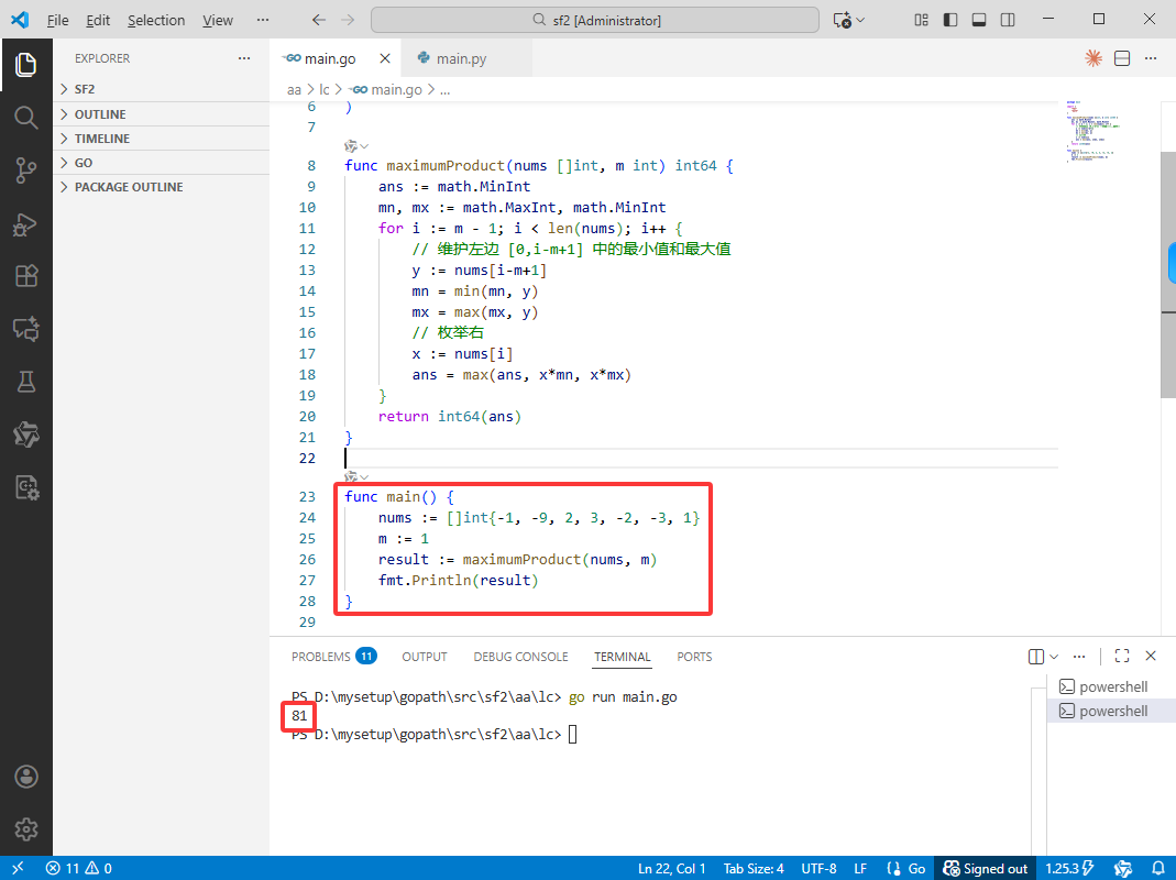

Go完整代码如下:
package main
import (
	"fmt"
	"math"
func maximumProduct(nums []int, m int) int64 {
	ans := math.MinInt
	mn, mx := math.MaxInt, math.MinInt
	for i := m - 1; i < len(nums); i++ {
		// 维护左边 [0,i-m+1] 中的最小值和最大值
		y := nums[i-m+1]
		mn = min(mn, y)
		mx = max(mx, y)
		// 枚举右
		x := nums[i]
		ans = max(ans, x*mn, x*mx)
	return int64(ans)
func main() {
	nums := []int{-1, -9, 2, 3, -2, -3, 1}
	m := 1
	result := maximumProduct(nums, m)
	fmt.Println(result)

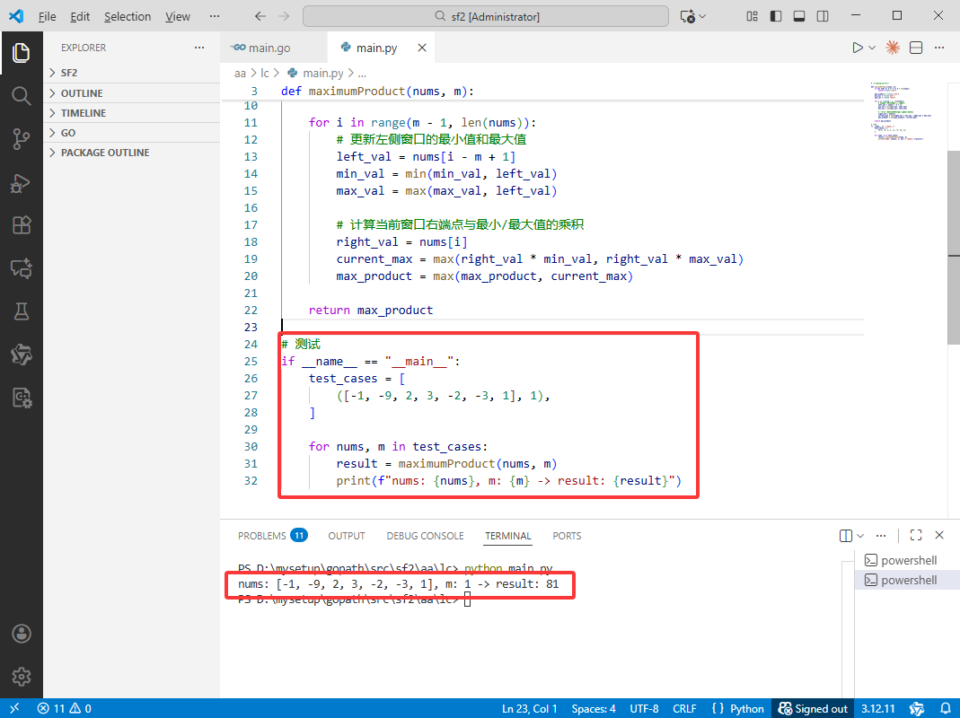

Python完整代码如下:
# -*-coding:utf-8-*-
def maximumProduct(nums, m):
    if not nums or m <= 0 or m > len(nums):
        return float('-inf')
    max_product = float('-inf')
    min_val = float('inf')
    max_val = float('-inf')
    for i in range(m - 1, len(nums)):
        # 更新左侧窗口的最小值和最大值
        left_val = nums[i - m + 1]
        min_val = min(min_val, left_val)
        max_val = max(max_val, left_val)
        # 计算当前窗口右端点与最小/最大值的乘积
        right_val = nums[i]
        current_max = max(right_val * min_val, right_val * max_val)
        max_product = max(max_product, current_max)
    return max_product
# 测试
if __name__ == "__main__":
    test_cases = [
        ([-1, -9, 2, 3, -2, -3, 1], 1),
    for nums, m in test_cases:
        result = maximumProduct(nums, m)
        print(f"nums: {nums}, m: {m} -> result: {result}")

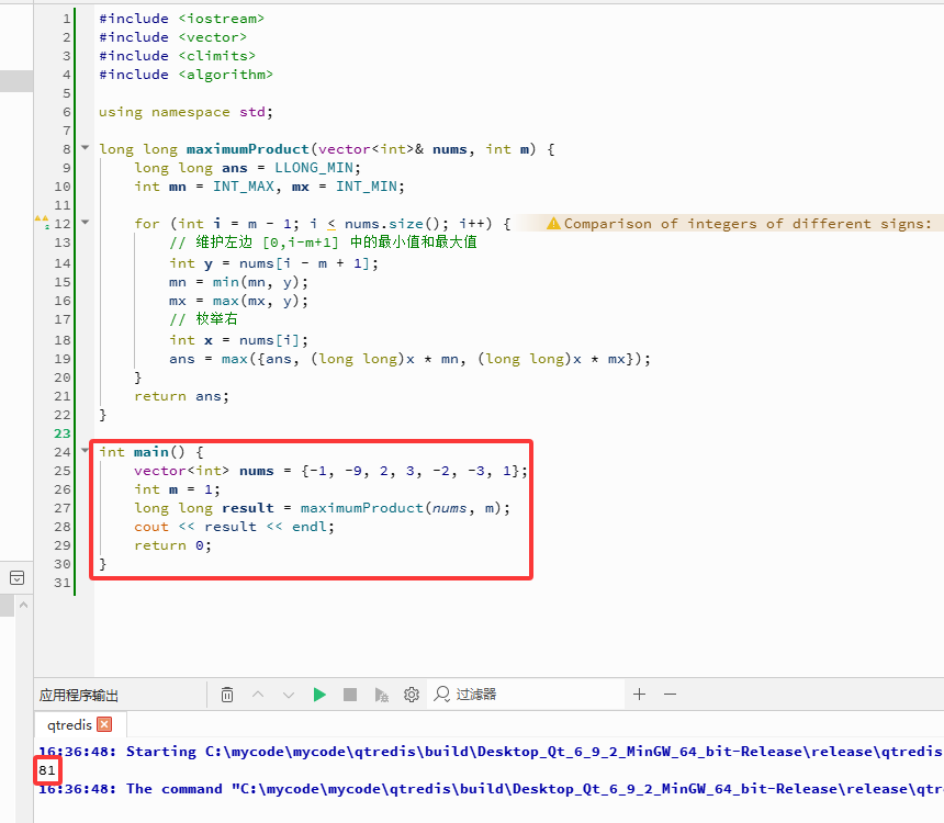

C++完整代码如下:
#include <iostream>
#include <vector>
#include <climits>
#include <algorithm>
using namespace std;
long long maximumProduct(vector<int>& nums, int m) {
    long long ans = LLONG_MIN;
    int mn = INT_MAX, mx = INT_MIN;
    for (int i = m - 1; i < nums.size(); i++) {
        int y = nums[i - m + 1];
        mn = min(mn, y);
        mx = max(mx, y);
        // 枚举右
        int x = nums[i];
        ans = max({ans, (long long)x * mn, (long long)x * mx});
    return ans;
int main() {
    vector<int> nums = {-1, -9, 2, 3, -2, -3, 1};
    int m = 1;
    long long result = maximumProduct(nums, m);
    cout << result << endl;
    return 0;
