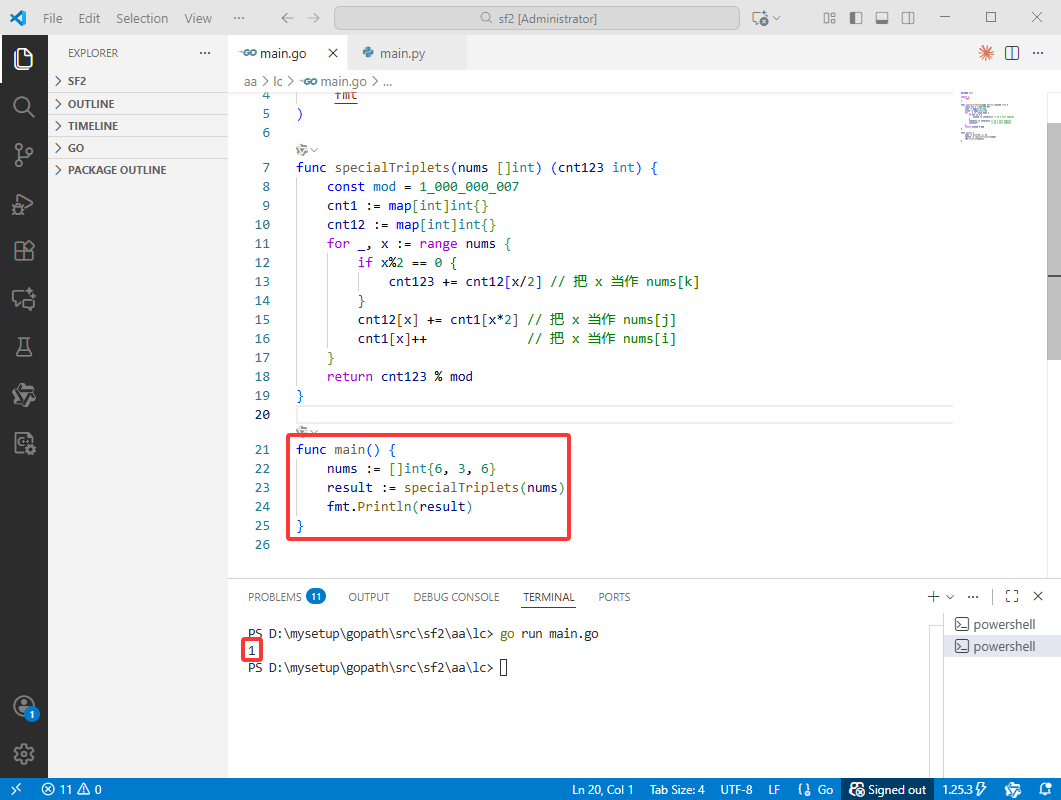

Go完整代码如下:
package main
import (
	"fmt"
func specialTriplets(nums []int) (cnt123 int) {
	const mod = 1_000_000_007
	cnt1 := map[int]int{}
	cnt12 := map[int]int{}
	for _, x := range nums {
		if x%2 == 0 {
			cnt123 += cnt12[x/2] // 把 x 当作 nums[k]
		cnt12[x] += cnt1[x*2] // 把 x 当作 nums[j]
		cnt1[x]++             // 把 x 当作 nums[i]
	return cnt123 % mod
func main() {
	nums := []int{6, 3, 6}
	result := specialTriplets(nums)
	fmt.Println(result)

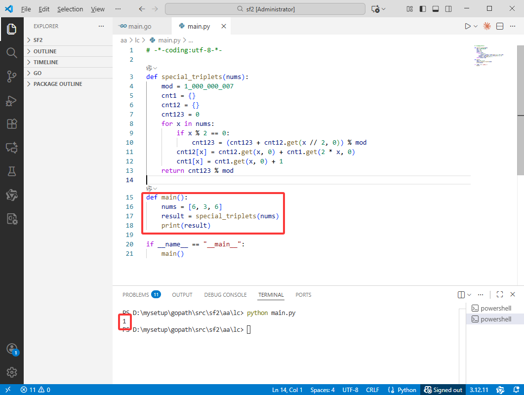

Python完整代码如下:
# -*-coding:utf-8-*-
def special_triplets(nums):
    mod = 1_000_000_007
    cnt1 = {}
    cnt12 = {}
    cnt123 = 0
    for x in nums:
        if x % 2 == 0:
            cnt123 = (cnt123 + cnt12.get(x // 2, 0)) % mod
        cnt12[x] = cnt12.get(x, 0) + cnt1.get(2 * x, 0)
        cnt1[x] = cnt1.get(x, 0) + 1
    return cnt123 % mod
def main():
    nums = [6, 3, 6]
    result = special_triplets(nums)
    print(result)
if __name__ == "__main__":
    main()

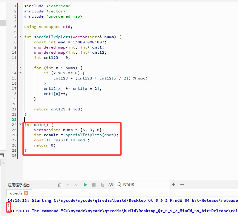

C++完整代码如下:
#include <iostream>
#include <vector>
#include <unordered_map>
using namespace std;
int specialTriplets(vector<int>& nums) {
    const int mod = 1'000'000'007;
    unordered_map<int, int> cnt1;
    unordered_map<int, int> cnt12;
    int cnt123 = 0;
    for (int x : nums) {
        if (x % 2 == 0) {
            cnt123 = (cnt123 + cnt12[x / 2]) % mod;
        cnt12[x] += cnt1[x * 2];
        cnt1[x]++;
    return cnt123 % mod;
int main() {
    vector<int> nums = {6, 3, 6};
    int result = specialTriplets(nums);
    cout << result << endl;
    return 0;
