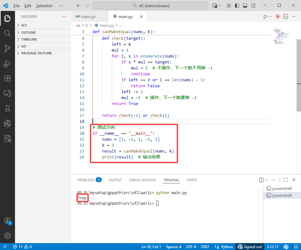

Python完整代码如下:
# -*-coding:utf-8-*-
def canMakeEqual(nums, k):
    def check(target):
        left = k
        mul = 1
        for i, x in enumerate(nums):
            if x * mul == target:
                mul = 1  # 不操作,下一个数不用乘 -1
                continue
            if left == 0 or i == len(nums) - 1:
                return False
            left -= 1
            mul = -1  # 操作,下一个数要乘 -1
        return True
    return check(-1) or check(1)
# 测试示例
if __name__ == "__main__":
    nums = [1, -1, 1, -1, 1]
    k = 3
    result = canMakeEqual(nums, k)
    print(result)  # 输出结果

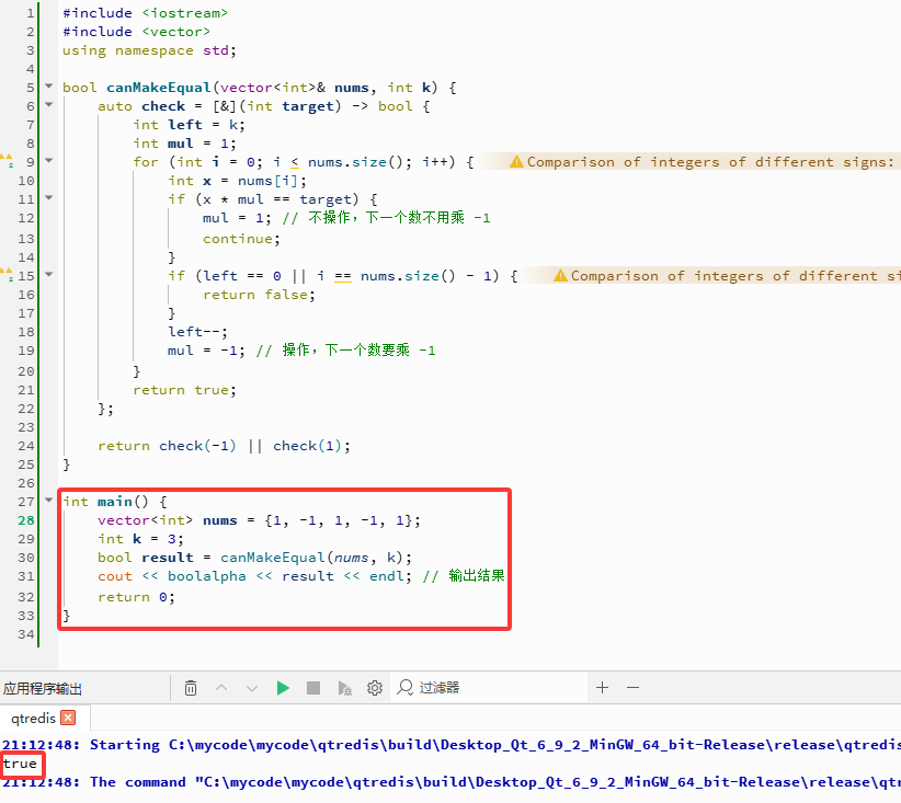

C++完整代码如下:
#include <iostream>
#include <vector>
using namespace std;
bool canMakeEqual(vector<int>& nums, int k) {
    auto check = [&](int target) -> bool {
        int left = k;
        int mul = 1;
        for (int i = 0; i < nums.size(); i++) {
            int x = nums[i];
            if (x * mul == target) {
                mul = 1; // 不操作,下一个数不用乘 -1
                continue;
            if (left == 0 || i == nums.size() - 1) {
                return false;
            left--;
            mul = -1; // 操作,下一个数要乘 -1
        return true;
    return check(-1) || check(1);
int main() {
    vector<int> nums = {1, -1, 1, -1, 1};
    int k = 3;
    bool result = canMakeEqual(nums, k);
    cout << boolalpha << result << endl; // 输出结果
    return 0;
