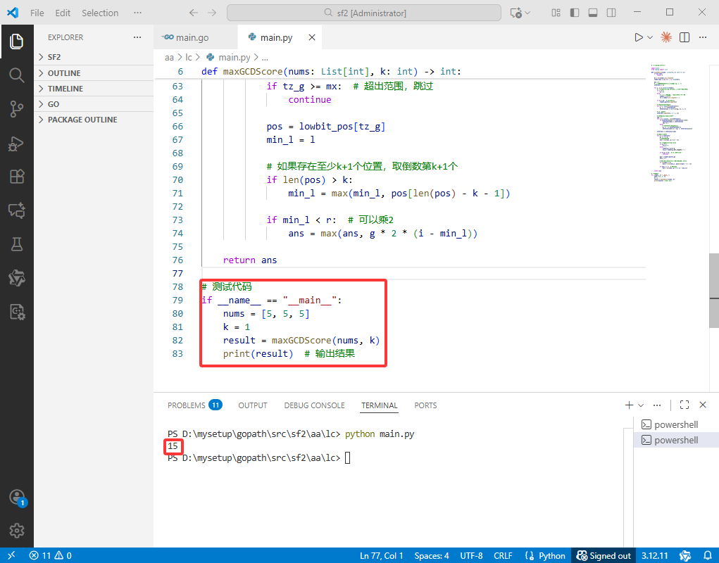

Python完整代码如下:
# -*-coding:utf-8-*-
import math
from typing import List
def maxGCDScore(nums: List[int], k: int) -> int:
    if not nums:
        return 0
    mx = max(nums).bit_length()
    lowbit_pos = [[] for _ in range(mx)]
    ans = 0
    # 使用列表存储区间,每个元素是(g, l, r)
    intervals = []
    for i, x in enumerate(nums):
        # 计算x的trailing zeros(二进制末尾0的个数)
        if x == 0:
            tz = 0
        else:
            # x & -x 得到最低位的1,然后计算位数
            lowbit = x & -x
            tz = lowbit.bit_length() - 1
        if tz < mx:  # 确保不越界
            lowbit_pos[tz].append(i)
        # 更新已有区间的gcd
        for j in range(len(intervals)):
            g, l, r = intervals[j]
            intervals[j] = (math.gcd(g, x), l, r)
        # 添加新区间
        intervals.append((x, i - 1, i))
        # 合并gcd相同的相邻区间
        idx = 1
        for j in range(1, len(intervals)):
            if intervals[j][0] != intervals[j-1][0]:
                intervals[idx] = intervals[j]
                idx += 1
            else:
                # 合并区间,更新右边界
                g, l, _ = intervals[idx-1]
                intervals[idx-1] = (g, l, intervals[j][2])
        intervals = intervals[:idx]
        # 处理每个区间
        for p in intervals:
            g, l, r = p
            # 不乘2的情况
            ans = max(ans, g * (i - l))
            # 计算g的trailing zeros
            if g == 0:
                tz_g = 0
            else:
                lowbit_g = g & -g
                tz_g = lowbit_g.bit_length() - 1
            if tz_g >= mx:  # 超出范围,跳过
                continue
            pos = lowbit_pos[tz_g]
            min_l = l
            # 如果存在至少k+1个位置,取倒数第k+1个
            if len(pos) > k:
                min_l = max(min_l, pos[len(pos) - k - 1])
            if min_l < r:  # 可以乘2
                ans = max(ans, g * 2 * (i - min_l))
    return ans
# 测试代码
if __name__ == "__main__":
    nums = [5, 5, 5]
    k = 1
    result = maxGCDScore(nums, k)
    print(result)  # 输出结果

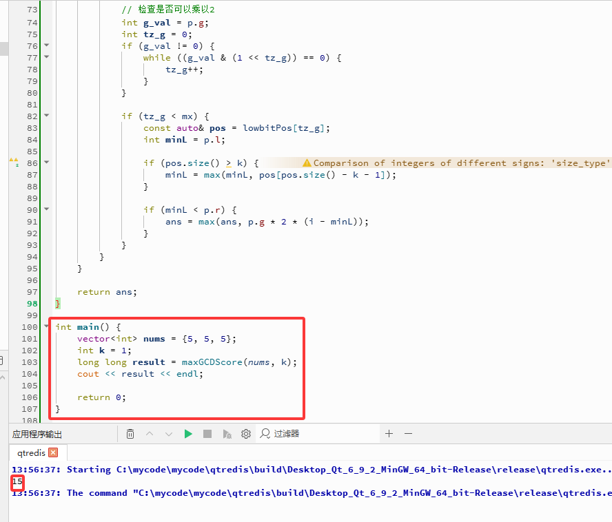

C++完整代码如下:
#include <iostream>
#include <vector>
#include <algorithm>
#include <numeric>
#include <bitset>
#include <cmath>
using namespace std;
int gcd(int a, int b) {
    while (a != 0) {
        int temp = a;
        a = b % a;
        b = temp;
    return b;
long long maxGCDScore(vector<int>& nums, int k) {
    if (nums.empty()) return 0;
    int max_val = *max_element(nums.begin(), nums.end());
    int mx = max_val == 0 ? 1 : (int)log2(max_val) + 2;
    vector<vector<int>> lowbitPos(mx);
    int ans = 0;
    struct Interval {
        int g, l, r;
    vector<Interval> intervals;
    for (int i = 0; i < nums.size(); i++) {
        int x = nums[i];
        // 计算尾随零的数量
        int tz = 0;
        if (x != 0) {
            while ((x & (1 << tz)) == 0) {
                tz++;
        if (tz < mx) {
            lowbitPos[tz].push_back(i);
        // 更新所有区间的GCD
        for (auto& p : intervals) {
            p.g = gcd(p.g, x);
        // 添加新区间
        intervals.push_back({x, i - 1, i});
        // 去重(合并GCD相同的区间)
        int idx = 1;
        for (int j = 1; j < intervals.size(); j++) {
            if (intervals[j].g != intervals[j-1].g) {
                intervals[idx] = intervals[j];
                idx++;
            } else {
                intervals[idx-1].r = intervals[j].r;
        intervals.resize(idx);
        // 处理每个区间
        for (const auto& p : intervals) {
            // 基本分数
            ans = max(ans, p.g * (i - p.l));
            // 检查是否可以乘以2
            int g_val = p.g;
            int tz_g = 0;
            if (g_val != 0) {
                while ((g_val & (1 << tz_g)) == 0) {
                    tz_g++;
            if (tz_g < mx) {
                const auto& pos = lowbitPos[tz_g];
                int minL = p.l;
                if (pos.size() > k) {
                    minL = max(minL, pos[pos.size() - k - 1]);
                if (minL < p.r) {
                    ans = max(ans, p.g * 2 * (i - minL));
    return ans;
int main() {
    vector<int> nums = {5, 5, 5};
    int k = 1;
    long long result = maxGCDScore(nums, k);
    cout << result << endl;
    return 0;
