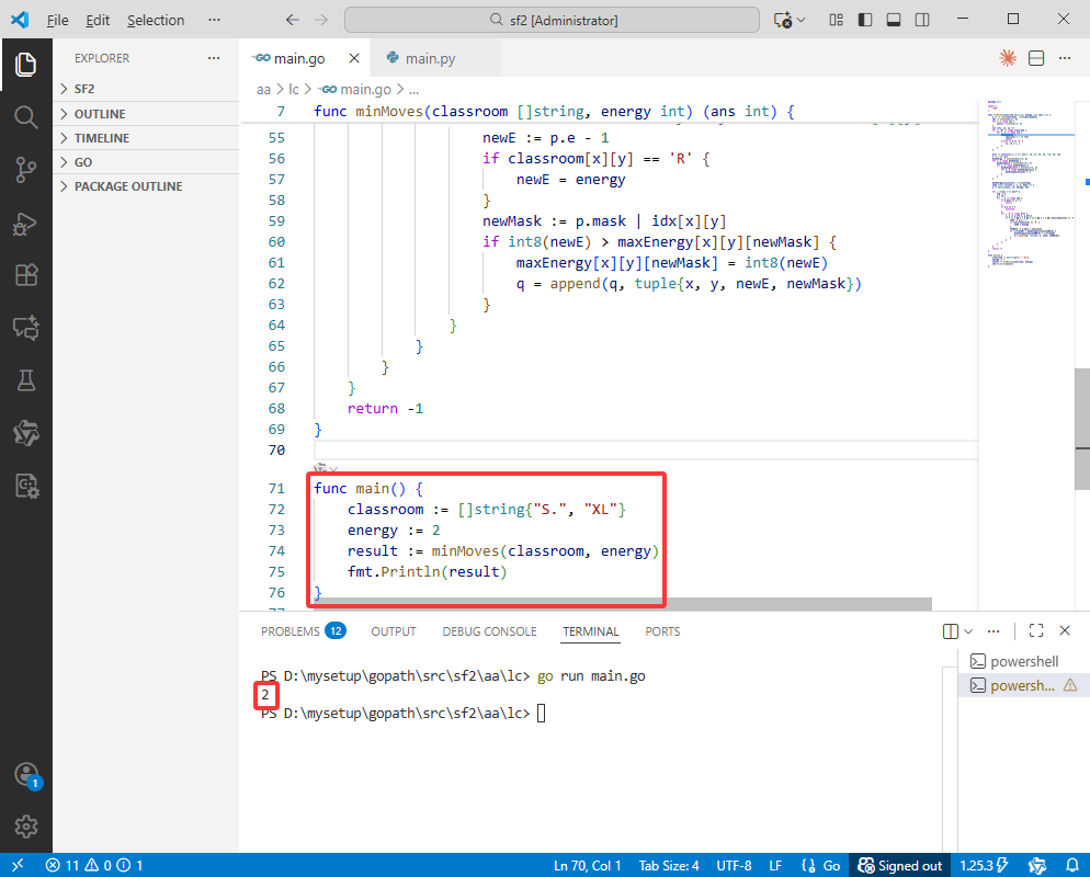

Go完整代码如下:
package main
import (
	"fmt"
func minMoves(classroom []string, energy int) (ans int) {
	m, n := len(classroom), len(classroom[0])
	idx := make([][]int, m)
	for i := range idx {
		idx[i] = make([]int, n)
	var cntL, sx, sy int
	for i, row := range classroom {
		for j, b := range row {
			if b == 'L' {
				idx[i][j] = 1 << cntL
				cntL++
			} else if b == 'S' {
				sx, sy = i, j
	dirs := []struct{ x, y int }{{-1, 0}, {1, 0}, {0, -1}, {0, 1}}
	u := 1 << cntL
	maxEnergy := make([][][]int8, m)
	for i := range maxEnergy {
		maxEnergy[i] = make([][]int8, n)
		for j := range maxEnergy[i] {
			maxEnergy[i][j] = make([]int8, u)
			for k := range maxEnergy[i][j] {
				maxEnergy[i][j][k] = -1
	maxEnergy[sx][sy][0] = int8(energy)
	type tuple struct{ x, y, e, mask int }
	q := []tuple{{sx, sy, energy, 0}}
	for ; len(q) > 0; ans++ {
		tmp := q
		q = nil
		for _, p := range tmp {
			if p.mask == u-1 {
				return
			if p.e == 0 {
				continue
			for _, d := range dirs {
				x, y := p.x+d.x, p.y+d.y
				if 0 <= x && x < m && 0 <= y && y < n && classroom[x][y] != 'X' {
					newE := p.e - 1
					if classroom[x][y] == 'R' {
						newE = energy
					newMask := p.mask | idx[x][y]
					if int8(newE) > maxEnergy[x][y][newMask] {
						maxEnergy[x][y][newMask] = int8(newE)
						q = append(q, tuple{x, y, newE, newMask})
	return -1
func main() {
	classroom := []string{"S.", "XL"}
	energy := 2
	result := minMoves(classroom, energy)
	fmt.Println(result)

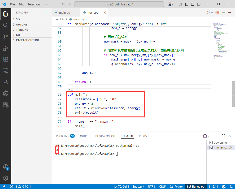

Python完整代码如下:
# -*-coding:utf-8-*-
from typing import List
from collections import deque
def minMoves(classroom: List[str], energy: int) -> int:
    m, n = len(classroom), len(classroom[0])
    idx = [[0] * n for _ in range(m)]
    cntL = 0
    sx, sy = 0, 0
    # 预处理地图,标记钥匙和起点
    for i in range(m):
        for j in range(n):
            if classroom[i][j] == 'L':
                cntL += 1
            elif classroom[i][j] == 'S':
                sx, sy = i, j
    # 方向数组
    dirs = [(-1, 0), (1, 0), (0, -1), (0, 1)]
    u = 1 << cntL  # 所有钥匙收集完成的状态
    # 三维数组,记录每个位置和状态下的最大能量值
    maxEnergy = [[[-1] * u for _ in range(n)] for _ in range(m)]
    maxEnergy[sx][sy][0] = energy
    # 使用队列进行BFS
    q = deque()
    q.append((sx, sy, energy, 0))
    ans = 0
    while q:
        # 按层遍历
        for _ in range(len(q)):
            x, y, e, mask = q.popleft()
            # 如果收集了所有钥匙,返回当前步数
            if mask == u - 1:
                return ans
            # 如果能量为0,无法移动
            if e == 0:
                continue
            # 尝试四个方向
            for dx, dy in dirs:
                nx, ny = x + dx, y + dy
                # 检查边界和障碍物
                if 0 <= nx < m and 0 <= ny < n and classroom[nx][ny] != 'X':
                    new_e = e - 1  # 默认消耗1点能量
                    # 如果是能量恢复点,恢复能量
                    if classroom[nx][ny] == 'R':
                        new_e = energy
                    # 更新钥匙状态
                    new_mask = mask | idx[nx][ny]
                    # 如果新状态的能量比之前记录的大,更新并加入队列
                    if new_e > maxEnergy[nx][ny][new_mask]:
                        maxEnergy[nx][ny][new_mask] = new_e
                        q.append((nx, ny, new_e, new_mask))
        ans += 1
    return -1
def main():
    classroom = ["S.", "XL"]
    energy = 2
    result = minMoves(classroom, energy)
    print(result)
if __name__ == "__main__":
    main()

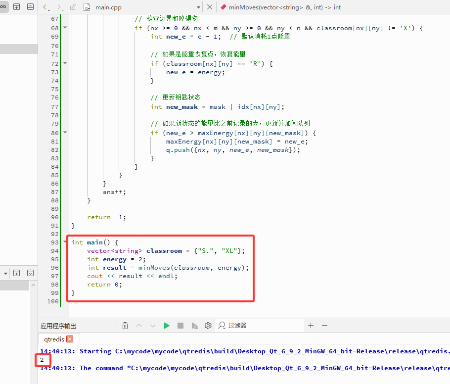

C++完整代码如下:
#include <iostream>
#include <vector>
#include <queue>
#include <tuple>
#include <cstring>
#include <cstdint>
using namespace std;
int minMoves(vector<string>& classroom, int energy) {
    int m = classroom.size(), n = classroom[0].size();
    vector<vector<int>> idx(m, vector<int>(n, 0));
    int cntL = 0, sx = 0, sy = 0;
    // 预处理地图,标记钥匙和起点
    for (int i = 0; i < m; i++) {
        for (int j = 0; j < n; j++) {
            if (classroom[i][j] == 'L') {
                idx[i][j] = 1 << cntL;
                cntL++;
            } else if (classroom[i][j] == 'S') {
                sx = i;
                sy = j;
    // 方向数组
    vector<pair<int, int>> dirs = {{-1, 0}, {1, 0}, {0, -1}, {0, 1}};
    int u = 1 << cntL;  // 所有钥匙收集完成的状态
    // 三维数组,记录每个位置和状态下的最大能量值
    vector<vector<vector<int8_t>>> maxEnergy(m,
                                             vector<vector<int8_t>>(n,
                                                                    vector<int8_t>(u, -1)));
    maxEnergy[sx][sy][0] = energy;
    // 使用队列进行BFS
    using Tuple = tuple<int, int, int, int>;
    queue<Tuple> q;
    q.push({sx, sy, energy, 0});
    int ans = 0;
    while (!q.empty()) {
        int size = q.size();
        // 按层遍历
        for (int i = 0; i < size; i++) {
            auto [x, y, e, mask] = q.front();
            q.pop();
            // 如果收集了所有钥匙,返回当前步数
            if (mask == u - 1) {
                return ans;
            // 如果能量为0,无法移动
            if (e == 0) {
                continue;
            // 尝试四个方向
            for (auto [dx, dy] : dirs) {
                int nx = x + dx;
                int ny = y + dy;
                // 检查边界和障碍物
                if (nx >= 0 && nx < m && ny >= 0 && ny < n && classroom[nx][ny] != 'X') {
                    int new_e = e - 1;  // 默认消耗1点能量
                    // 如果是能量恢复点,恢复能量
                    if (classroom[nx][ny] == 'R') {
                        new_e = energy;
                    // 更新钥匙状态
                    int new_mask = mask | idx[nx][ny];
                    // 如果新状态的能量比之前记录的大,更新并加入队列
                    if (new_e > maxEnergy[nx][ny][new_mask]) {
                        maxEnergy[nx][ny][new_mask] = new_e;
                        q.push({nx, ny, new_e, new_mask});
        ans++;
    return -1;
int main() {
    vector<string> classroom = {"S.", "XL"};
    int energy = 2;
    int result = minMoves(classroom, energy);
    cout << result << endl;
    return 0;
