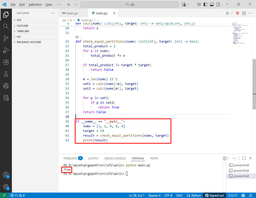

Python完整代码如下:
# -*-coding:utf-8-*-
import math
from typing import List, Set, Tuple
def calc(nums: List[int], target: int) -> Set[Tuple[int, int]]:
    s = set()
    def dfs(i: int, a: int, b: int):
        if a > target or b > target:
            return
        if i == len(nums):
            g = math.gcd(a, b)
            s.add((a // g, b // g))  # 最简分数
            return
        dfs(i + 1, a * nums[i], b)
        dfs(i + 1, a, b * nums[i])
    dfs(0, 1, 1)
    return s
def check_equal_partitions(nums: List[int], target: int) -> bool:
    total_product = 1
    for x in nums:
        total_product *= x
    if total_product != target * target:
        return False
    m = len(nums) // 2
    set1 = calc(nums[:m], target)
    set2 = calc(nums[m:], target)
    for p in set1:
        if p in set2:
            return True
    return False
if __name__ == "__main__":
    nums = [3, 1, 6, 8, 4]
    target = 24
    result = check_equal_partitions(nums, target)
    print(result)

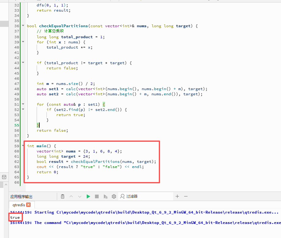

C++完整代码如下:
#include <iostream>
#include <vector>
#include <set>
#include <functional>
#include <numeric>
using namespace std;
int gcd(int a, int b) {
    while (a != 0) {
        int temp = a;
        a = b % a;
        b = temp;
    return b;
set<pair<int, int>> calc(const vector<int>& nums, int target) {
    set<pair<int, int>> result;
    function<void(int, int, int)> dfs = [&](int i, int a, int b) {
        if (a > target || b > target) return;
        if (i == nums.size()) {
            int g = gcd(a, b);
            result.insert({a / g, b / g}); // 最简分数
            return;
        dfs(i + 1, a * nums[i], b);
        dfs(i + 1, a, b * nums[i]);
    dfs(0, 1, 1);
    return result;
bool checkEqualPartitions(const vector<int>& nums, long long target) {
    // 计算总乘积
    long long total_product = 1;
    for (int x : nums) {
        total_product *= x;
    if (total_product != target * target) {
        return false;
    int m = nums.size() / 2;
    auto set1 = calc(vector<int>(nums.begin(), nums.begin() + m), target);
    auto set2 = calc(vector<int>(nums.begin() + m, nums.end()), target);
    for (const auto& p : set1) {
        if (set2.find(p) != set2.end()) {
            return true;
    return false;
int main() {
    vector<int> nums = {3, 1, 6, 8, 4};
    long long target = 24;
    bool result = checkEqualPartitions(nums, target);
    cout << (result ? "true" : "false") << endl;
    return 0;
