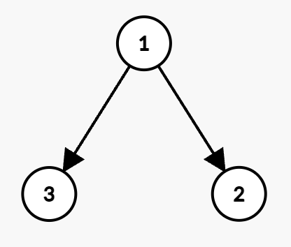

输入: n = 3, present = [4,6,8], future = [7,9,11], hierarchy = [[1,2],[1,3]], budget = 10。
输出: 10。
解释:
员工 1 以价格 4 购买股票,获得利润 7 - 4 = 3。
员工 3 可获得折扣价 floor(8 / 2) = 4,获得利润 11 - 4 = 7。
员工 1 和员工 3 的总购买成本为 4 + 4 = 8 <= budget,因此最大总利润为 3 + 7 = 10。

  1. 构建员工树结构
    • 根据输入的hierarchy(直接汇报关系),构建一个树形结构的邻接表g。每个节点代表一名员工,编号从0开始(对应原始编号1到n),其中节点0是CEO(根节点)。每个节点x的邻接表g[x]存储其所有直接下属(子节点)的编号。由于输入保证无环且员工1是所有员工的直接或间接上司,因此构建的树是以0为根的有根树。

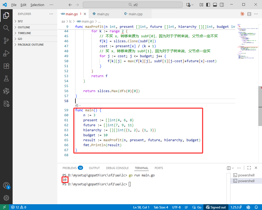

Go完整代码如下:
package main

	return slices.Max(dfs(0)[0])
func main() {
	n := 3
	present := []int{4, 6, 8}
	future := []int{7, 9, 11}
	hierarchy := [][]int{{1, 2}, {1, 3}}
	budget := 10
	result := maxProfit(n, present, future, hierarchy, budget)
	fmt.Println(result)

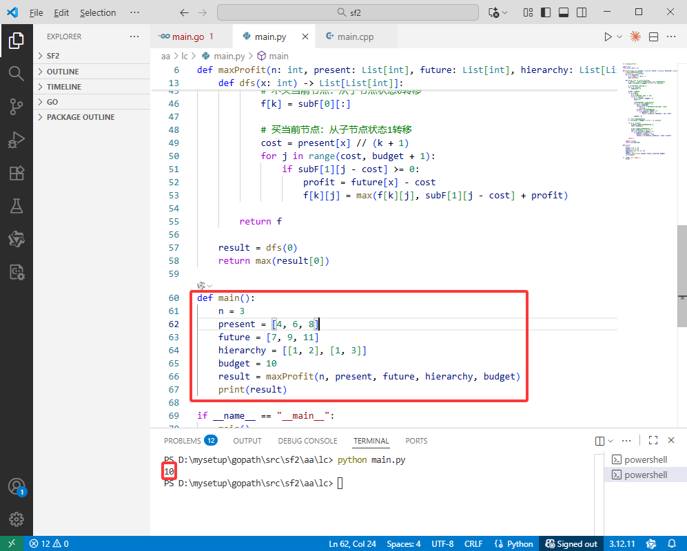

Python完整代码如下:
# -*-coding:utf-8-*-
import math
from typing import List
def maxProfit(n: int, present: List[int], future: List[int], hierarchy: List[List[int]], budget: int) -> int:
    # 构建邻接表表示的树结构
    g = [[] for _ in range(n)]
    for e in hierarchy:
        x, y = e[0] - 1, e[1] - 1
        g[x].append(y)
    def dfs(x: int) -> List[List[int]]:
        # subF[0] 和 subF[1] 分别表示不买和买当前节点时的状态
        subF = [[-10**9] * (budget + 1) for _ in range(2)]
        # 初始化:预算为0时利润为0
        for i in range(2):
            subF[i][0] = 0
        # 遍历所有子节点
        for y in g[x]:
            fy = dfs(y)
            # 对每个状态(0: 不买, 1: 买)
            for k in range(2):
                nf = [-10**9] * (budget + 1)
                nf[0] = 0
                # 遍历子节点的所有可能预算分配
                for jy in range(budget + 1):
                    resY = fy[k][jy]
                    if resY < 0:  # 重要优化:利润为负,一定不选
                        continue
                    # 更新当前预算下的最大利润
                    for j in range(jy, budget + 1):
                        if subF[k][j - jy] >= 0:
                            nf[j] = max(nf[j], subF[k][j - jy] + resY)
                subF[k] = nf
        # 计算当前节点的最终状态
        f = [[-10**9] * (budget + 1) for _ in range(2)]
        for k in range(2):
            # 不买当前节点:从子节点状态0转移
            f[k] = subF[0][:]
            # 买当前节点:从子节点状态1转移
            cost = present[x] // (k + 1)
            for j in range(cost, budget + 1):
                if subF[1][j - cost] >= 0:
                    profit = future[x] - cost
                    f[k][j] = max(f[k][j], subF[1][j - cost] + profit)
        return f
    result = dfs(0)
    return max(result[0])
def main():
    n = 3
    present = [4, 6, 8]
    future = [7, 9, 11]
    hierarchy = [[1, 2], [1, 3]]
    budget = 10
    result = maxProfit(n, present, future, hierarchy, budget)
    print(result)
if __name__ == "__main__":
    main()

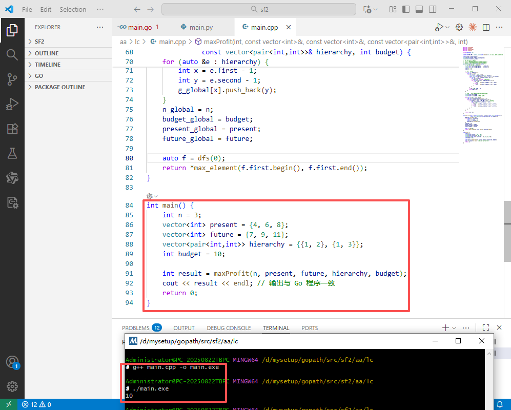

C++完整代码如下:
#include <iostream>
#include <vector>
#include <algorithm>
#include <limits>
using namespace std;
const int NEG_INF = numeric_limits<int>::min() / 2; // 相当于 math.MinInt / 2
int n_global, budget_global;
vector<int> present_global, future_global;
vector<vector<int>> g_global;
// DFS 返回两个 dp 数组:
// first = 父节点不买的情况下本节点子树的最优值
// second = 父节点买的情况下本节点子树的最优值
pair<vector<int>, vector<int>> dfs(int x) {
    // 初始化 subF[0] 和 subF[1]
    vector<int> subF0(budget_global + 1, NEG_INF);
    vector<int> subF1(budget_global + 1, NEG_INF);
    subF0[0] = 0;
    subF1[0] = 0;
    // 遍历所有孩子
    for (int y : g_global[x]) {
        auto fy = dfs(y);
        for (int k = 0; k <= 1; k++) {
            vector<int> nf(budget_global + 1, NEG_INF);
            const vector<int>& fyk = (k == 0 ? fy.first : fy.second);
            for (int jy = 0; jy <= budget_global; jy++) {
                int resY = fyk[jy];
                if (resY < 0) continue; // 负值不选
                for (int j = jy; j <= budget_global; j++) {
                    if (k == 0) {
                        nf[j] = max(nf[j], subF0[j - jy] + resY);
                    } else {
                        nf[j] = max(nf[j], subF1[j - jy] + resY);
            if (k == 0) subF0 = nf;
            else subF1 = nf;
    // f[0] 和 f[1] 分别对应 dfs 返回的两个向量
    vector<int> f0 = subF0;
    vector<int> f1 = subF0; // 克隆 subF0
        int cost = present_global[x] / (k + 1);
        for (int j = cost; j <= budget_global; j++) {
            if (subF1[j - cost] > NEG_INF / 2) { // 有效状态
                int profit = future_global[x] - cost;
                if (k == 0) {
                    f0[j] = max(f0[j], subF1[j - cost] + profit);
                } else {
                    f1[j] = max(f1[j], subF1[j - cost] + profit);
    return {f0, f1};
int maxProfit(int n, const vector<int>& present, const vector<int>& future,
              const vector<pair<int,int>>& hierarchy, int budget) {
    g_global.assign(n, {});
    for (auto &e : hierarchy) {
        int x = e.first - 1;
        int y = e.second - 1;
        g_global[x].push_back(y);
    n_global = n;
    budget_global = budget;
    present_global = present;
    future_global = future;
    auto f = dfs(0);
    return *max_element(f.first.begin(), f.first.end());
int main() {
    int n = 3;
    vector<int> present = {4, 6, 8};
    vector<int> future = {7, 9, 11};
    vector<pair<int,int>> hierarchy = {{1, 2}, {1, 3}};
    int budget = 10;
    int result = maxProfit(n, present, future, hierarchy, budget);
    cout << result << endl; // 输出与 Go 程序一致
    return 0;
